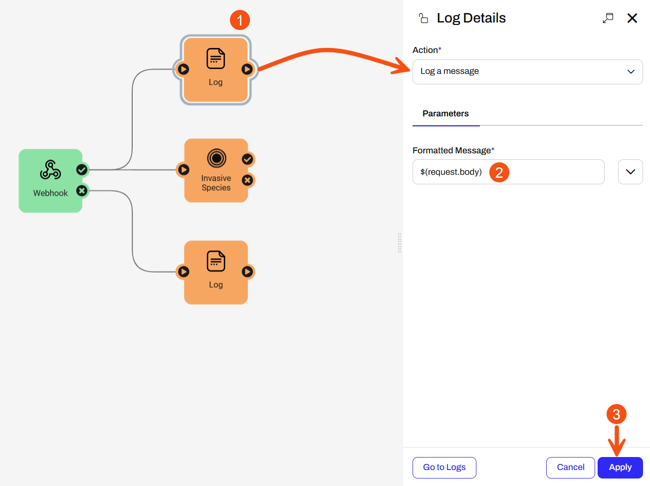

With the Survey123 webhook modified, let’s take a look at the new payload in FME Flow by logging the entire webhook message content.

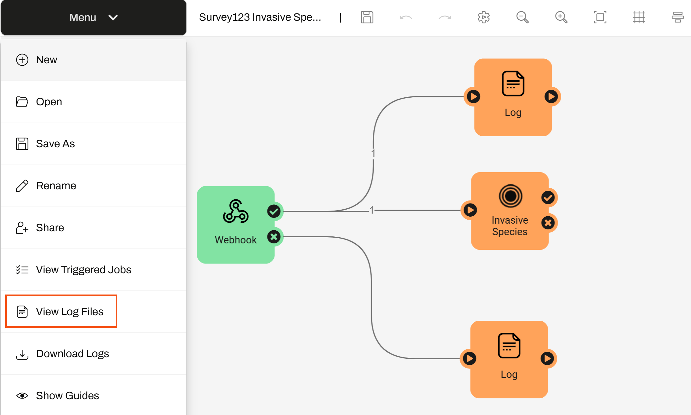

In a new browser tab, open FME Flow and log in. Open the Invasive Species Automation that was completed as part of the article Push Data from ArcGIS Survey123 to an Application in Real-time with Webhooks. If the Automation is running, stop it.
Connect a log action to the Webhook trigger success port. For the Formatted Message, from the drop-down menu, choose Webhook > Message Content. Click Apply.
Start the Automation.
5. Submit a Test Invasive Species Survey in Survey123

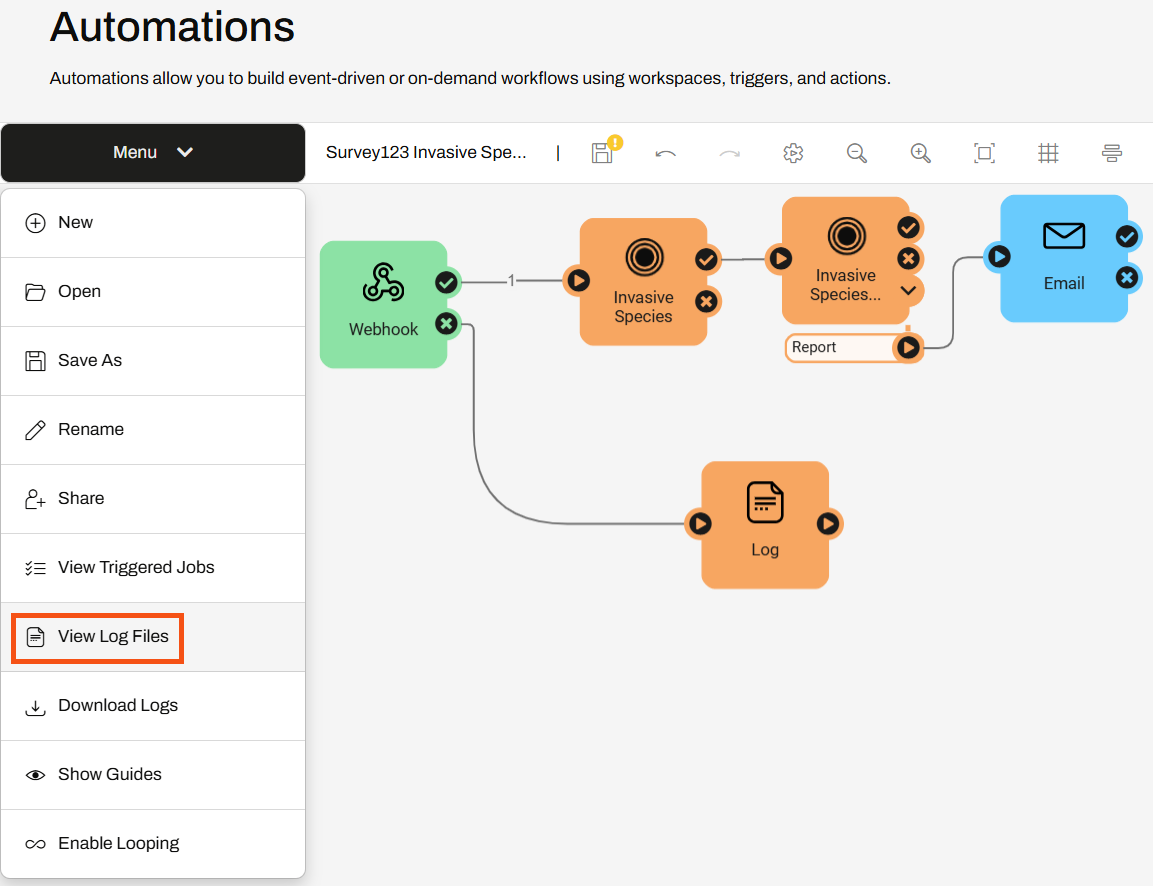

Back in Survey123, submit a test Invasive Species survey. The test survey will trigger the webhook. View the Automation Log File in FME Flow.
In the action_fmelogaction.log, the webhook message now contains a surveyInfo key with the information we need to create a report from the response data.

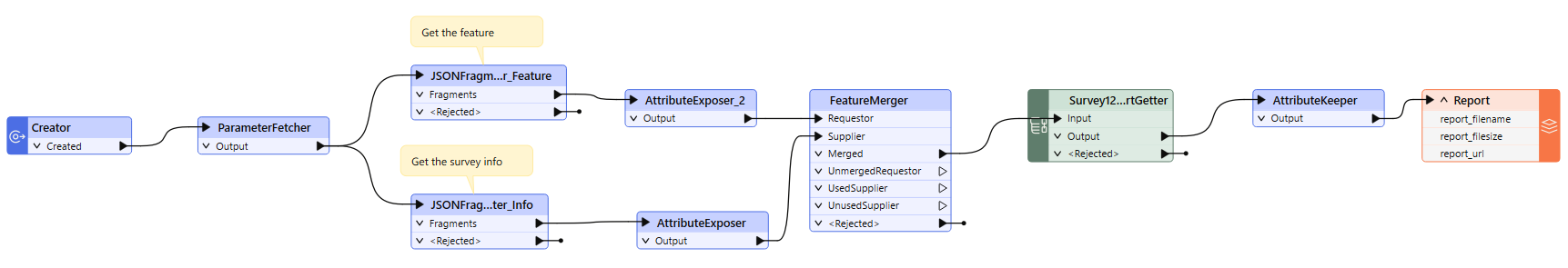

Download the InvasiveSpeciesReport.fmw workspace from the Files section of this article and open it in FME Workbench. The workspace has one parameter: webhook_message. It takes the webhook_message JSON, extracts the attributes needed to create the report from the JSON, and uses a custom transformer, the Survey123ReportGetter, to run and get a link to the report. The link is passed back to the FME Flow Automation using an FME Flow Automations Writer at the end.

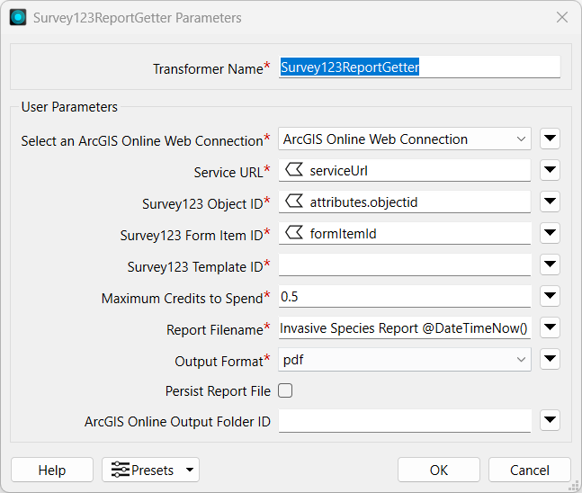

2. Configure the Survey123ReportGetter Transformer
Open the Survey123ReportGetter parameters and set them as follows:
- Select an ArcGIS Online Web Connection: You should have already created a connection to complete the article Push Data from ArcGIS Survey123 to an Application in Real-time with Webhooks. If not, please follow How to Create an ArcGIS Online Web Connection (OAuth 2.0) to create a connection.
- Service URL: Previously Exposed JSON attributes
- Survey123 Object ID: Previously Exposed JSON attributes
- Survey123 Form Item ID: Previously Exposed JSON attributes
- Survey123 Template ID: Copy the ID from the template item’s URL in ArcGIS Online
- Maximum Credits to Spend: single-record reports use 0.5 credits, although this is subject to change by ESRI at any time. Leave the value as 0.5
- Report Filename: enter a filename for the report. You can use the text editor to access FME Functions. In this example, we’ll append the current datetime to the end of the report filename using the @DateTimeNow() function
- Output format: pdf
- Persist Report File: for this example, we'll leave it unchecked. This will produce a temporary link valid only for 5 minutes. When the report is persisted in ArcGIS Online, the user will need to login to access the file. Another option is to modify this workflow to save the resulting report file to your own public file hosting service and email that URL.
- ArcGIS Online Output Folder ID: this can be left blank since the report file is not being persisted in ArcGIS Online.
Click OK.

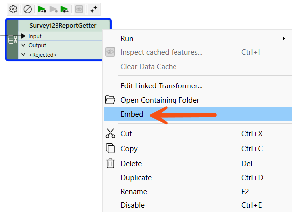

Before publishing, let’s embed the Survey123ReportGetter, since it is a custom transformer. To learn more about working with custom transformers in FME Flow, please read Custom Transformers and FME Flow.
Right-click on the Survey123ReportGetter and choose Embed.
The transformer will turn green, indicating that it has been embedded.

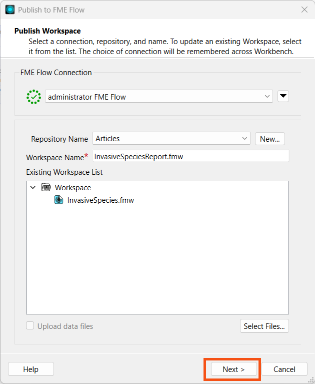

In FME Workbench, click Publish to connect to your FME Flow. In the publish wizard, choose a repository to upload the workspace to (or create a new repository) and click Next.

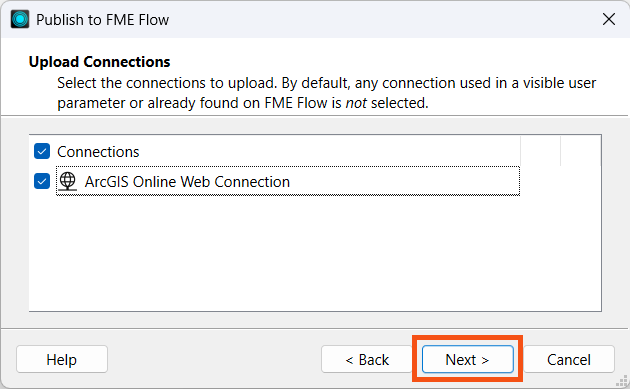

You should have already published an ArcGIS Online Web Connection in the article Push Data from ArcGIS Survey123 to an Application in Real-time with Webhooks. If not, click the checkbox beside the connection to publish it to FME Flow. Click Next.

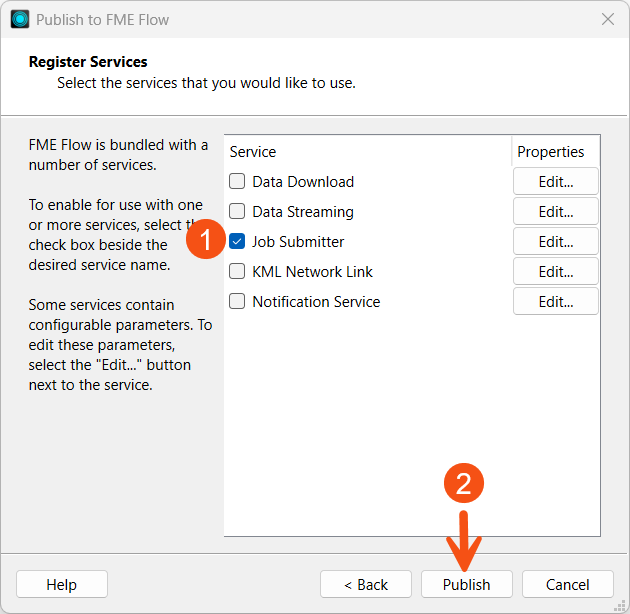

Finally, register the workspace with the Job Submitter service and click Publish.
Check the Translation Log to make sure everything was published to FME Flow successfully.

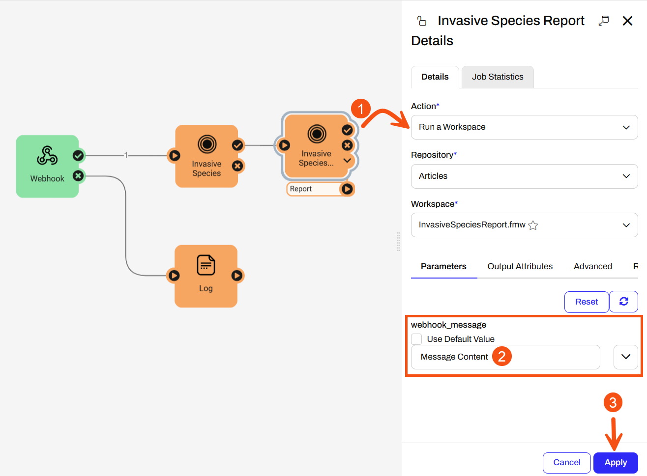

1. Add the InvasiveSpeciesReport.fmw Workspace to the Automation
Open the Invasive Species Automation. Delete the Log action created in Part 1 that is connected to the Webhook trigger success port. Add a new action to the canvas and connect it to the InvasiveSpecies workspace action.
Configure the new action to run a workspace. Choose the InvasiveSpeciesReport.fmw that was published in Part 2. For the webhook_message parameter, click the drop-drop and choose Webhook > Message Content. Click Apply.

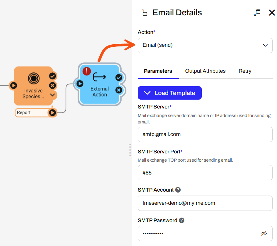

2. Add an Email Action to the Automation
Since the InvasiveSpeciesReport.fmw workspace contains an FME Flow Automation Writer, there is a “Report” output port available below the action. The port outputs a feature with the report URL that we can pass to an external email action.

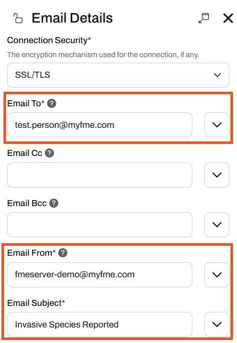

Add an external action to the canvas and connect it to the Report port. Choose Email (send) as the Action and configure the SMTP settings for your outgoing email. In this example, we’ve loaded a Gmail template and entered the SMTP Account and Password.
Enter your email address in Email To and the SMTP Account Email in Email From. For the Email Subject, enter “Invasive Species Reported”.

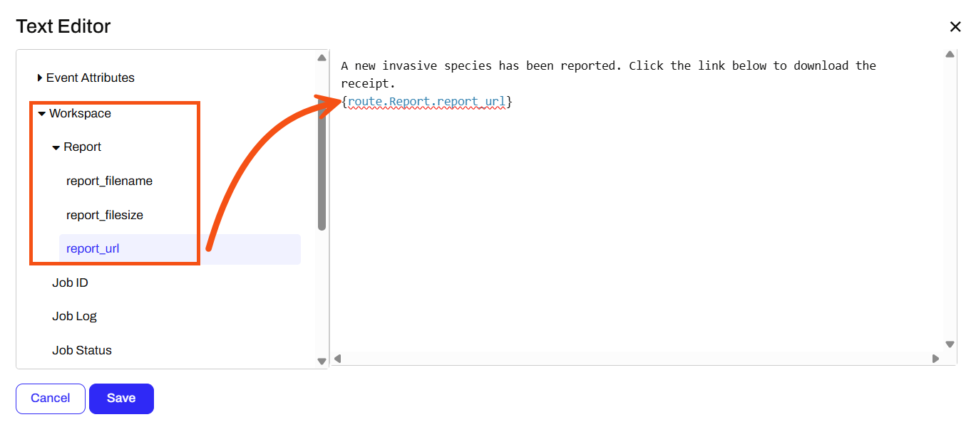

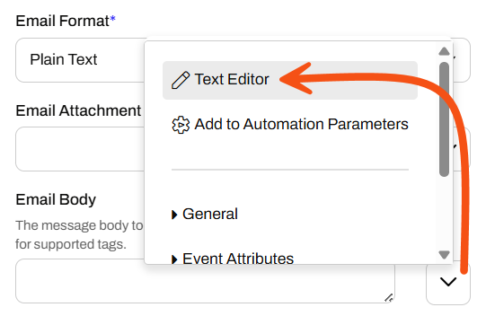

For the Email Body, open the Text Editor.
In the Text Editor, enter some body text for the receiver and then add the report_url. The report_url can be accessed by expanding Workspace > Report. Click OK.
Click Validate, confirm the email action configuration is valid, and then click Apply to save the changes.

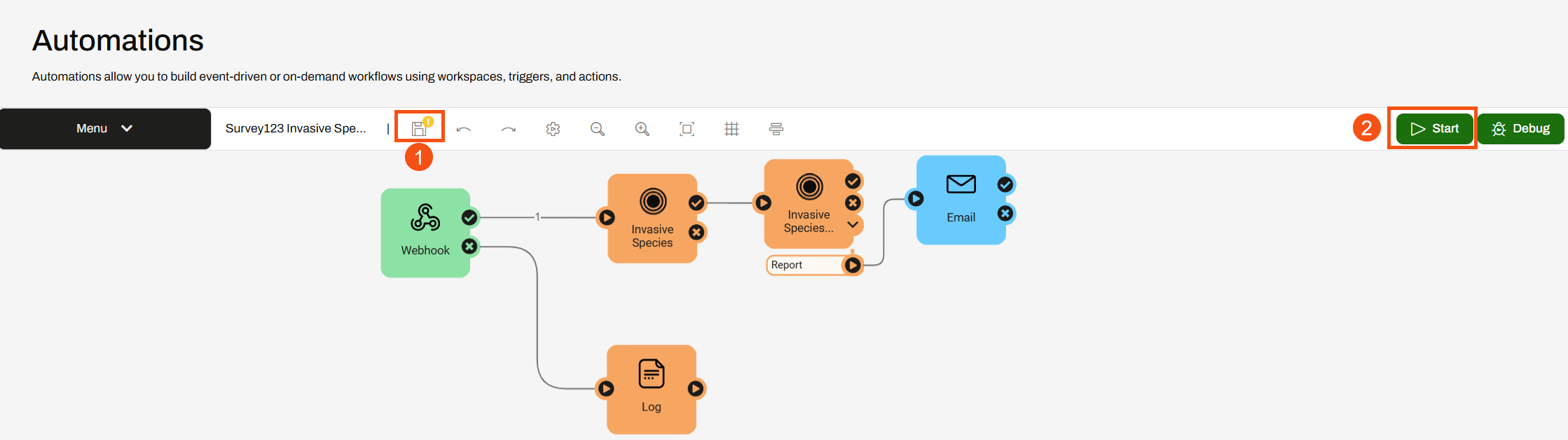

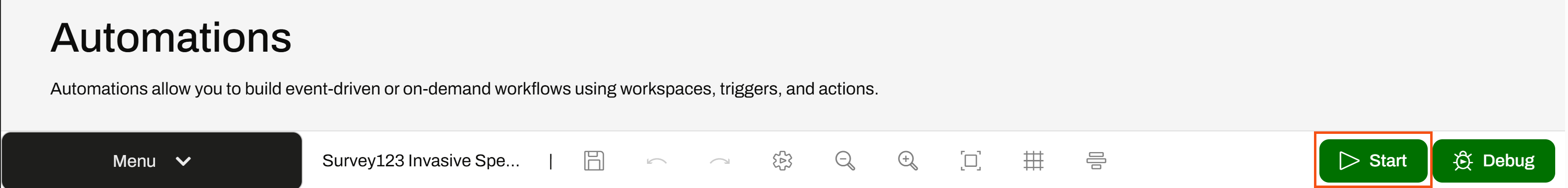

Save the Automation and click Start.
With the Automation running, submit another test Invasive Species survey in Survey123. Wait a couple of minutes, and then check your email. You should see an email containing a link to a report.
Click the link in the email to view the report. Below is a sample.
If you do not receive an email, check the Automation Log File for any errors.
