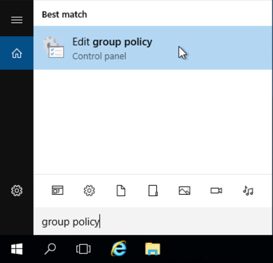

Step 1: Open the Group Policy Editor
From the Start menu click on the magnifying glass icon to search windows and type ‘Group Policy’. Select the Edit group policy option.

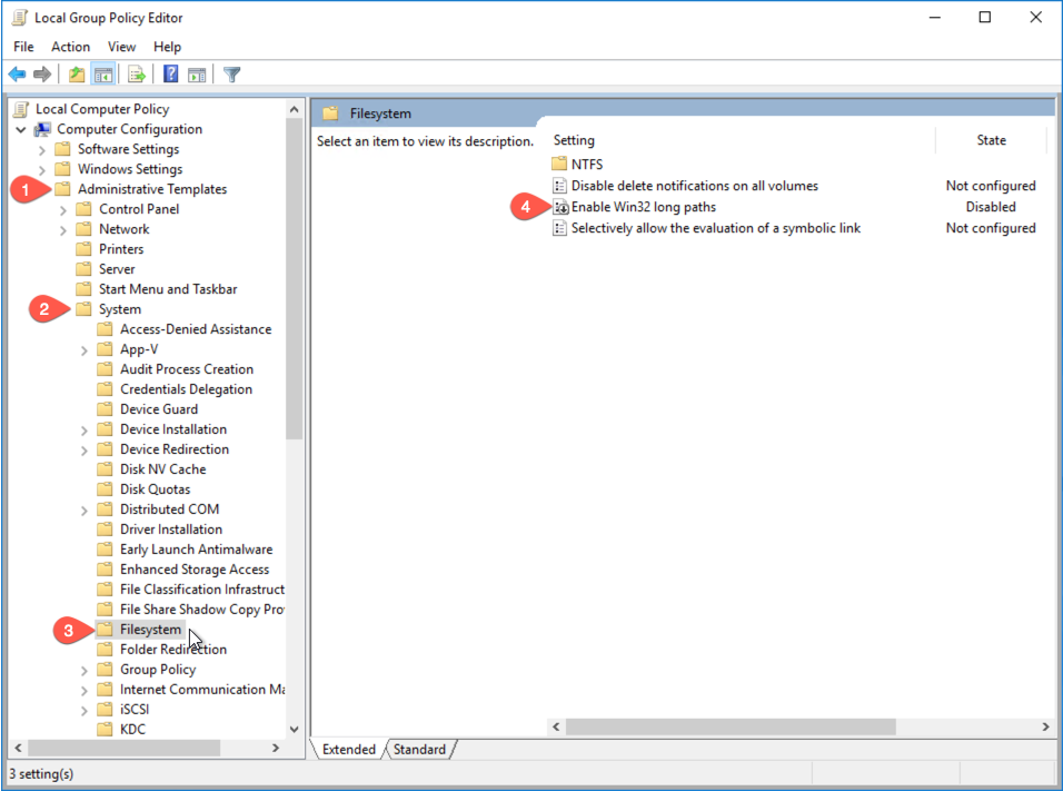

Step 2: Open the FileSystem folder
In the panel on the left-hand side under Computer Configuration select Administrative Templates > System > Filesystem. Within the Filesystem folder under Settings on the right-hand side select ‘Enable Win32 long paths’ to open an additional dialog window.

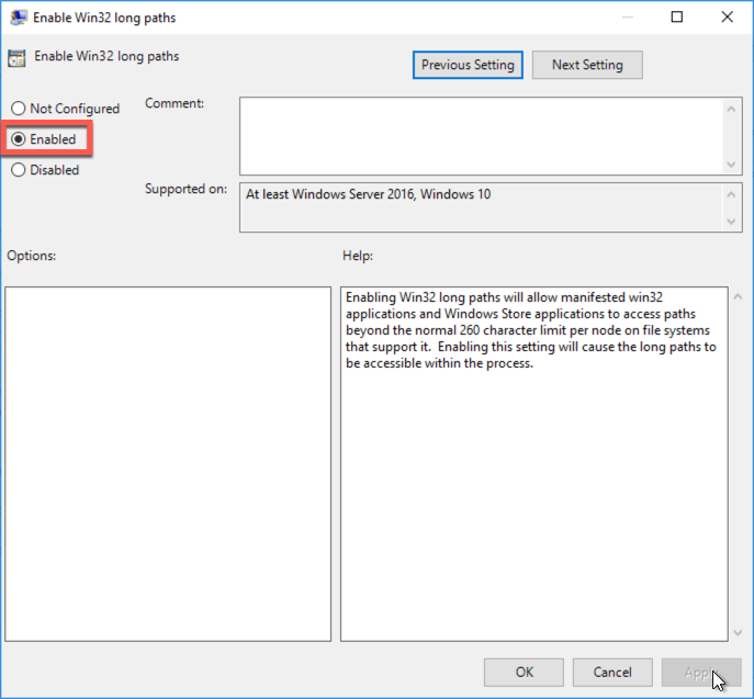

Step 3: Enable Long Paths
In the top left change the checkbox from Disabled to Enable, click Apply and then OK. You should see the State of this Setting under the Filesystem has been updated to reflect this change.

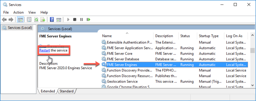

Step 4: Restart FME Server Engine Service
Note: This step is only applicable if you are enabling for use with FME Server.
From Windows Search bar find ‘Services’ and restart the FME Server Engine Service.
