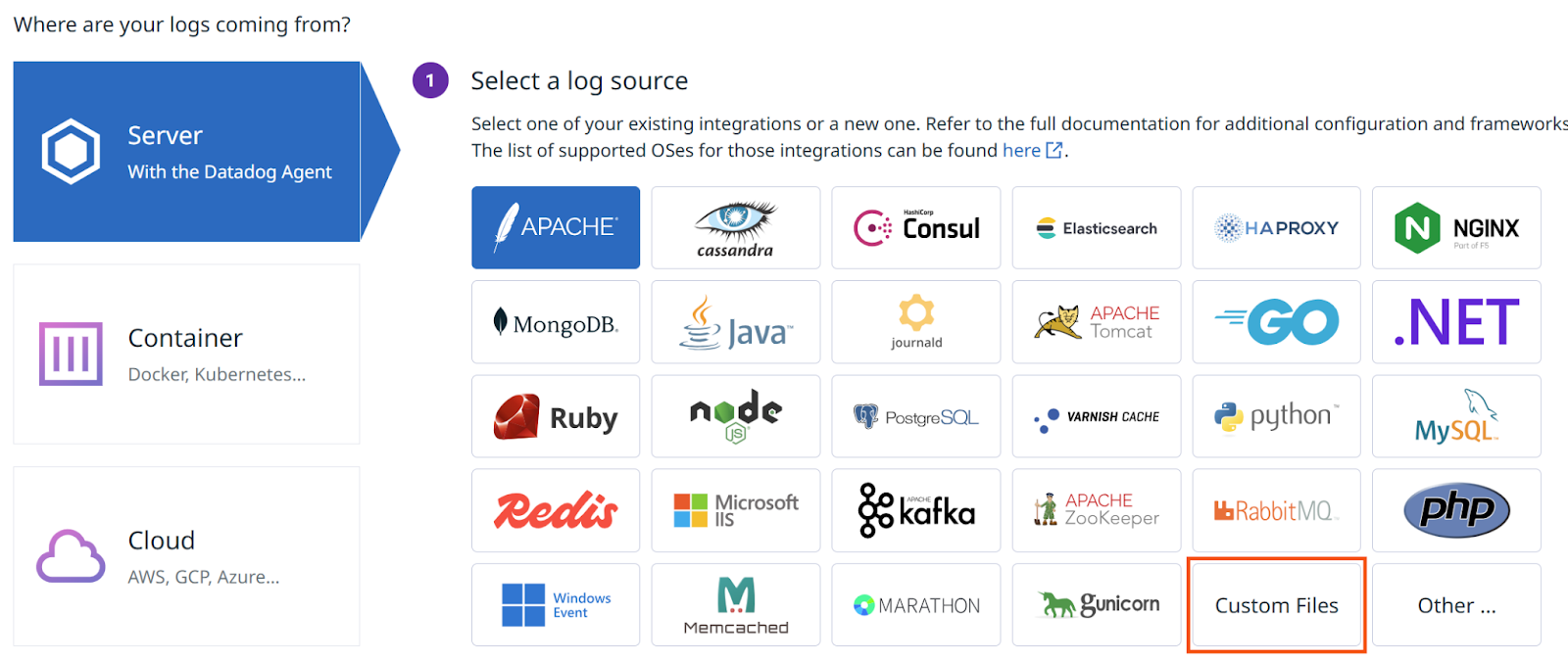

Now the Agent is set up and ready to send logs to Datadog. The next step is to configure the FME Flow log files you wish to send back. Start by navigating to Logs -> Log Configuration -> Add a Log Source in the Datadog UI. Select Server, then Custom Files.
Based on your input, the UI will walk you through what changes to make to your Agent’s directory. For example, to generate the necessary YAML for tailing the fmeserver.log, fill in these values:
  • Path: C:/ProgramData/Safe Software/FMEFlow/resources/logs/core/current/fmeserver.log
  • Service: fmeserverlog
  • Source: fmeserver
As the UI states, you will create a new folder in the Agent’s conf.d directory called fmeserver.d. In this folder, create a new conf.yaml file, copy/paste the generated YAML from the Datadog UI, and save the file. The final path to this new file will be: C:\ProgramData\Datadog\conf.d\fmeserver.d\conf.yaml.

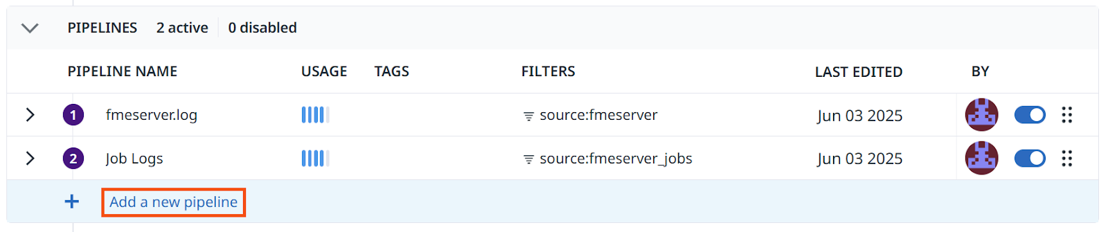

Navigate to Logs -> Log Configuration -> Pipelines and select Add a new pipeline. Each pipeline will contain processors that remap our attributes.

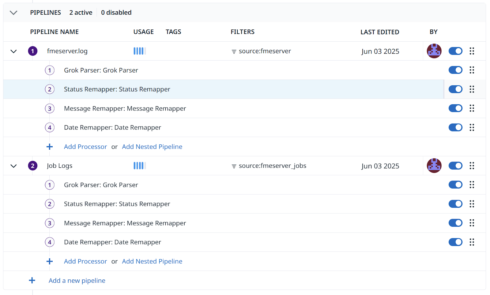

Your two pipelines should look like this when you are done:

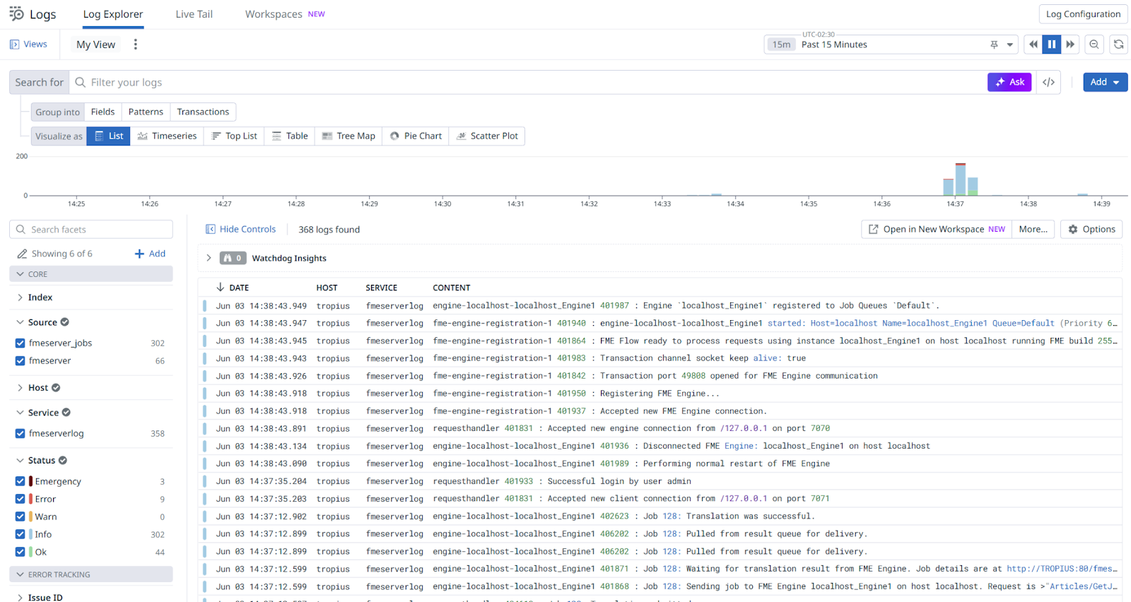

At this point, our log files should be visible within the Datadog UI. Navigate to Logs -> Search & Analytics -> Explorer. In a new tab, log in to FME Flow and run a workspace. After some time, we should start to see records from both the server log and the associated job log.
We can filter our logs from here by different attributes (time, status, source, etc.). This general template can be applied to tail additional logs from FME Flow and forward them into Datadog.
