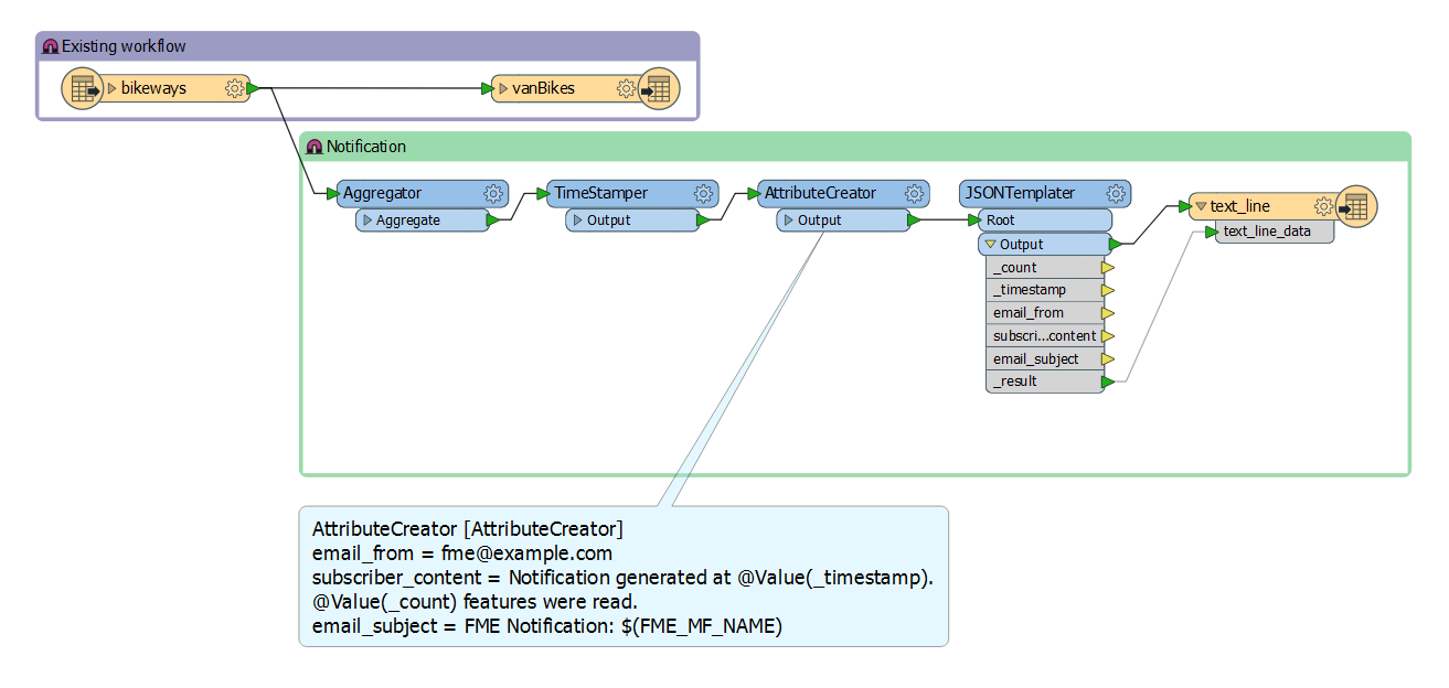

1) Add a new Text File writer named "notifier" to the canvas, and connect it to the JSONTemplater transformer.
2) Expand the attributes for the Text File writer, and connect the "_result" attribute from the JSONTemplater to "text_line_data" attribute on the writer. Here is the completed workspace:

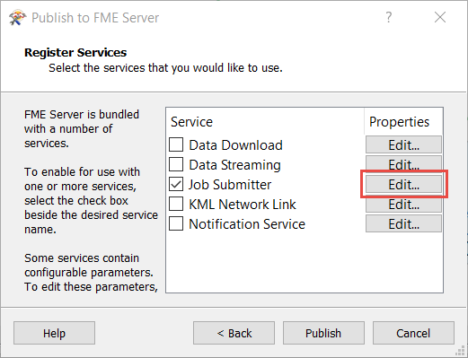

3) Publish the workspace to FME Server. When you get to the Register Services dialog, select the "Edit" button to open the Job Submitter service properties.

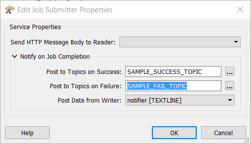

4) Set the Job Submitter service properties as below:

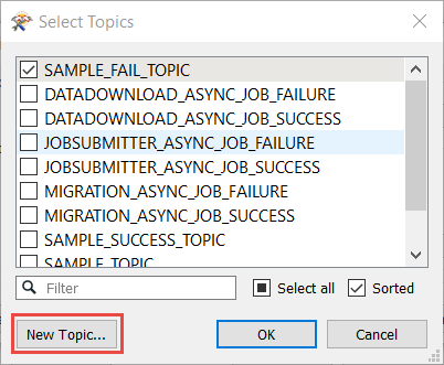

5) If the Post to Topics don't exist, you can create them right in the publication wizard:
6) Configure an email subscriber which is subscribed to SAMPLE_SUCCESS_TOPIC.
7) Configure an email subscriber which is subscribed to SAMPLE_FAIL_TOPIC.
8) Run the newly published workspace and check for a notification sent to the SAMPLE_SUCCESS_TOPIC when the job completes successfully.
9) Test for fail conditions by providing an invalid dataset, which will generate a failure notification sent to SAMPLE_FAIL_TOPIC.
