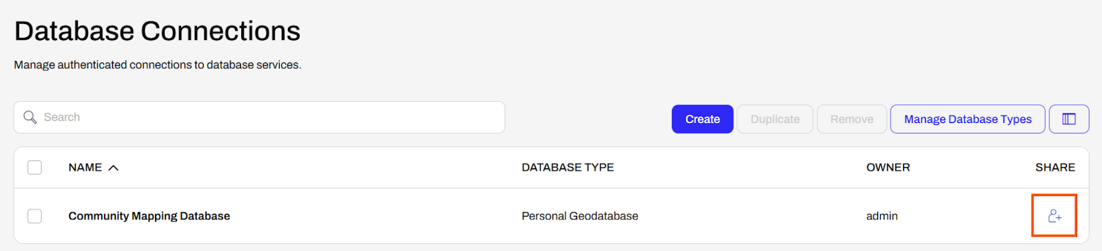

1. Users have permission to create connections
NOTE: If a user has permission to create connections, that user can also overwrite shared connections. Any workflows on FME Flow (belonging to any user) that contain that connection will be affected.
  • Users can create their own database connections.
  • Each user will be responsible for managing their own connections; this may lead to many connections for a single database.
  • Users can choose to share their connections with others in FME Flow.
  • Users must be careful when publishing workspaces that include a database connection with the same name as a previously shared connection. This may affect other workspaces using that database connection.
Image of the database connection page in FME Flow.

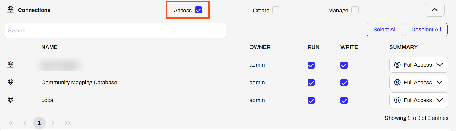

2. Users do not have permission to create connections (preferred)
As an FME Flow Administrator...
  • You would have to create each connection in FME Flow (or upload them from FME Form).
  • Access can be granted to any role or specific user account in FME Flow. Users will not have access unless they have been granted permissions to that connection through their account or role.
  • You may choose to give users access to the Connections page. This will grant users access to the Connections page, where they can view all database connections they have access to.
Image of the user management page in FME Flow
  • Ensure that all users that have workspaces with database connections create a user parameter with the connection. Then, the user can select the database connection as a user parameter in the run workspace page.
