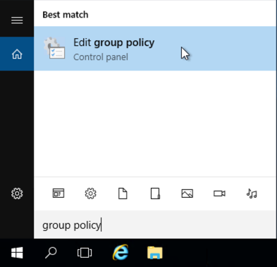

1. Open the Windows search bar and type Group Policy. Select Edit group policy.

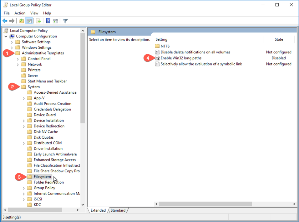

2. Navigate to: Computer Configuration > Administrative Templates > System > Filesystem and double click on Enable Win32 long paths

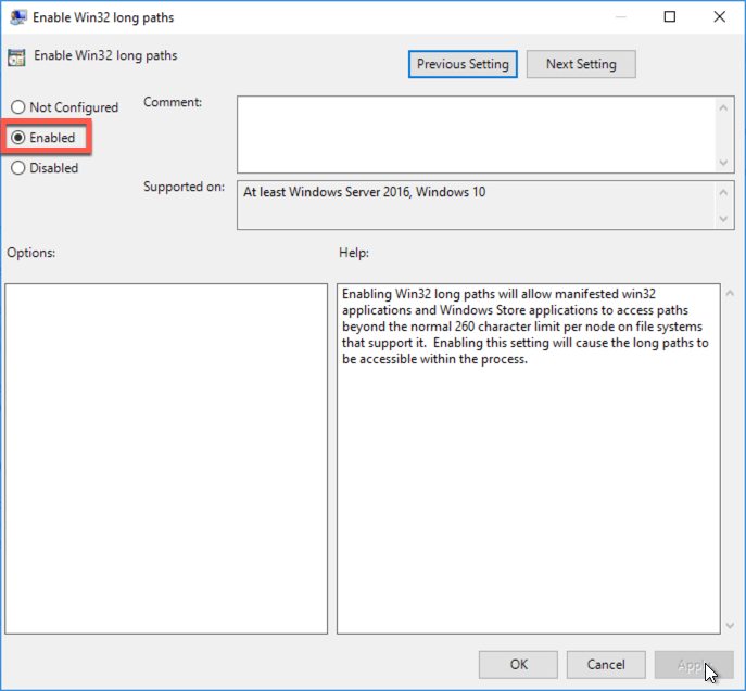

3. Set the option to Enabled. Click Apply and then OK.
4. Restart the FME Flow Engine service
This allows Windows to support significantly longer file paths and prevents failures during ZIP extraction.
