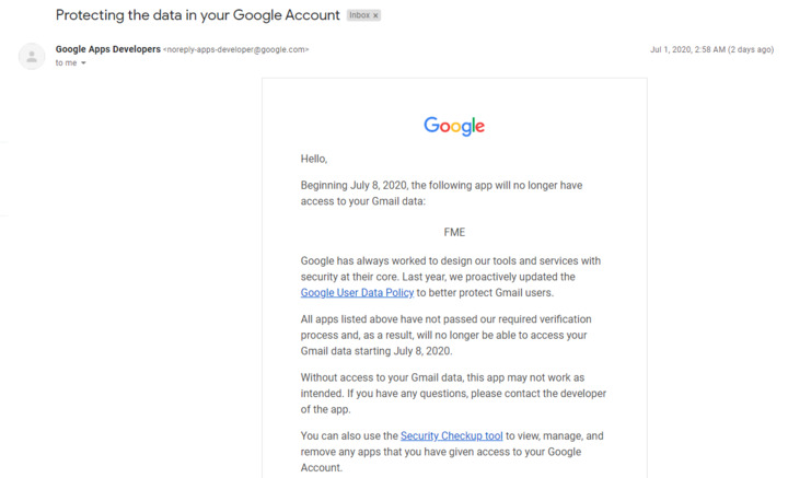

You have a Gmail Web Connection under the Google Gmail (safe.emailer) web service provided with the Emailer package. The email address assigned to this web connection has received an email from Google App developers that FME does not pass the Google verification process and access will be blocked.

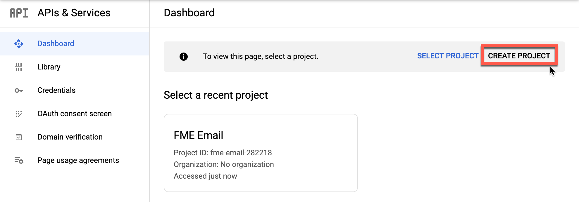

1. Visit Google API Console
2. Create a new project

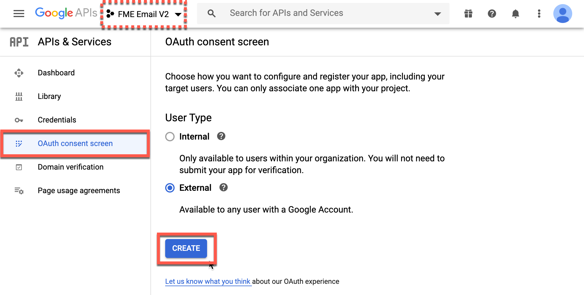

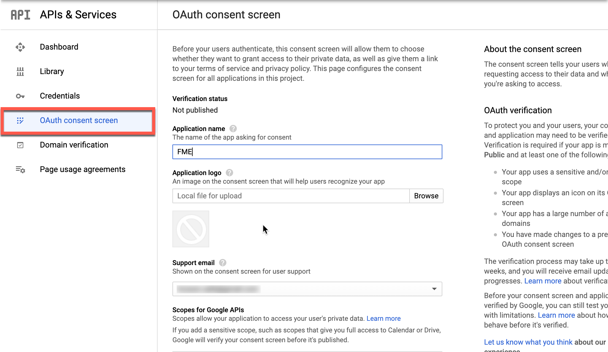

3. Once in your project, configure the OAuth consent screen. You'll first need to choose if your app is for internal purposes only.
Then fill in some additional information about the application

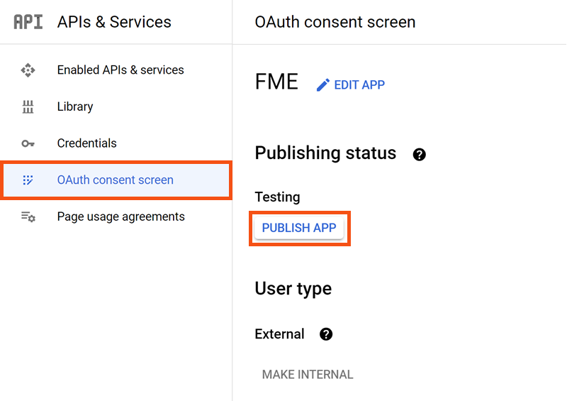

4. If you’ve created an External App, return to the OAuth consent screen and click Publish App.

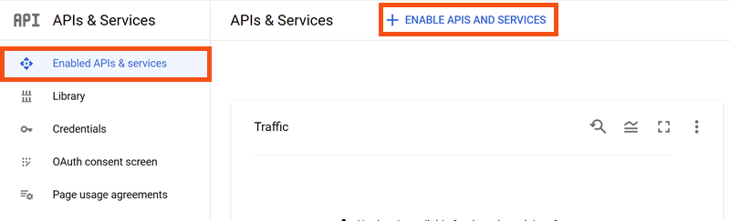

5. Under the Enabled APIs & services tab, click the Enable APIs and Services option.
Search for the Gmail API in the API Library. Choose to Enable the Gmail API.
Use the back arrow to return to the APIs & Services page.

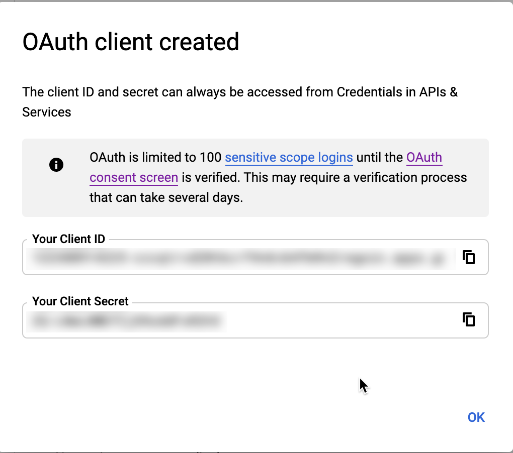

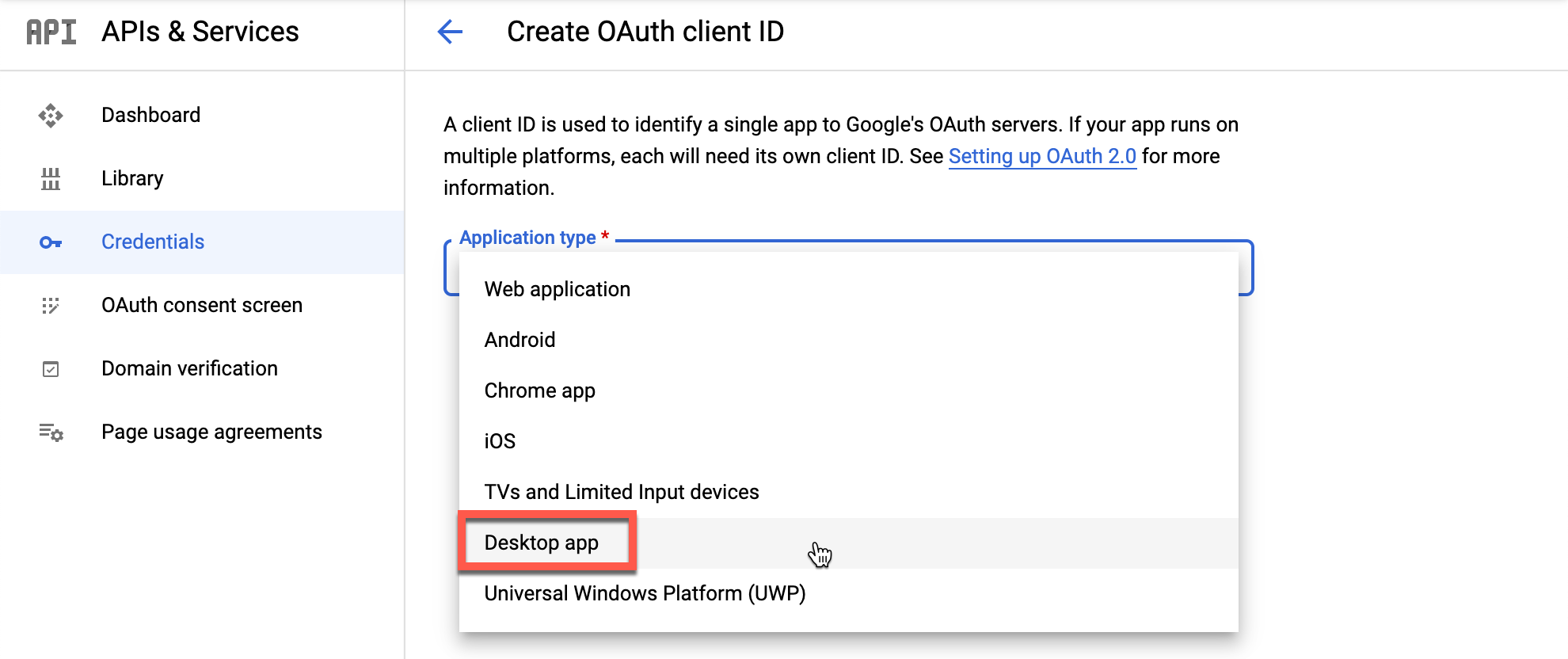

6. Create your Client ID and Secret
For the application type select 'Desktop App'
You'll now have a new Client ID and Secret that you can set your Gmail Web Service to use in FME

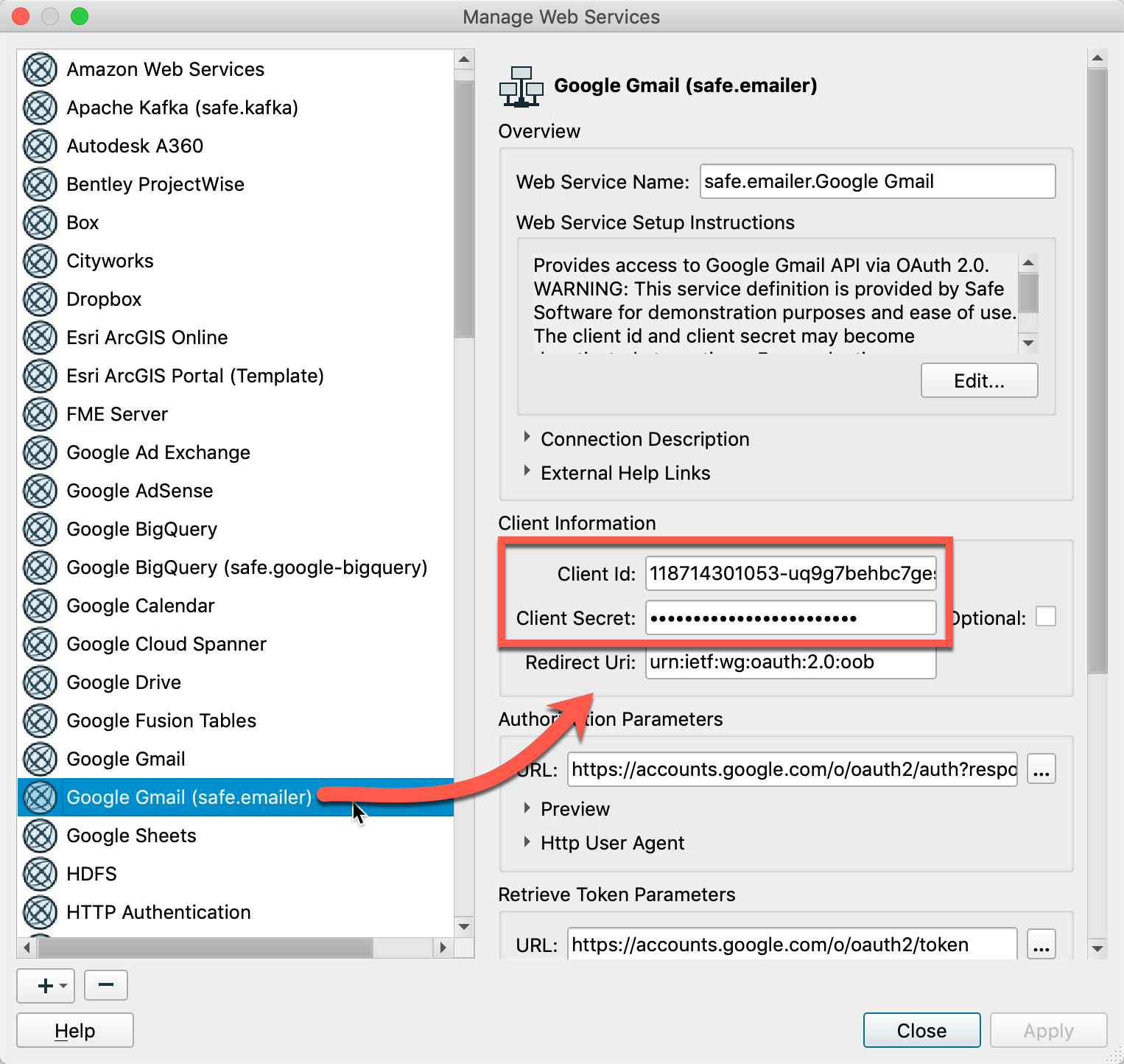

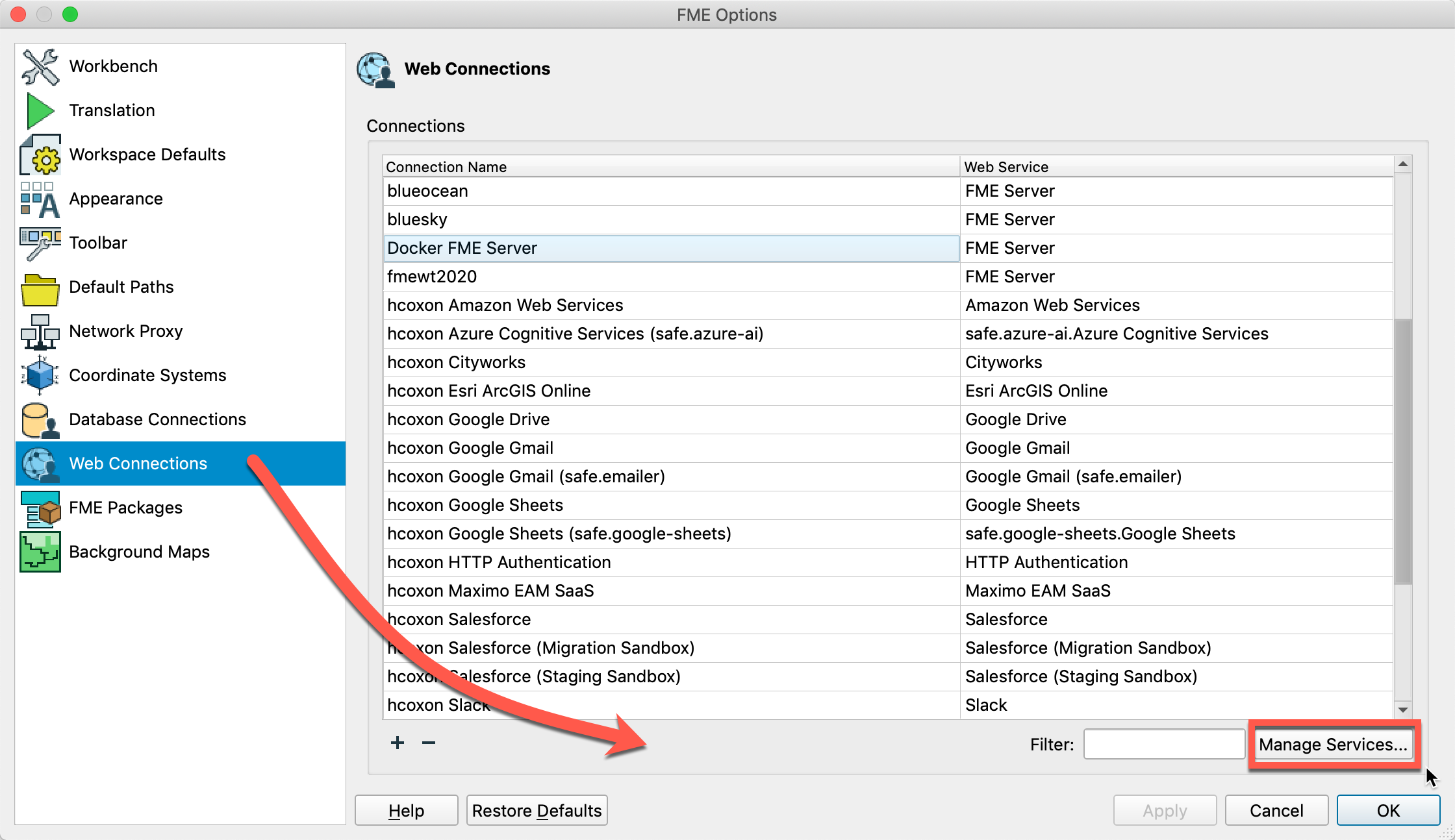

 7. Go to FME Desktop > FME Options and under Web Connections select 'Manage Services...'
8. Find your Google Gmail Web Service and update the Client ID/Secret under the Client Information Header with the ones you just created.
