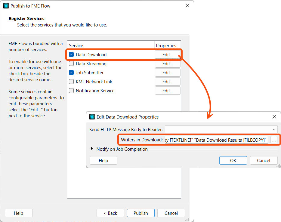

5. Publish to FME Flow
Save the workspace, then publish it to FME Flow. When registering for services, ensure that Data Download is selected. Click the Edit button and then for Include Writers in Download, select both TEXTLINE writers.

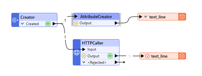

2. Add and Configure the HTTPCaller

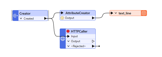

Add an HTTPCaller transformer and attach it to the Creator transformer.
Open the HTTPCaller settings.

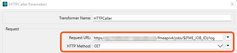

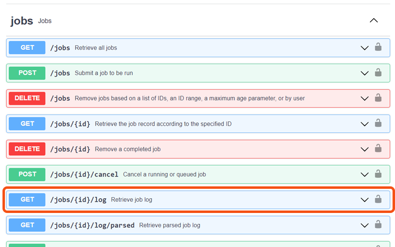

For the Request URL, navigate to your FME Flow REST API V4. Scroll down and expand Jobs and then expand the GET /jobs/{id}/log request used to retrieve a job log.
Select Try it out, fill out the parameters, and click Execute to test running the API call here.
The response will include the Request URL. Copy the Request URL and paste it into the HTTPCaller Request URL parameter. Then replace the job ID with $(FME_JOB_ID). Set the HTTP Method to GET.
Alternatively, you can enter the Request URL by inputting your FME Flow hostname in the following URL:
https://<YourFMEFlowHostname>/fmeapiv4/jobs/$(FME_JOB_ID)/log
Select Use Authentication and either select your FME Flow web connection or input your FME Flow credentials.
Investigate the Request Preview to make sure the call looks correct. You can select Send Test Request to test executing the request and examine the response. Once you’ve tested the request, leave the remaining parameters as default and click OK to close the HTTP Caller settings.
3. Run to the HTTPCaller and Inspect the Response

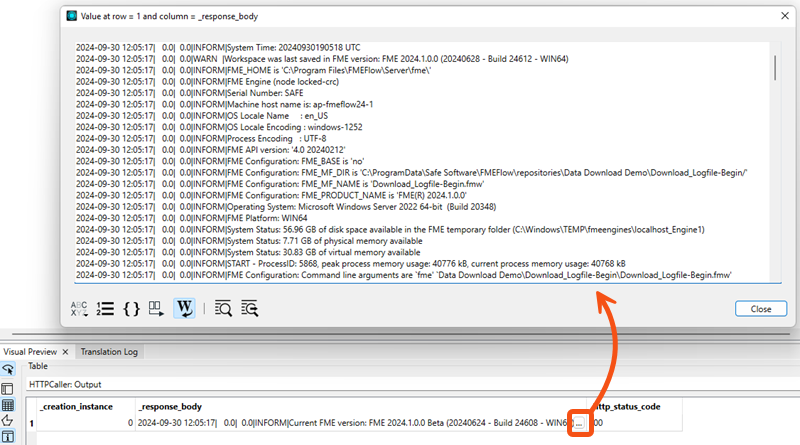

Run the workspace to the HTTPCaller and inspect the data coming out of the Output port of the HTTPCaller. In the Visual Preview window, click the ellipsis for the _response_body attribute to inspect.
The entire response body is the job log file.
4. Add a Text File Writer

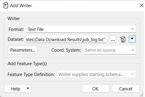

Add a Text File writer to the canvas. For the Dataset, browse to where you would like it to be saved, then name it job_log.txt, we will modify the filename in the next step.
Once the Text File writer is added to the canvas, connect it to the HTTPCaller output port.
Open the new Text File writer to examine the parameters. Navigate to the User Attributes tab and set the text_line_data value to the _response_body attribute containing the job log.

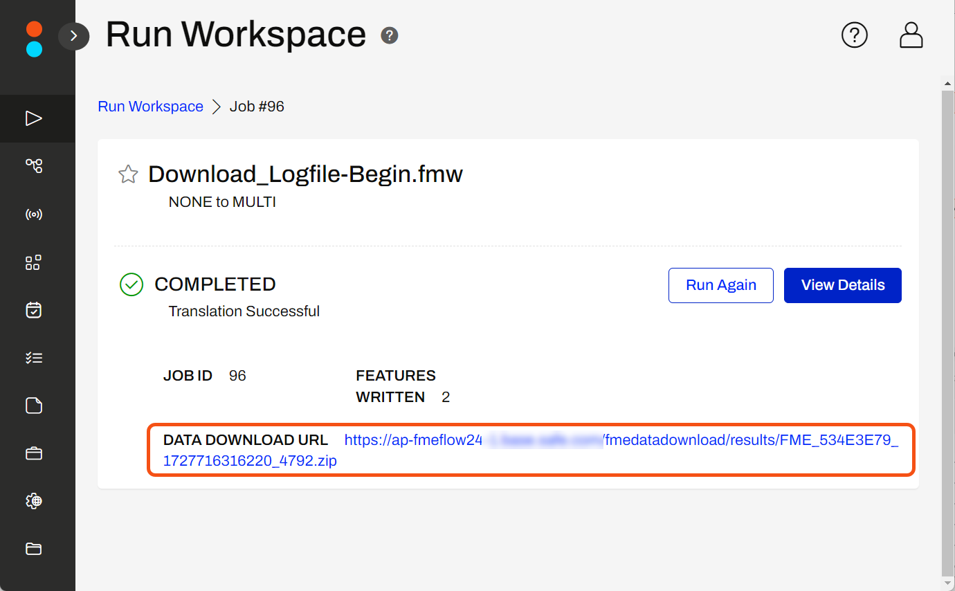

Log into your FME Flow. Run the newly published workspace.
After it has finished running, click on the data download link to download the file.
Once downloaded, browse to the file and inspect the output to confirm the log file.

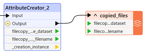

2. Add and Configure an Attribute Creator
Add a second AttributeCreator to the canvas and attach it to the Creator output port. Open the AttributeCreator settings and create the following attributes:
  • filecopy_source_dataset (this is the full source dataset path of the file to be copied)
  • filecopy_dest_filename (optional: to change the file name in the Data Download results, specify the new file name)
In the Value column, fill out the file path to the file to be copied and, optionally, the new file name.
Click OK to close the transformer.
3. Add a File Copy Writer
Add a File Copy Writer to the workspace. In the Dataset parameter, select a file location to copy the file to, however this will not be used when the workspace is run with the Data Download service on FME Flow. Next, name the folder to include the copied file. Attach it to the output port of the AttributeCreator created in Step 2.
If you specified a new file name in Step 2, open the File Copy Writer settings, and under Format Attributes, select the file_copy_dest_filename attribute to be exposed.
Click OK to save and close the writer settings.
When the attributes are expanded on the canvas, they will be green if they match and line up between the AttributeCreator and the File Copy Writer.
4. Publish the Workspace to FME Flow
Run the workspace on FME Form to test and then publish the workspace to FME Flow using the Publishing Wizard. When registering for services, ensure that Data Download is selected. Click the Edit button and then for Include Writers in Download, select both the TEXTLINE and FILECOPY writers.
