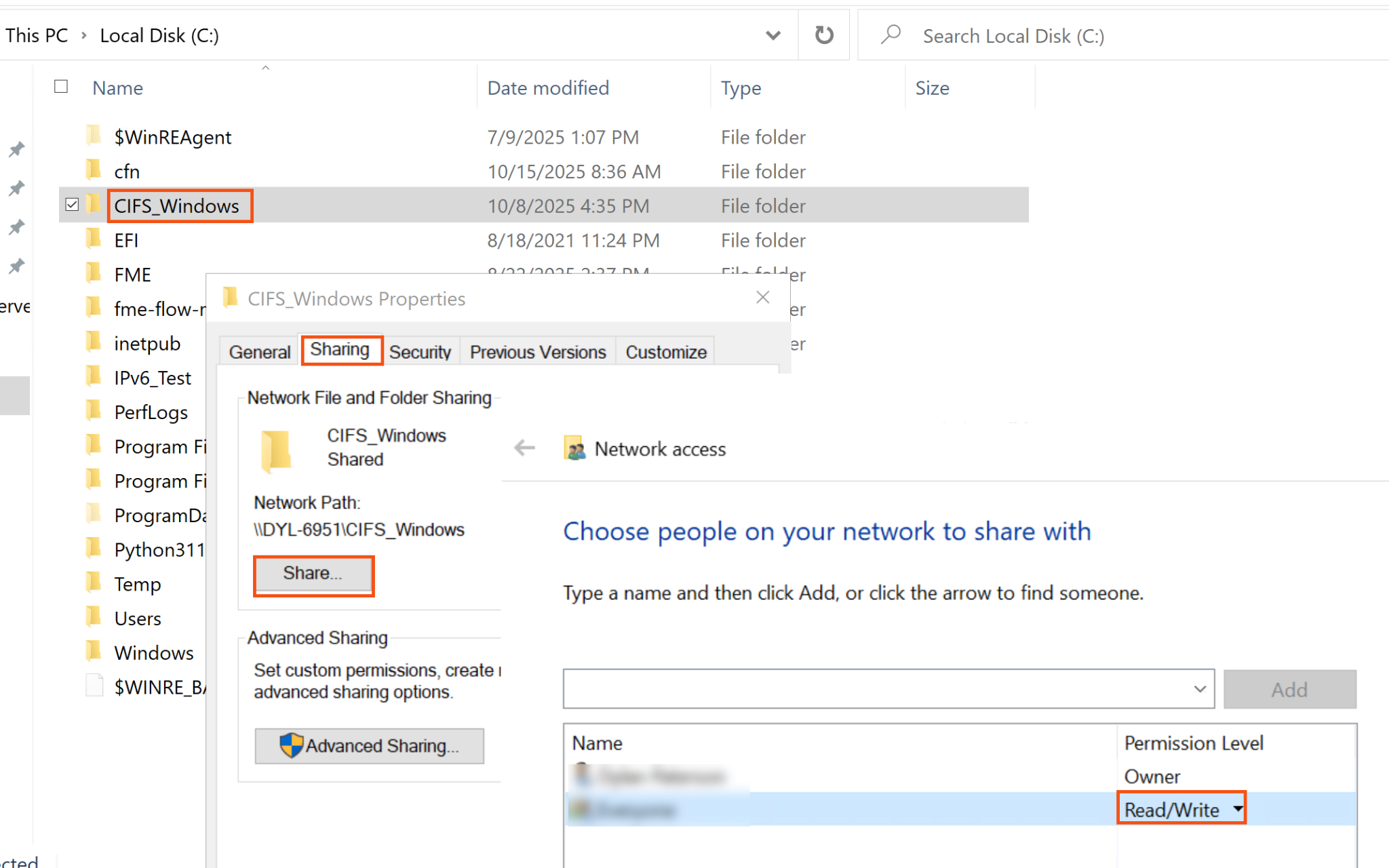

1. Configure the File Share on the Windows Host
  • Right-click on the file share folder, select “Properties”, and navigate to the “Sharing” tab.
  • Add the required user account to share the folder with and provide them with Read/Write permissions.
  • Note the “Network Path” of the file share folder, which is required for configuring CIFS on the FME Host.
Ensure FME Flow services run under the same user account to prevent permission issues.

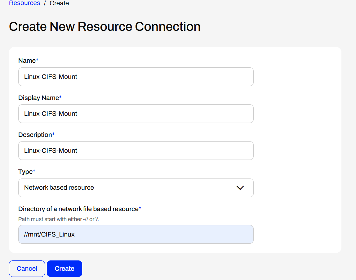

Creating a New Resource Connection In The FME Flow Web UI
1. Open Resources
 In the FME Flow Web UI, go to Resources → Create.
2. Configure the Resource Connection
Enter the metadata:
  • Name
  • Display Name
  • Description
Select the type and directory:
  • Type: Network-Based Resource
  • Directory: Full local mount path on the FME Flow host
3. Save and Verify
Click Create. Expand the new resource in Resources and browse to confirm you can list files.

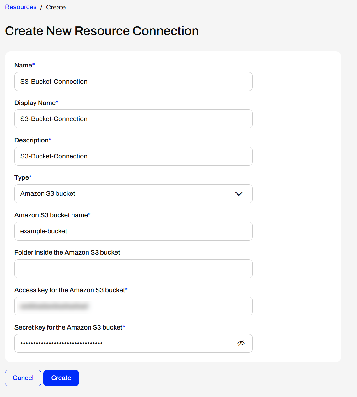

Part 2: Connecting An Amazon S3 Bucket
In this section, you'll learn how to connect an Amazon S3 bucket to FME Flow. The process is similar to creating a network-based resource but requires a few additional configuration details.
1. Open Resources
Enter the metadata:
  • Name
  • Display Name
  • Description
Configure the bucket settings:
  • Type: Amazon S3 bucket
  • Bucket Name: <your-bucket>
  • Access Key and Secret Key: from the AWS Management Console
This information is available via the AWS management console. Contact your IT administrator for details.
3. Save and Verify
Click Create. Open Resources and browse the bucket to confirm access.
