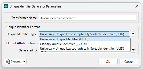

As part of the FME 2023.0 release, the UniqueIdentifierGenerator debuts as the new and improved UUIDGenerator. Previously, the UUIDGenerator could only generate UUIDs or GUIDs. Now, the UniqueIdentifierGenerator adds a third option: ULIDs.
What makes ULIDs special? In addition to doing everything a UUID can, it includes a time component, which makes it possible to sort by generation time. Compared to UUIDs and GUIDs, ULIDs are more compact, making them a more attractive choice for databases or situations where storage and efficiency take priority.

In most cases, the UniqueIdentifierGenerator should suffice for your unique identifier needs; however, the GUIDGenerator is also worth mentioning. This custom transformer is another option if you're working with GUIDs. You can find it in the FME Hub, and it comes in handy if you want to generate Esri-specific GUIDs, which differ from regular GUIDs because they need to be sandwiched between two curly brackets. This transformer does just that and writes it out as a GFID attribute.
