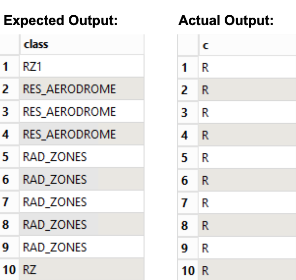

Using the SHAPEFILE writer the attribute names and values of my dataset have been truncated to a single character.
SHAPEFILE writer, expected vs actual output
If I inspect the output file in FME Data Inspector using the SHAPEFILE format it appears correct, however opening the file using the ESRISHAPE format or other applications is when the attribute data is missing.

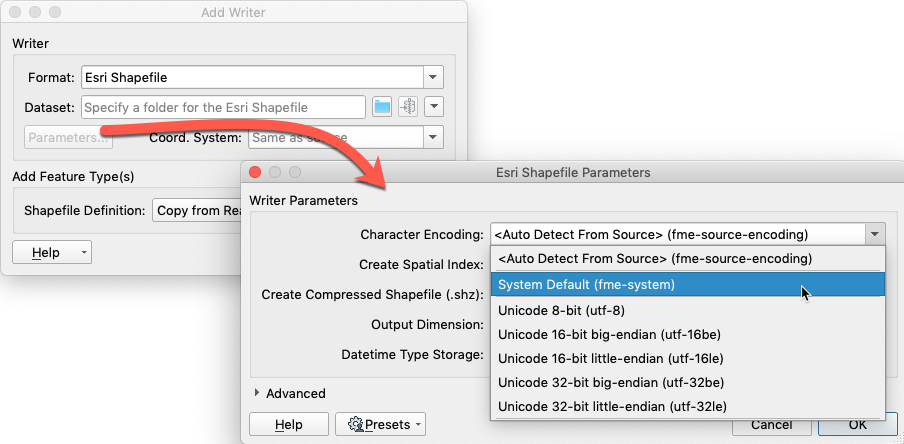

Override the SHAPEFILE writer’s decision by explicitly setting the Writer Character Encoding to use something other than fme-source-encoding.

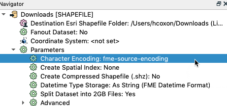

Add Writer Parameters: set Character Encoding
If the writer has already been added to the canvas, you can locate the Character Encoding setting under the writer parameter section in the Navigator.
Navigator Writer Parameters: set Character Encoding
