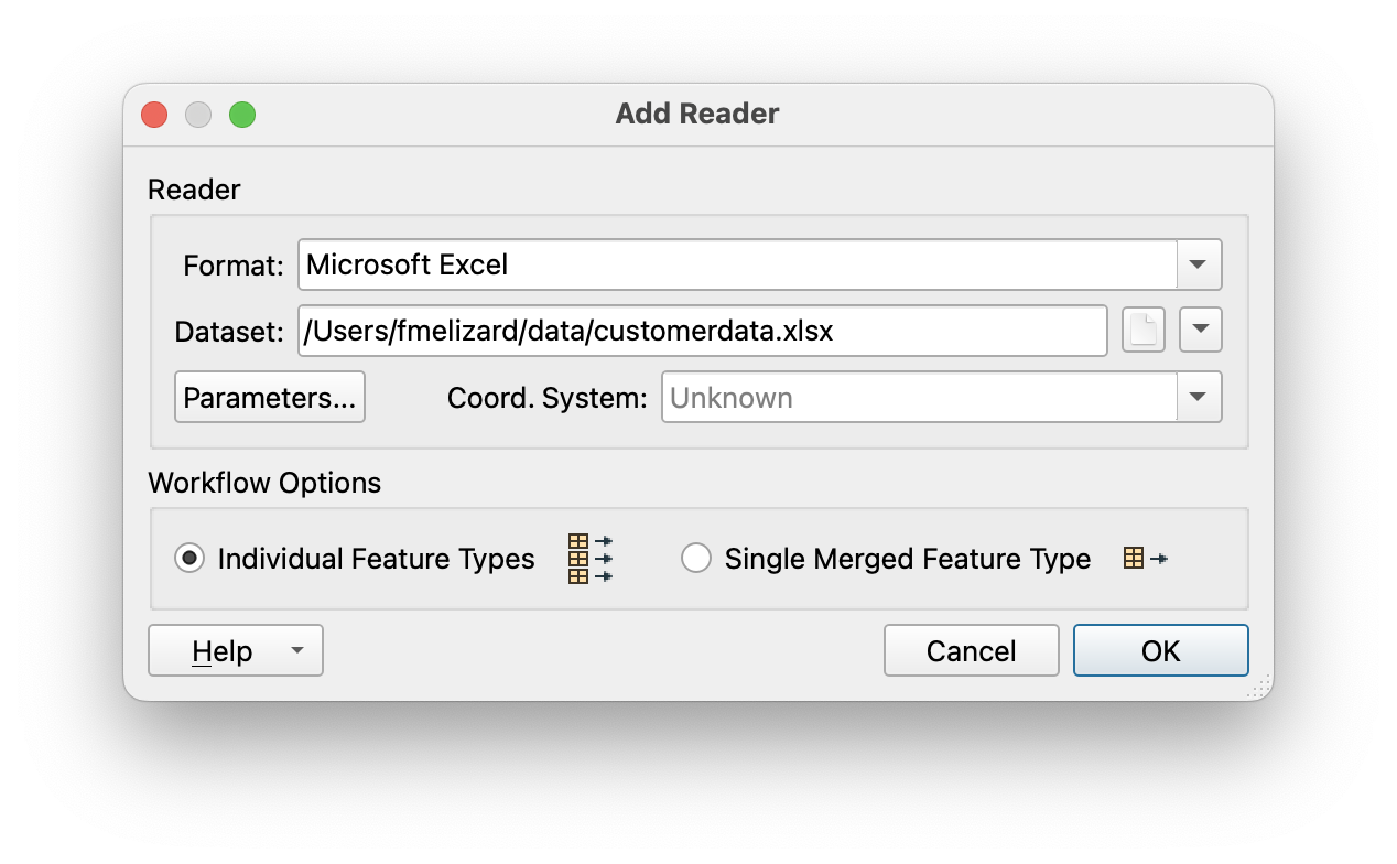

3. Add a Reader
To kick off the workspace, we’ll need to read the source data and set up the AI prompt. Click Add Reader and set the following parameters:
  • Format: Microsoft Excel
  • Dataset: <Tutorial download>/customerdata.xlsx
You can click Parameters to preview the source dataset.

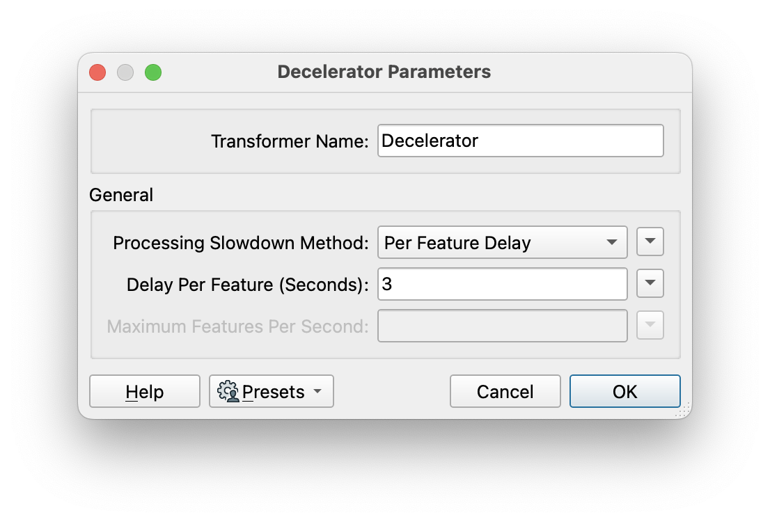

4. Add a Decelerator
Add a Decelerator transformer and connect it after the reader feature type. Open the parameters.
OpenAI limits queries to 60 per minute to prevent excessive API requests. Since each of our queries will ask 3 questions, we’ll set the delay to 3 seconds per feature.
Note that this transformer may or may not be necessary, depending on the workspace.

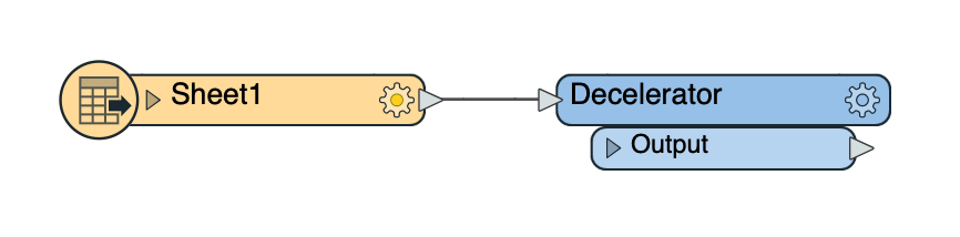

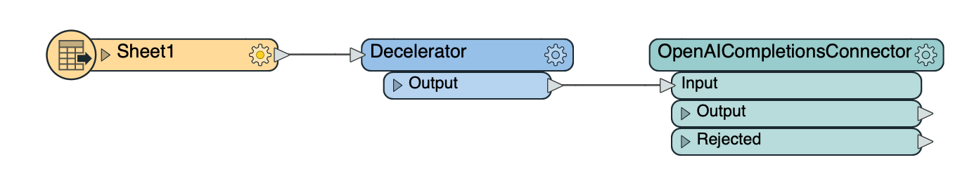

The workspace should look as follows:
5. Add OpenAICompletionsConnector Transformer
Type "OpenAI" on the canvas and select the OpenAICompletionsConnector. Connect it after the Decelerator. Open the parameters. This is where you specify the question you want to ask the AI and select the model you want to use, e.g., davinci. There are many models to choose from, each specialized for different tasks – see the OpenAI API documentation for details.

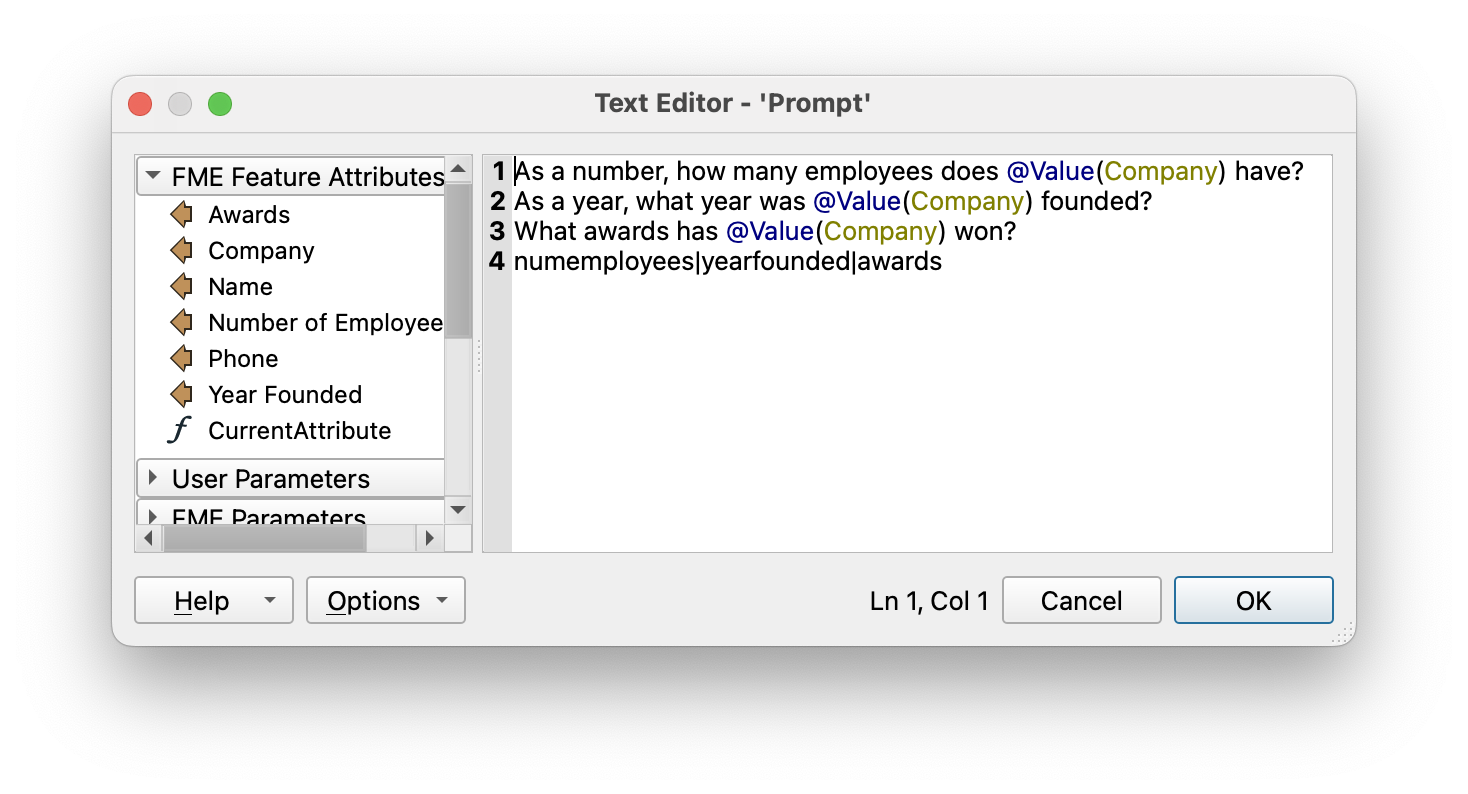

  • Prompt:
As a number, how many employees does @Value(Company) have?
As a year, what year was @Value(Company) founded?
What awards has @Value(Company) won?
numemployees|yearfounded|awards
“Max Tokens” defines the size of the answer and prompt – see this Tokenizer tool for an explanation and a helpful guide.
Best practices for the prompt:
  • Put each question on its own line, and in the last line, specify how to return the answers (e.g., as a | delimited list)
  • Be specific on how you want the answers returned, e.g., “as a year”, “as a two-character month abbreviation”, etc.

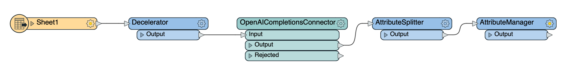

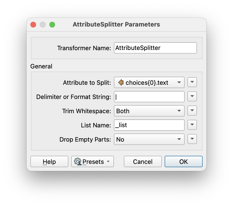

6. Add an AttributeSplitter
Add an AttributeSplitter and connect it after the OpenAI transformer. This will split the output into a list, as defined above, delimited by |.
Open the parameters and set the following:
  • Attribute to Split: choices{0}.text
  • Delimiter or Format String: |

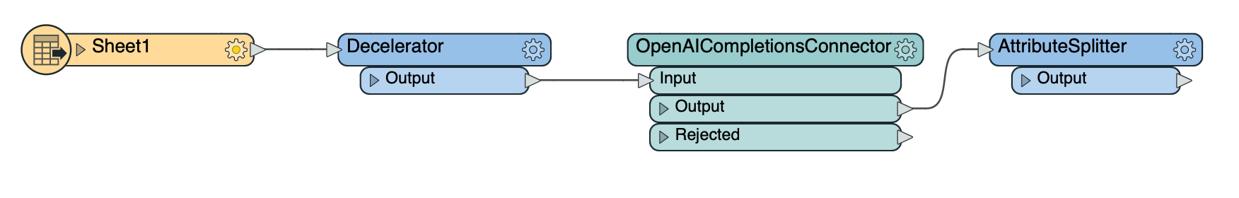

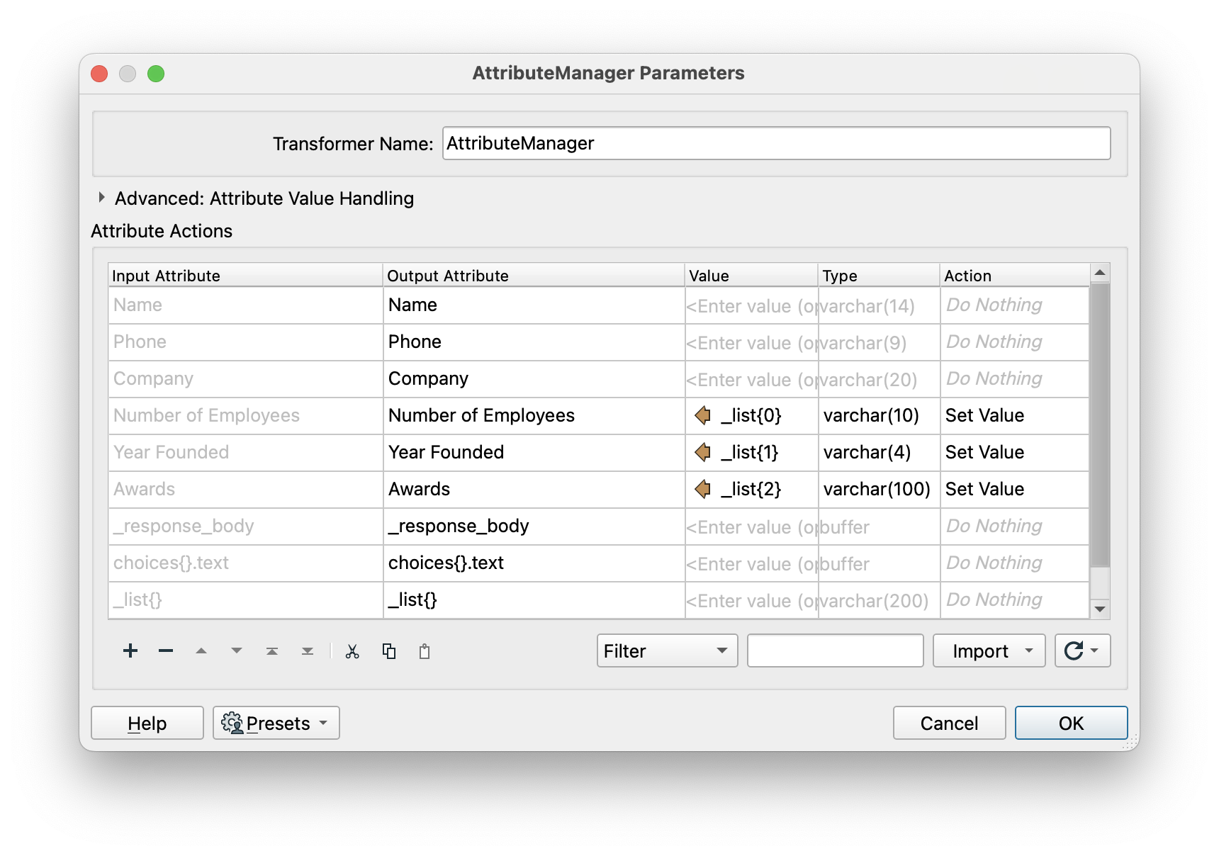

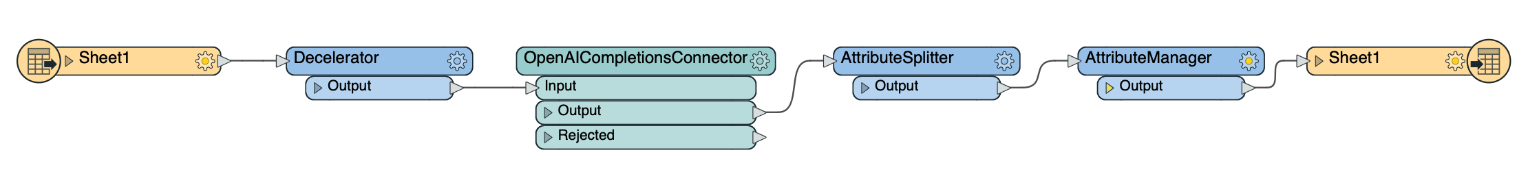

7. Add an AttributeManager
Add an AttributeManager to define which parts of the output should be assigned to which attributes/columns in the output spreadsheet.
The previous transformer will return a list called “_list” containing our three answers. Given that, open the parameters and set the following Input Attributes and Output Attributes:
