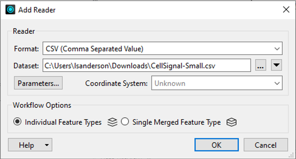

First, we need to add a source dataset. Click on the Reader button. In the Add Reader dialog, enter the following:
  • Format: CSV (Comma Separated Value)
  • Dataset: CellSignal-Small.csv
    • Click on the ellipsis and browse to the downloaded dataset
Then click OK.

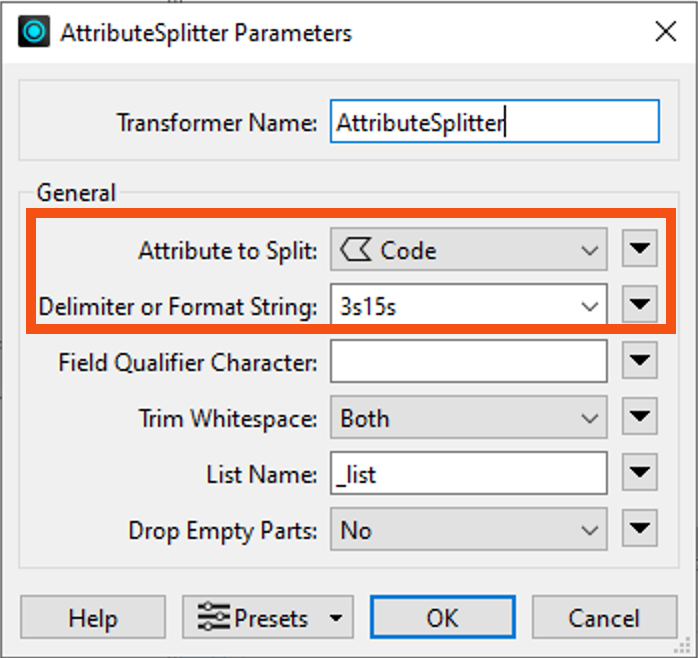

We need to split the “Code” field into two new attributes: one for the first three characters and one for the trailing characters. To do this, we will use an AttributeSplitter transformer.
Add an AttributeSplitter transformer to the canvas, and connect it to the CSV reader feature type. In the parameters, set:
  • Attribute to Split: Code
  • Delimiter or Format String: 3s15s
Then click OK.
The Format String uses a #s#s#s format - integers defining the width of each part, separated by an “s” character.  This will split the field (attribute) into the leading three characters and the trailing characters, up to 15, and populate them in a list array.

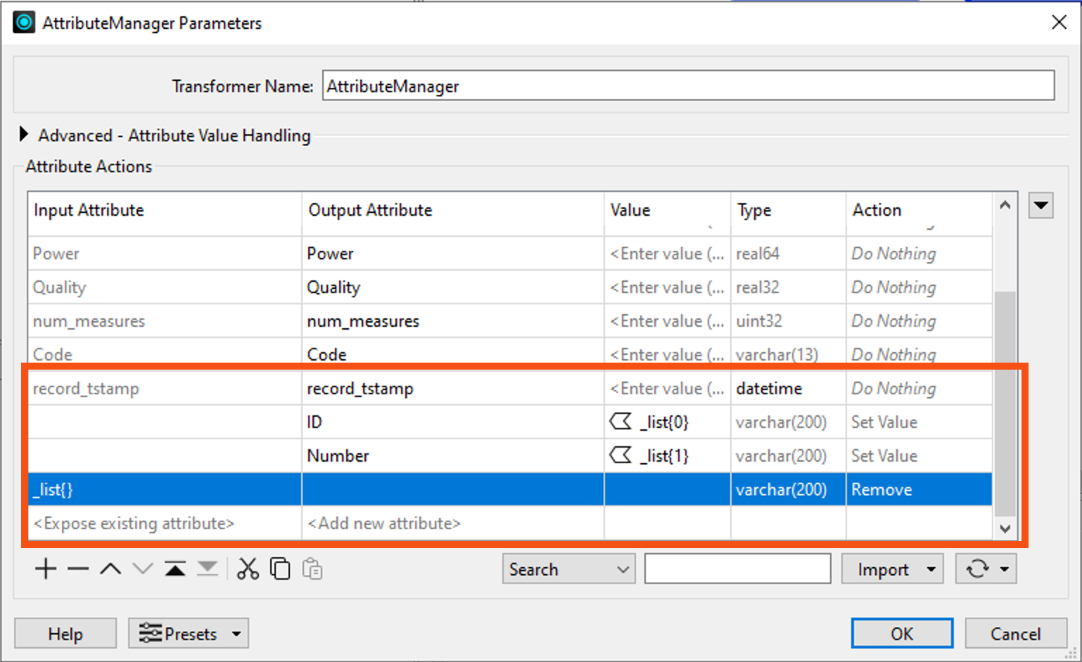

Add an AttributeManager to the canvas and connect it to the AttributeSplitter. In the AttributeManager parameters, create the following:
  • Update Attribute:
    • Input Attribute: record_tstamp
      • Type: datetime
  • Add Attribute:
    • Output Attribute: ID
      • Value: _list{0}
    • Output Attribute: Number
      • Value: _list{1}
  • Remove Attribute:
    • Input Attribute: _list
      • Action: Remove
Then click OK.
The AttributeManager performs each attribute action top down, so the ID and Number attributes need to be above the _list attribute to use the _list attribute values prior to removing _list. Use the arrows to reorder the attributes if needed.

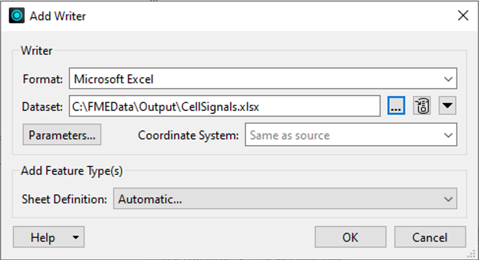

Now the data needs to go to the destination. Click on the Add Writer button on the toolbar. In the Add Writer dialog, enter the following:
  • Format: Microsoft Excel
  • Dataset: CellSignals.xlsx
    • Use the ellipsis and browse to a location to save
Then click OK.
After clicking OK, the Feature Type dialog appears, click OK to close it for now, as we will need to connect it to our data. Connect the Sheet1 writer feature type to the AttributeManager.

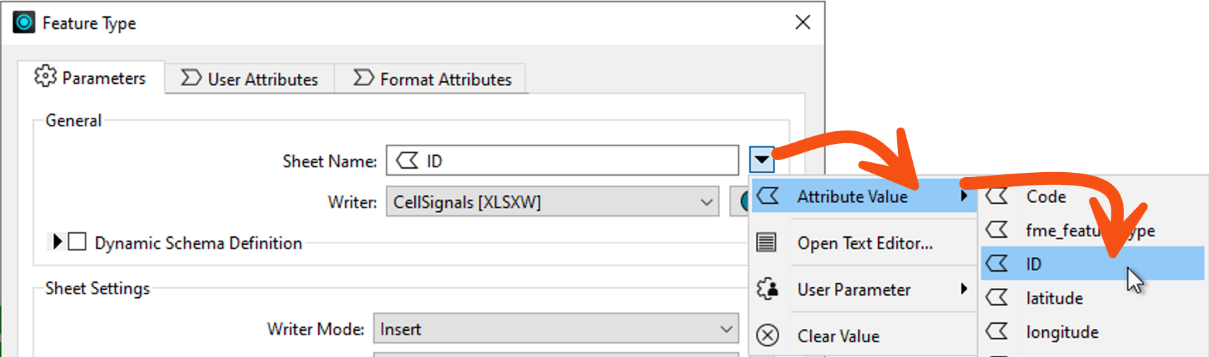

5. Set Sheet Names
We want to create a new Excel worksheet for each individual ID that appears in the dataset, for example, ABC, ABD, TXU, and TXV. We can achieve this by doing a feature type fanout.
Double-click on the Sheet1 writer feature type to open the parameters. In the parameters, set:
  • Sheet Name: @Value(ID)
Then click OK.
To set the Sheet Name to an attribute, click the drop-down arrow, then expand Attribute Value and select ID.

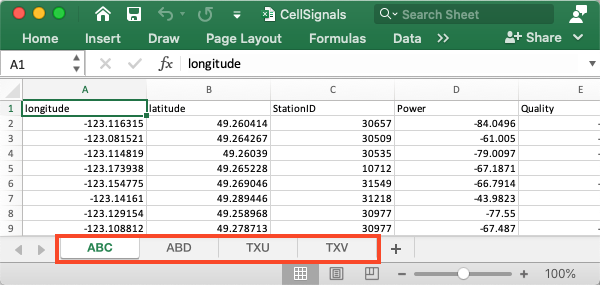

6. Run the Workspace
Run the workspace, then open the containing folder and view the newly created Excel file in Microsoft Excel. There will be four worksheets, two new attributes, and the record_tstamp will be recognized as a datetime format.
