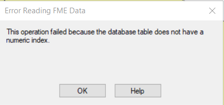

When previewing a PostGIS table after creating an FME Connection to it in ArcGIS the following symptoms may occur:
- a message "The current selection be displayed as a table" appears
- an empty table appears
- an error about a numeric index appears
Cause
To see the table in ArcGIS you must have a unique integer field in your table when writing to PostGIS.
Resolution
Using SQL Command: Using SQL Statement create a spatial index on the table. See troubleshooting documentation for the commands.
In FME Desktop: Use the "int4" type on the destination schema with "PRIKEY" set for the Index to achieve this. A Counter can be used to create unique values if they do not already exist on your features.
