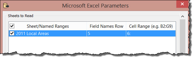

1. Read in Data
Read in the source data, CensusLocalAreaProfiles2011.xls, using the Excel Reader. Under Parameters, set Field Names Row to 5 and Cell Range to 6:.

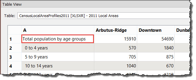

2. Inspect Data
Inspect the data with the Data Inspector. We want to make the columns into rows to make the data easier to work with. In this example, we are only interested in the population totals, not all the data, as that would be overwhelming.

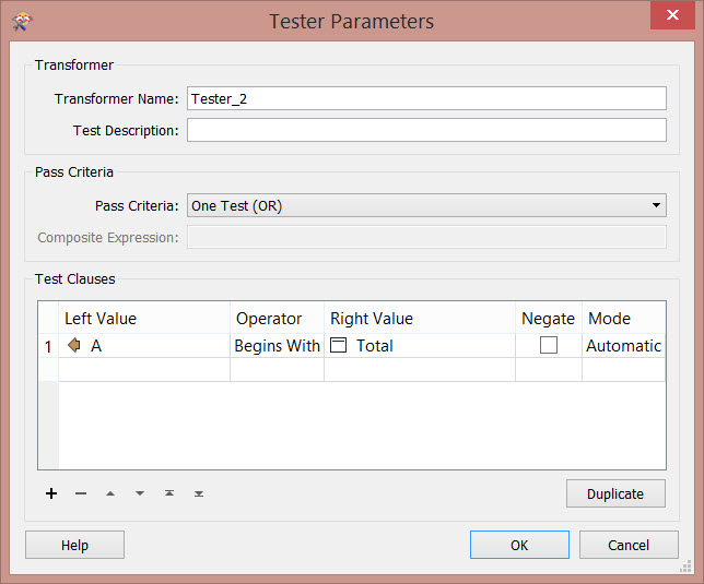

3. Get Total Statistics
To get only the total statistics, add a Tester transformer. Set the Test Clauses to:
Left ValueOperatorRight Value
ABegins WithTotal

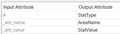

7. Cleanup Attributes
Connect an AttributeManager to the Failed output port of the Tester. The attributes are given more descriptive names in the AttributeManager:
A is renamed to StatType as it represents the statistical type
_attr_name is renamed to AreaName as it represents the Vancouver area boundaries
_attr_value is renamed to StatValue as it represents the population totals

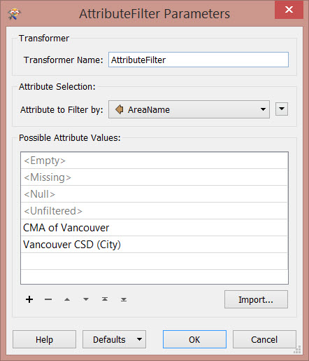

8. Filter Attributes
The AttributeFilter filters attributes by AreaName. For Possible Attribute Values, please add CMA of Vancouver and Vancouver CSD (City). This will filter out statistics from the whole city of Vancouver, as we are only interested in the Vancouver area boundaries.

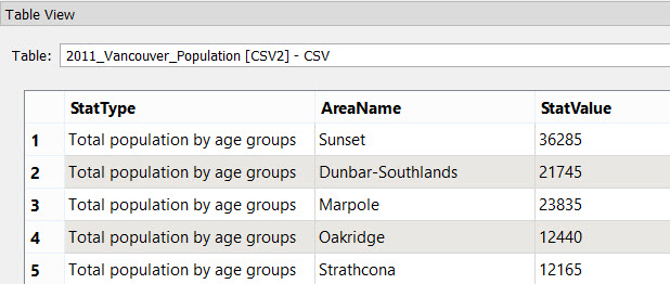

9. Write to CSV
Add a CSV Writer, specifying an output dataset location and setting CSV File Definition to Automatic. Attach the writer feature type to the AttributeFilter <Unfiltered> port. Rename the writer feature type to something more descriptive and ensure the attributes include StatType, AreaName, and StatValue. Once the workspace is run, the output CSV file can be added to Tableau. Alternatively, write out in the format of your choice. Feel free to overlay the data with local_area_boundary.shp.
