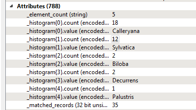

The ListHistogrammer builds a histogram of the values found in a list and returns these in a new list attribute. The new list will be sorted so that the value with the most occurrences will be first. Using this transformer with the data in the Working With Lists workspace, we can easily identify the park with the most trees and determine the number of each species represented within each park. As a bonus, you can specify your own histogram list name, making it possible to have multiple histograms on a single feature.
Here we’re counting the occurrence of each tree species within a single park using the ListHistogrammer:

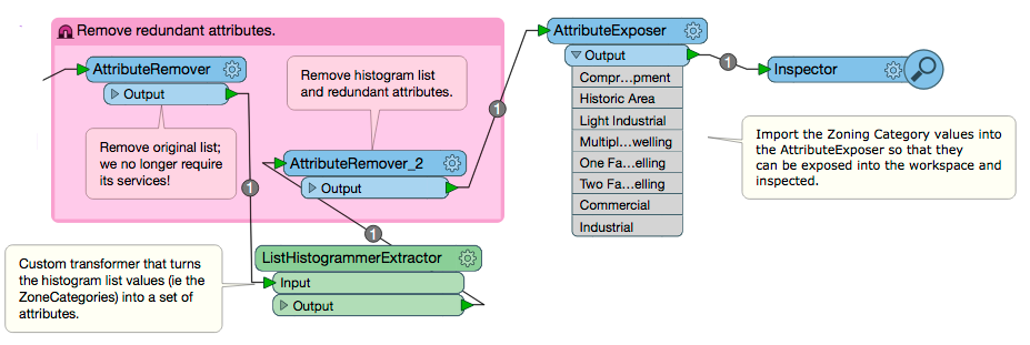

In the ListHistogrammer workspace, the user needs to count the number of features of each type (zone) in a set of zoning data. This can be achieved by creating an artificial aggregate and a list of the source data, and subsequently running it through the ListHistogrammer.
The workspace actually goes one step further: it uses a custom transformer to convert the histogram into a set of attributes and values. It also demonstrates an interesting use of AttributeExposer to import values from the Zoning data, allowing all newly generated attributes to be exposed and inspected.
