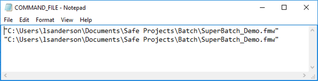

1. Create the Command File
Create a text file (the command file) containing the full path to the workspace file. Duplicate this line to simulate multiple workspaces running. Save it with any name, but remember where you saved it, as it will be referenced in the next step.
"C:\Users\lsanderson\Documents\Safe Projects\Batch\SuperBatch_Demo.fmw"

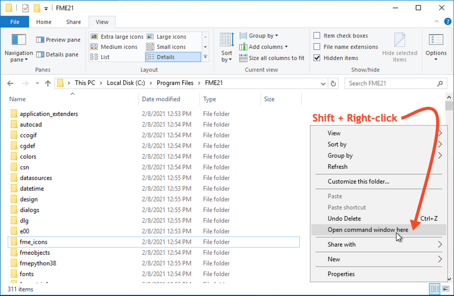

2. Open Command Window in FME Form Directory
Navigate to the install directory of FME Form, then hold Shift while right-clicking, then select “Open command window here.”

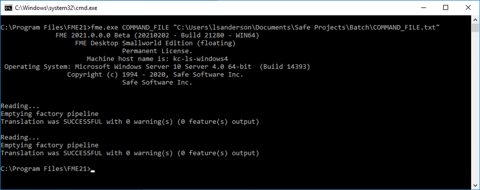

In the FME directory, run the following command:
fme.exe COMMAND_FILE <pathToCommandFile>
Example:
fme.exe COMMAND_FILE “C:\Users\lsanderson\Documents\Safe Projects\Batch\COMMAND_FILE.txt”
