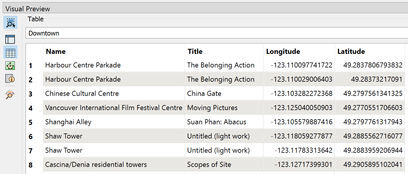

The data we are working with represents public art in Downtown Vancouver and contains latitude and longitude values for each row:

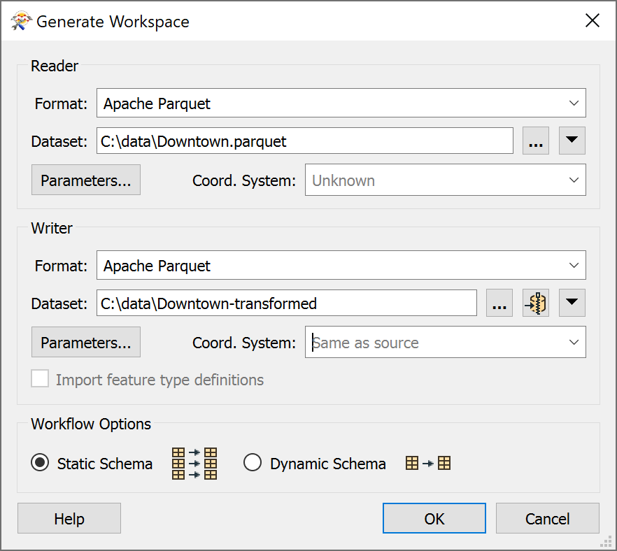

Open FME Workbench and generate a new workspace. Add an Apache Parquet reader and writer by entering the following parameters:
  • Reader Format: Apache Parquet
  • Reader Dataset: C:\<Tutorial Download>\Downtown.parquet
  • Writer Format: Apache Parquet
  • Writer Dataset: C:\<Tutorial Download>\Downtown-transformed
  • Workflow Options: Static Schema
Click OK.

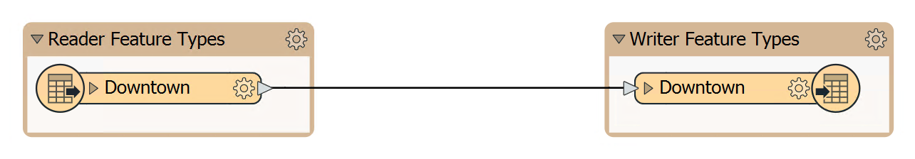

A workspace is generated that translates the input .parquet file to an output .parquet file.

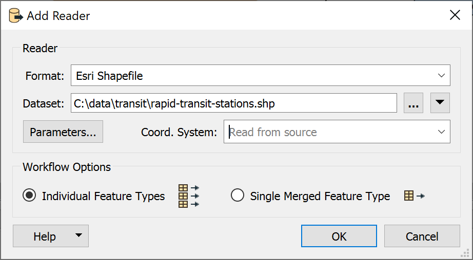

Click “Add Reader” and enter the following parameters:
  • Format: Esri Shapefile
  • Dataset: C:\<Tutorial Download>\transit\rapid-transit-stations.shp
  • Workflow Options: Individual Feature Types
The workspace now has two reader feature types, one for Downtown and one for rapid-transit-stations.

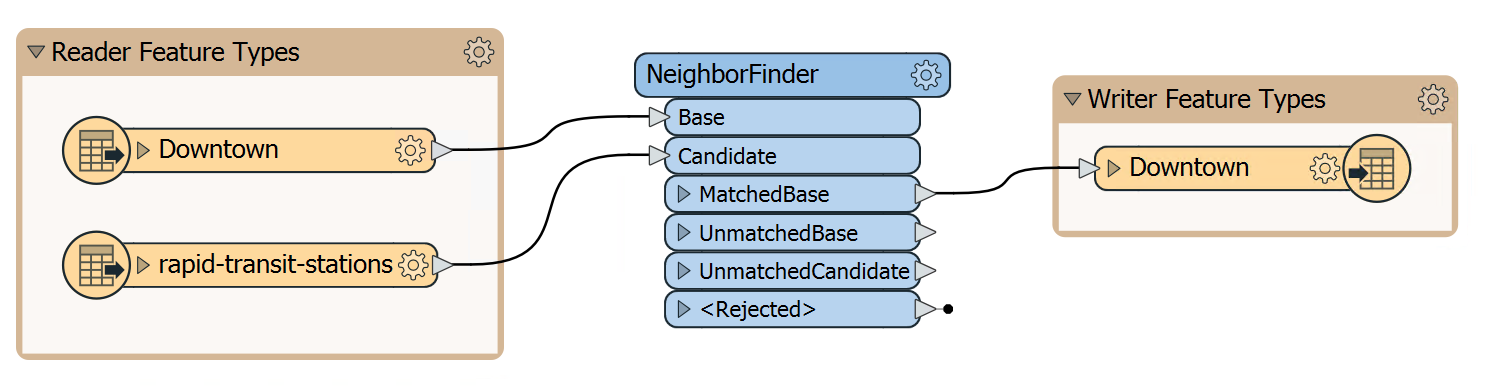

3. Add a NeighborFinder transformer
Click anywhere on the canvas and begin typing “NeighborFinder”. Click the transformer to add it to the workflow.
On the input side, connect the Downtown feature type to the Base port and the rapid-transit-stations feature type to the Candidate port.

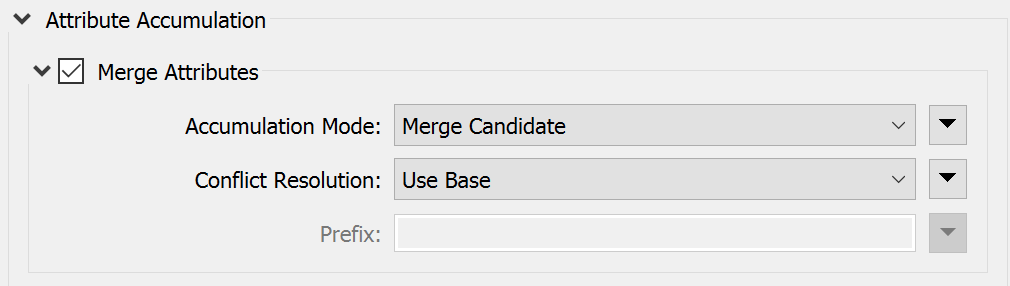

Open the NeighborFinder parameters. Under the “Attribute Accumulation” section, check “Merge Attributes”. This ensures that the station name from the Shapefile dataset appears in the output Parquet dataset.
Connect the MatchedBase output port to the Downtown writer feature type. The workspace should look as follows:

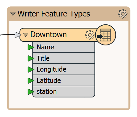

4. Configure the Output Attributes

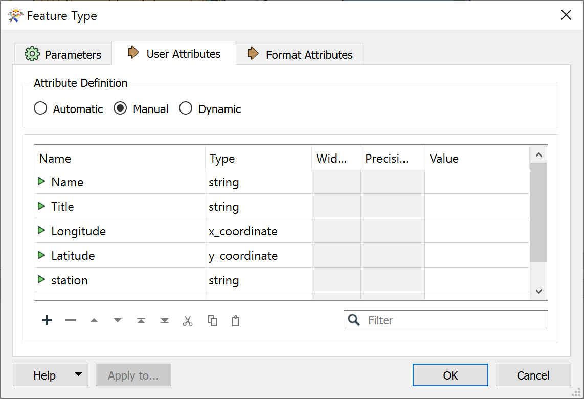

Open the parameters on the output writer feature type. In the User Attributes tab, ensure “Manual” is chosen and add a “station” attribute of type “string”. The list of attributes should consist of Name, Title, Longitude, Latitude, and station (case-sensitive). This ensures that we write only the columns we care about in the output Parquet file, which includes the station name taken from the Shapefile dataset.
Click OK.
When you expand the writer feature type, you should see the list of attributes with green input arrows. If an arrow is red, it means the attribute name does not match the source.

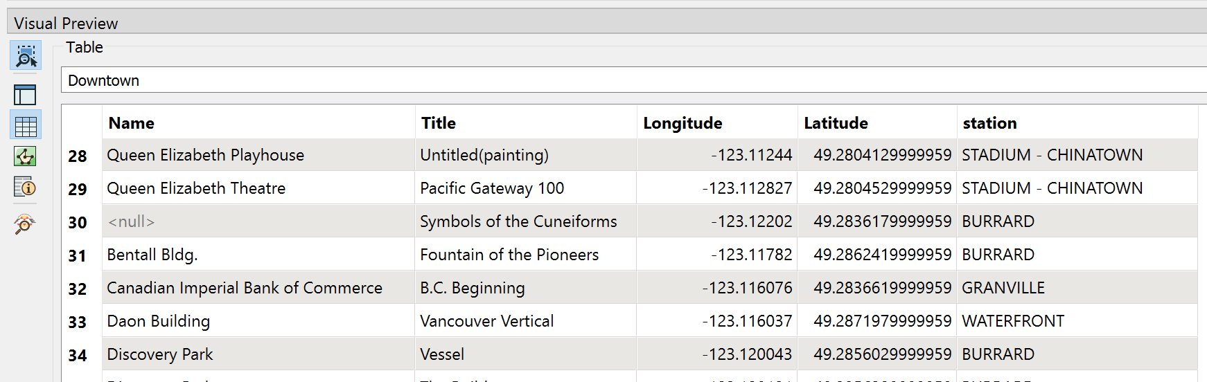

Run the workspace to perform the desired spatial processing on the Parquet dataset. The file Downtown.parquet is generated in the Downtown-transformed folder, which contains an additional column with the name of the nearest transit station. This file can now be uploaded back to the cloud.
