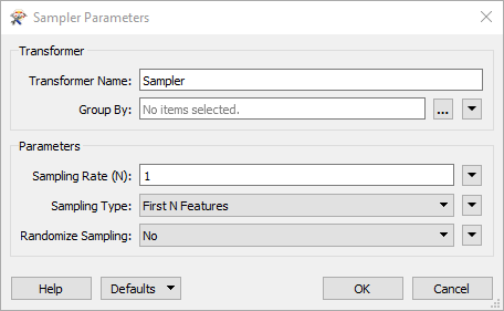

4. Add a Sampler transformer. The reason for this is that only one feature is sent to the SQLExecutor, which will end the edit session on the versioned table. As the SQLExecutor will execute for each feature, ending the Edit session after the first feature, we do not need more than one feature being sent. Set the parameters as follows

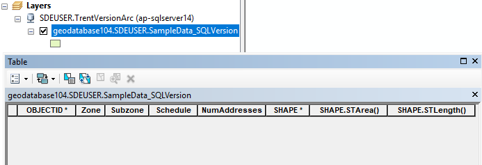

SQL Server Base table after Truncating version.
SQL Server Specific version after Truncate

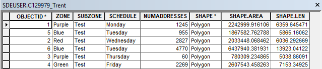

Oracle Base Table after updating the version.
Oracle Updated versioned Table looking at version we just updated.
