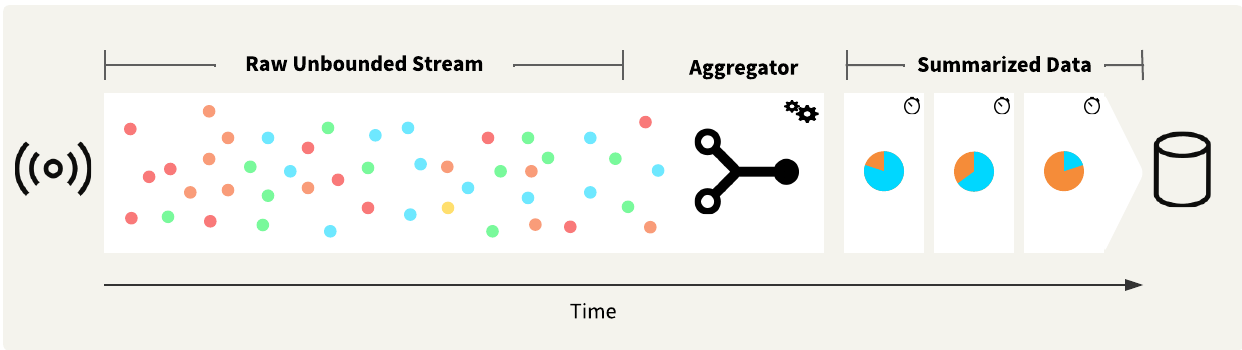

Unbounded streams can contain large amounts of data, but if your end goal is to summarize the data, it would be very costly to store the data before processing.  With FME streams, summarized blocks of data defined by time windows and/or geographic boundaries can be aggregated and processed from the stream before being committed to disk.
Aggregate Points
