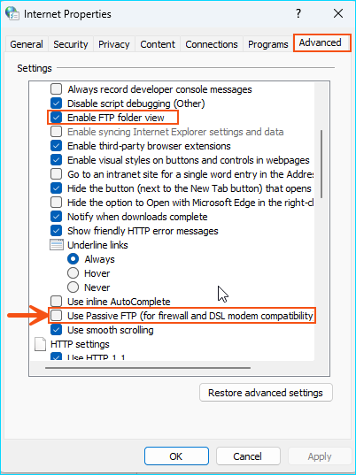

Windows 11:
  1. Open Internet Options (Win + S, search "Internet Options").
  2. Go to the Advanced tab.
  3. Select “Enable FTP folder view”
  4. Uncheck or check "Use Passive FTP (for firewall and DSL modem compatibility)".  Depending on your network settings.
  5. Click OK (you might need to restart your PC).

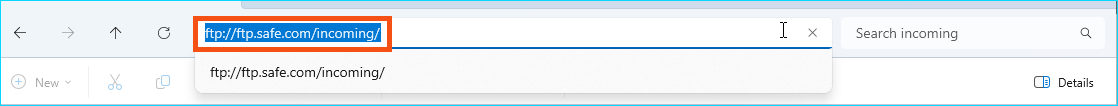

Open File Explorer.  Click on the address bar, then type ftp://ftp.safe.com/incoming/ and press Enter.
Be sure you are uploading the correct file, as you cannot access it to remove it. Additionally, please remove any sensitive information from your file names. Take note of what your file is named, and enter that into the bottom of the Safe Software Support form so we can connect your file to your support case.

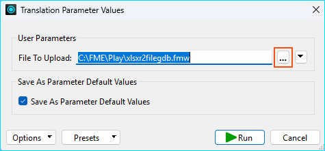

You can also upload to the FTP site using FME! Download the workspace, run it, and upload your file. The workspace has been set up with a User Parameter for the file upload. Browse the file you wish to upload and click OK.
Once the workspace has finished running, check the FTP site to confirm the upload was successful. Be sure you upload the correct file as you cannot access it to remove it. Additionally, please remove any sensitive information from your file names. Take note of what your file is named and enter that into the bottom of the Safe Software Support form so we can connect your file to your support case.

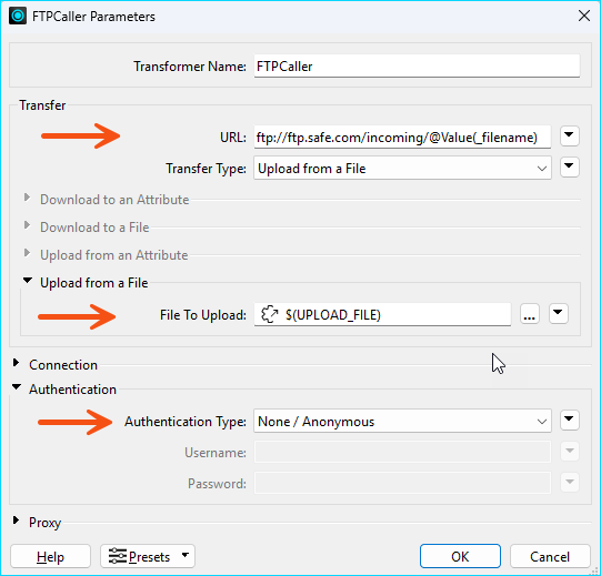

This workspace uses the FilenamePartExtractor transformer to retrieve the name of the file to be used when uploading to the FTP site. Then to upload to the FTP site, an FTPCaller transformer is used, with the URL set to ftp://ftp.safe.com/incoming/@Value(_filename) and the Transfer Type set to Upload from File. Then the Authentication Parameters are expanded, and the Authentication Type is set to None/Anonymous (this is the default parameter)
