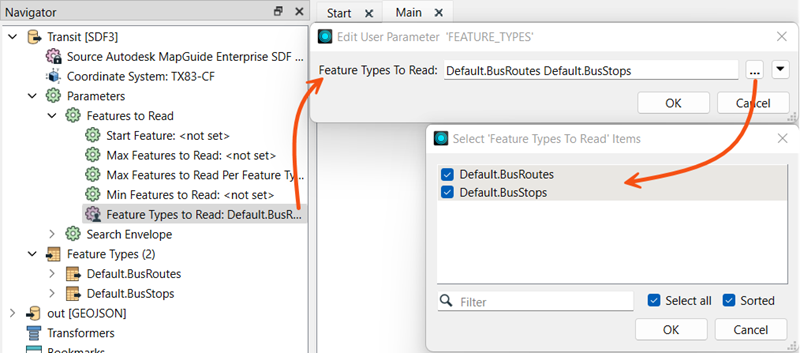

The Transit SDF dataset contains two feature types, bus routes and bus stops. If your dataset is formed of multiple layers (feature types) you can set up a user parameter where the user can request to stream one or many layers. For testing purposes, you can select a single layer to read by going into the reader parameters in the Navigator window and setting the Feature Types to Read.

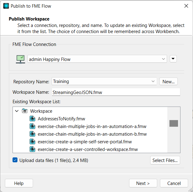

Go to File and select Publish to FME Flow. In the Publish Workspace window, make sure you’re connected to FME Flow, create or choose a Repository to save the workspace in, and also ensure the Upload data files box is checked.
Register the workspace with the Data Streaming Service, select the edit button here to explore the different options, and make sure the GeoJSON file has been selected as the writer to stream.

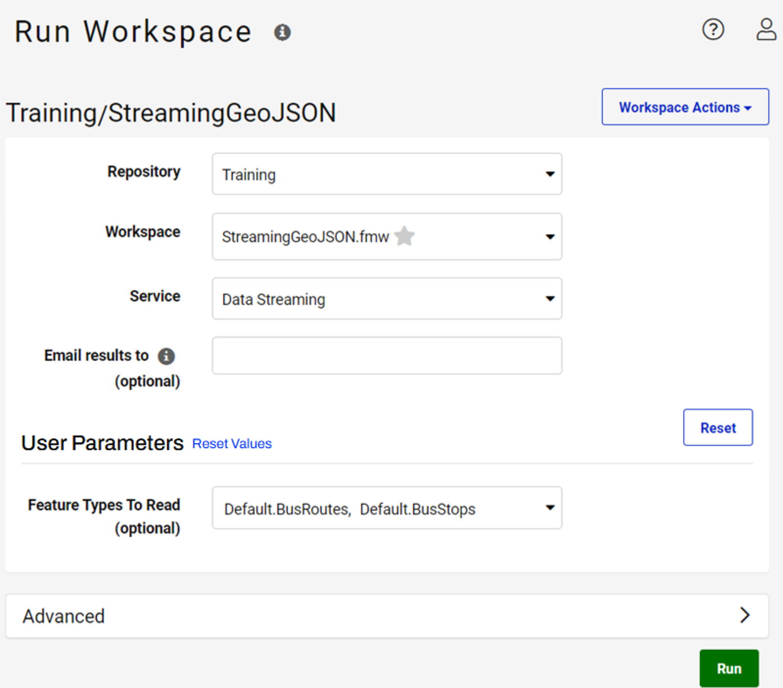

Go to the FME Flow Web Interface and navigate to Run Workspace. Select the repository and workspace you just published. Run the workspace, and the GeoJSON will be returned and download from your browser.
FME Flow will return the GeoJSON MIME type in the response header as well the Content-Type; in this case, application/json.

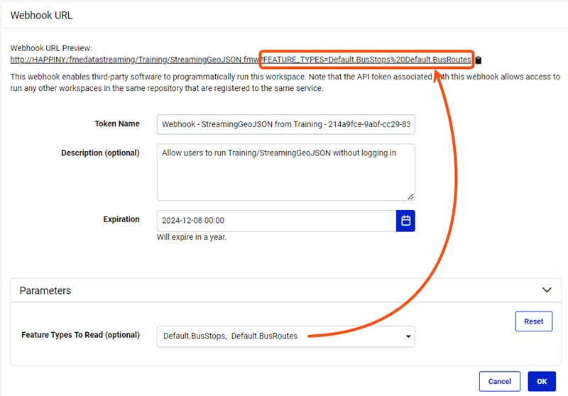

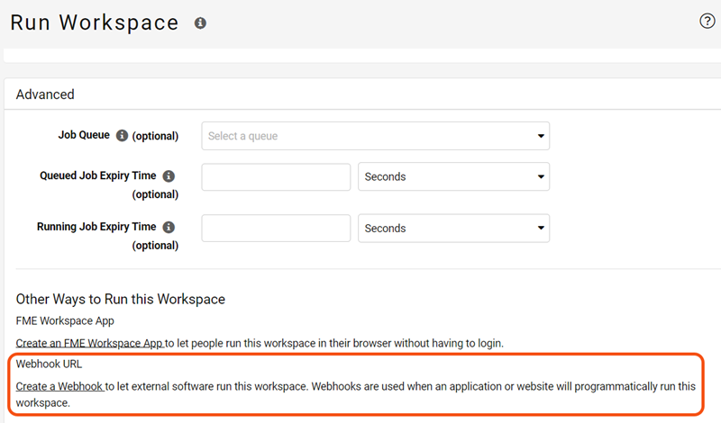

Return to the Run Workspace page and expose the Advanced section. This section includes a link to create a Webhook URL that can be used directly within a web service to request the GeoJSON. Click the link to open a page to configure the Webhook.
5. Configure the Webhook URL
The page that opens will let you create an API Token to allow authenticated access to the Webhook URL. You can configure how long the token will be valid for using the Expiration parameter. If you expand the Parameters section and change the value of the Feature Types to Read parameter, you will see the change reflected in the parameter syntax of the URL.
The Direct URL obtained above can be provided to any client application that consumes GeoJSON. FME Flow will dynamically return the data in GeoJSON when the URL is invoked.
