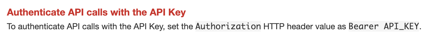

2. Understand the Authentication Method
Understand how the web service wants the application to authenticate. For Yelp they require you to create an API Key and send that to Yelp as a HTTP Header:

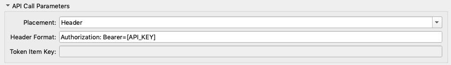

5. Configure the API Call Parameters
As Yelp wants the API Key sent in the header, this needs configuring in the web service definition.
Edit the API Call Parameters so that they match the format that Yelp is expecting.

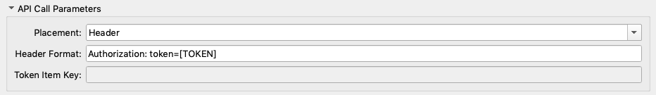

By default, the API Call Parameters will be:
Yelp requires us to change it (see step 2). Ensure that the API_KEY parameter name matches the parameter name specified in step 4:

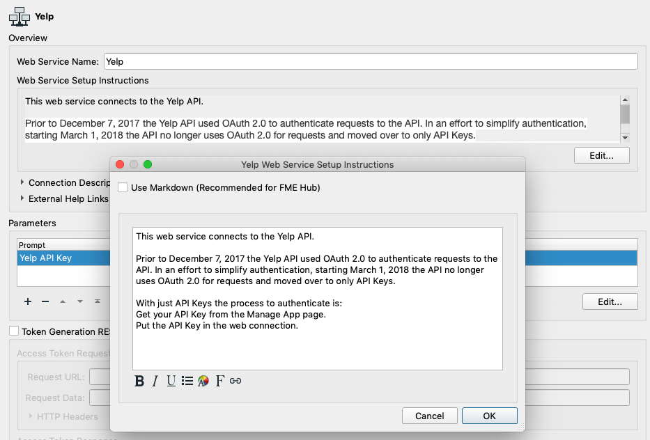

6. Add a Web Service Name, Description and Setup Instructions.
It is best practise to provide information about the web service that the user will be connecting to and add in any documentation or setup urls that the user will need to visit in order to generate their token.
In the case of Yelp, there was a change a few years ago in how they authorized so this might be useful information to include for the user (in case they were using the legacy connection).
