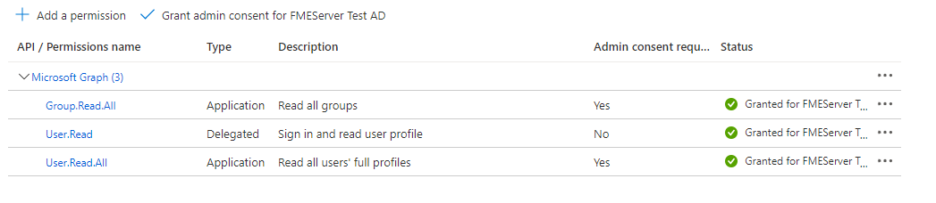

”After creating an Azure AD Connection I am getting an Access Denied error trying to import a User or Group”
In FME Flow you see a toast error message:
Access denied. Ensure that your client ID and secret are correct, and an administrator has granted permissions.
This error typically occurs when FME Flow can reach the Azure AD Tennant but lacks the permissions to import users or groups.
To resolve this error check the ‘Type’ on the permissions for the app. The User.Read Token should be ‘Delegated’ while the others are ‘Application’:
Second, make sure in the FME Flow Web UI  you are using the secret value not the secret ID.
