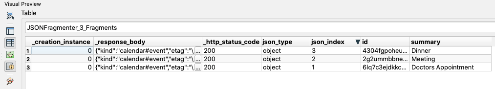

Using a GET request to query information about our calendars, such as events ordered by start time. Here is a sample output:
