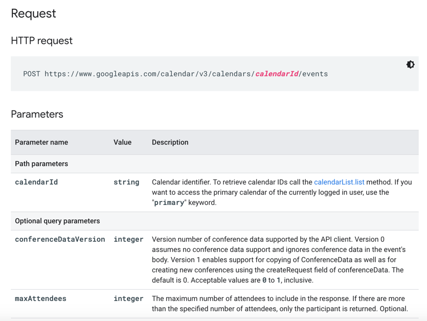

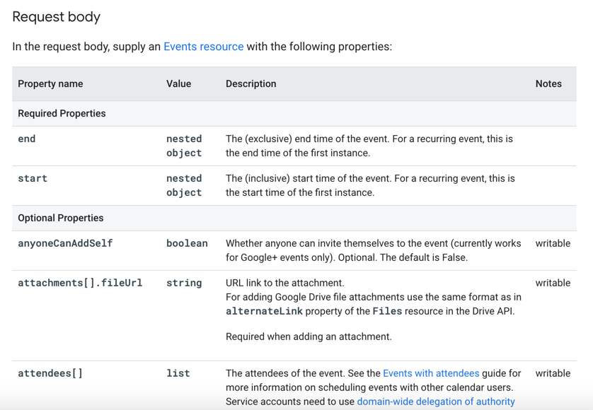

1. Consult the documentation
Find the URL and parameters at the Events: insert page.

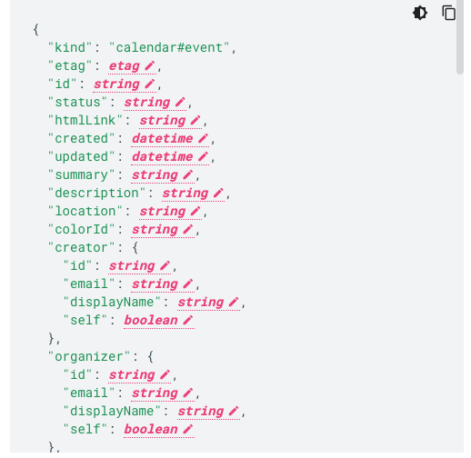

Any information we might want to include about the event is sent in the request body. In this case, the request body is an Events resource JSON body. Included in the documentation is information about the allowed properties.
The Events Resource page supplies a template of an event object that can be copied, pasted and edited in your own requests.

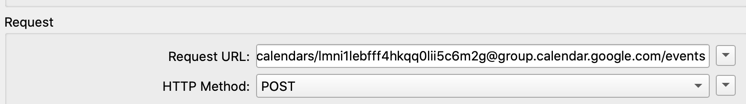

Back in the workspace, first set the HTTPCaller’s HTTP Method to POST. The request URL will also need to be amended to reflect the URL from the documentation. Replace the calendarId path parameter with the target calendar’s “id” value. Remove any query parameters still remaining from previous requests.

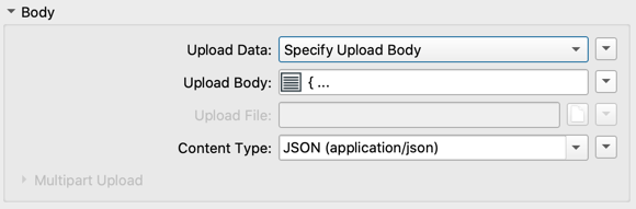

It’s possible to send different types of data with a POST request using the parameters on the HTTPCaller. The data to upload can be string value, a file, or customized combinations. When sending a POST request, a Content-Type header tells the server the type of data contained in the request body. HTTPCaller has a drop-down list of commonly used values and it also can be customized with a text or attribute value.

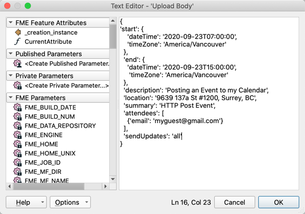

We will type in the properties of our new event, so we can use the “Specify Upload Body” as our Upload Data. The request body, as seen in the example above, is JSON. Specify “JSON (application/json)” as the Content Type header.
The Upload Body is where the event properties are contained. Working off the properties page and example provided by the documentation, fill in the JSON key values with the details of your event. Guests can be added provided they have access to the event.

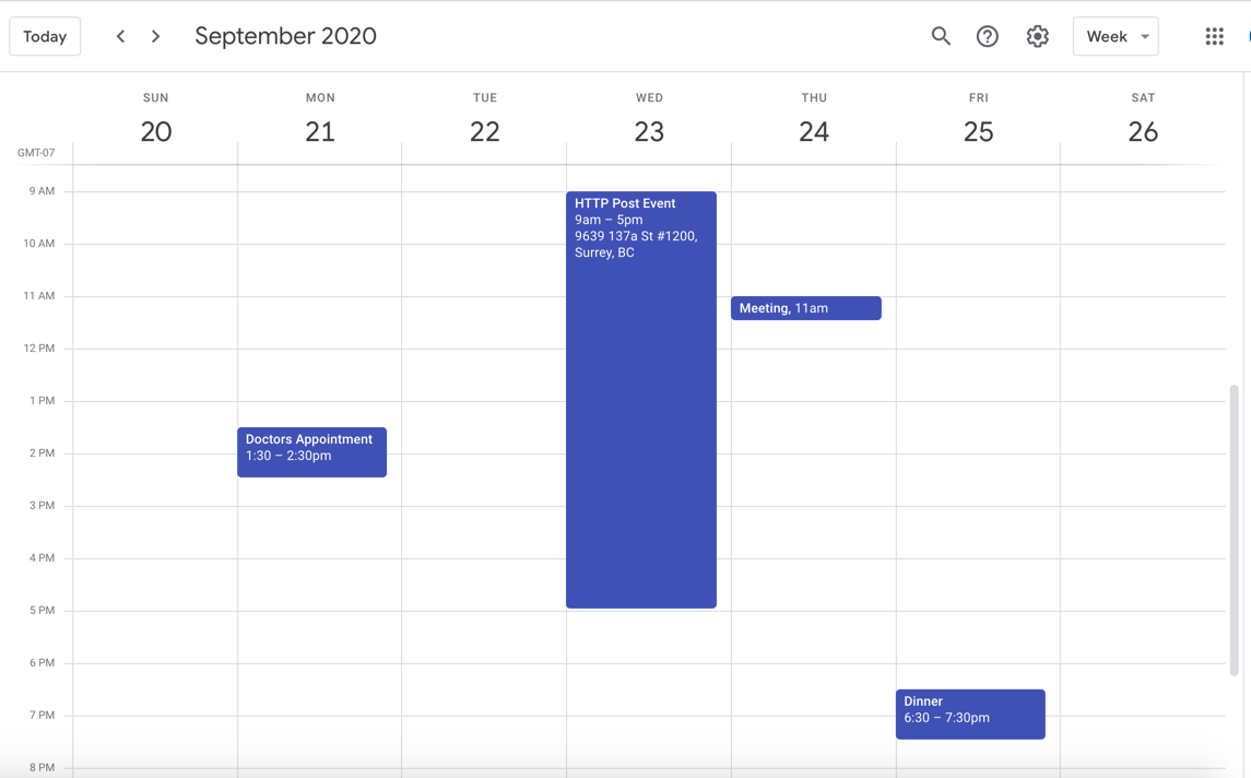

With Feature Caching enabled, run the workspace to the HTTPCaller. Use the green magnifying glass to view the results in Visual Preview. With a successful call, the _response_body will contain the system properties of the new event in addition to those that we sent with the request. Copy the event’s “id” property to your clipboard, we’ll use it in the next request.
4. View the event in the browser.
The API response is proof enough to let us know we’ve created an event, but let's confirm in the browser. Open up your Google Calendar in the browser and find the newly created event. Any changes you make using in the browser will be reflected in future HTTP calls, and vice versa.

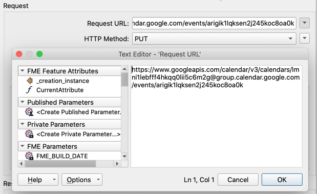

In the HTTPCaller, change the Request Method to PUT. Replace the Request URL with the that from the documentation and replace the path parameters with your calendarId and eventId (from the previous request). When a URL becomes too long to manage in the form, use the drop-down menu to select the Text Editor to construct the parameters.

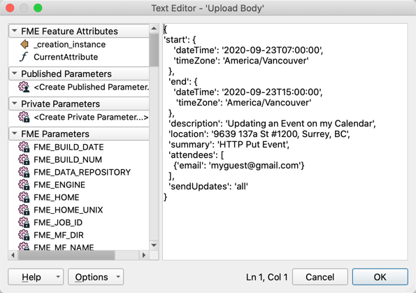

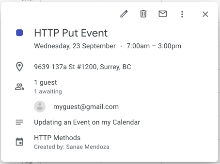

For the Request Body, all existing event properties must be sent with the request, along with our updates. A PUT request replaces the resource at the URL, so any properties that are not included with the request will be lost. In this case, the event ‘start’/‘end’ time will be changed to 7:00 and end at 15:00, 2 hours earlier than the original event. I’ll also change the title and summary for a PUT event.
3. Run the Workspace
A successful request returns the event resource in the response body with updated properties. Checking your calendar, you’ll see it is now scheduled 2 hours earlier. Because we set sendUpdates property to “all”, the attendees will also be notified of the change.

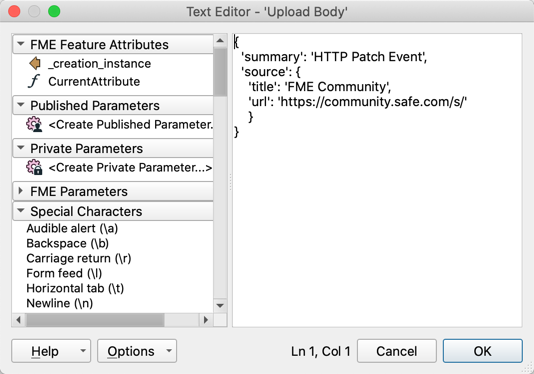

Whereas PUT replaces a resource at a URL, a PATCH request can update individual properties of that resource. The specified properties will be updated with new values, but unspecified properties will remain unchanged. We will change the location, add an external link, and update the title.

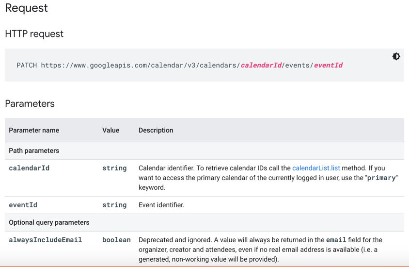

1. Consult the Documentation
Events: Patch is structured similarly to the POST and PATCH documentation.
2. Build the Request

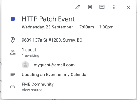

The Request URL remains the same as the previous PUT request. Change the HTTP Method to PATCH. In the Upload Body, delete any properties we are uninterested in updating.
Run the workspace and view the response body or your calendar in the browser. The event will be updated with a new title, location and include a source URL.

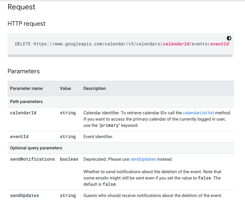

1. Review the Documentation
The resource URL is constructed the same as the PATCH and PUT requests. Below, parameters to accompany the request are listed. Notably, there are no properties for a request body listed for a DELETE request.
