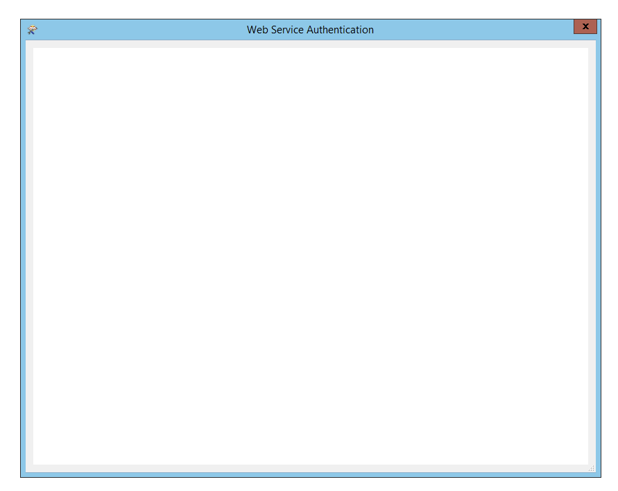

When you attempt to create a new Web Connection for a Google Service, when you select "Authenticate", the "Web Service Authentication" window will remain blank and does not load:
