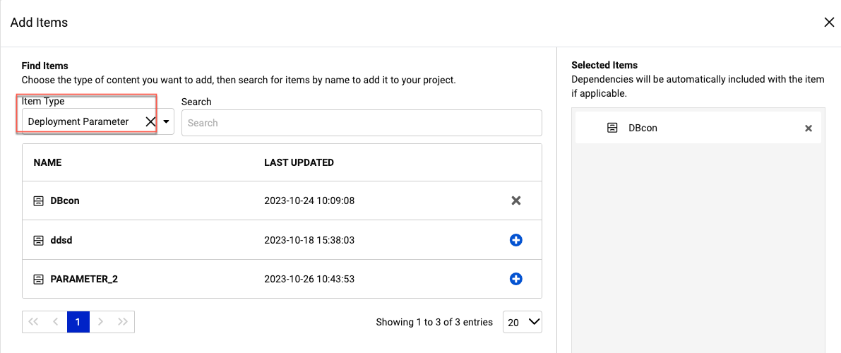

  • Deployment Parameters, another component of the CI/CD workflow, can also be added to a project explicitly.

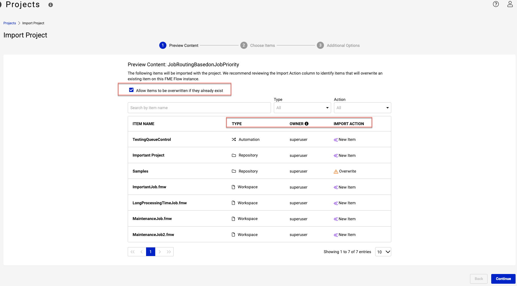

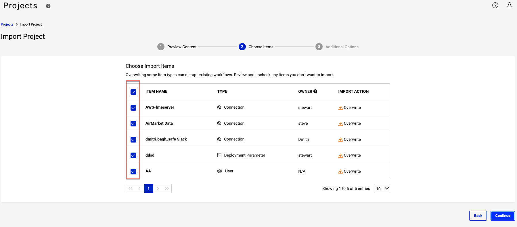

  • The Import Preview page provides visibility and transparency into what changes the import will make to the target Flow instance. We can now see what FME items are a part of a Project, its type and its owner. We can also see if these will be new items on the target Flow instance or if they already exist and will therefore be overwritten by this project import action.
If the items in the project already exist on the system, we can also choose to allow the overwrite or not.
Usually, certain items within the project are specific to the environment [such as any connections, deployment parameters, tokens, or users]. In that case, you can choose to import or exclude them and instead create those items specific to the target Flow instance’s environment.
Although the primary objective of CI/CD is to reduce manual inspections and procedures, it serves as an excellent tool for initially assessing the extent of the import action.

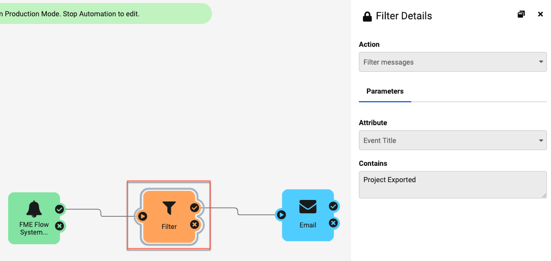

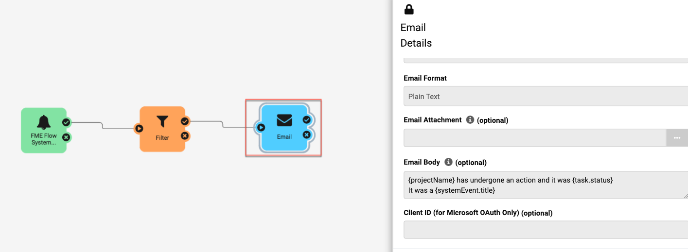

  • Using Automation
In addition to the above configuration, if you only want to setup notification for specific scenarios such as –
  • For certain export/import jobs,
  • Only if the job was successful or failed
  • Only if the action was project import or project export
– we can use Flow Automation to filter out the Project attributes such as Project Name [<ProjectName>], Status [SUCCESS/FAILURE], Event.title [Project Exported/Project Imported] etc and trigger emails as required.
A simple example would be as shown below, with an FME Flow System Event (received) trigger, Filter for Event Title “Project Exported” and external action Email (send)

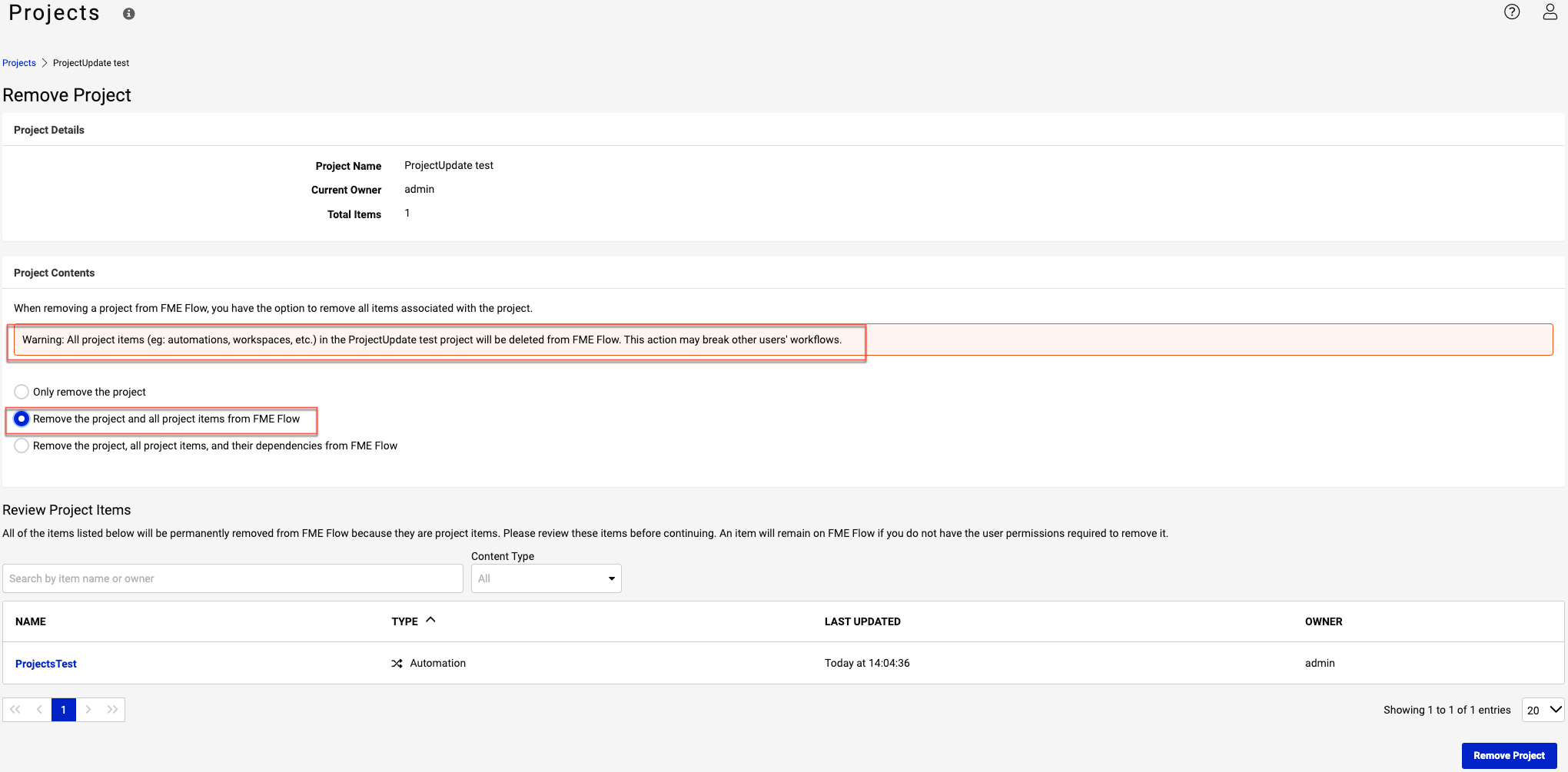

Removing Projects / Rolling back
In some cases, you may need to revert an import after deploying a newer version of the project. It might become necessary to restore the previous version of the project, potentially due to a test that did not succeed.
There are different options that you can select while removing a project- Removing the project only, removing the project with project items or removing the project with project items and dependencies. Please note that if we remove an updated project and you choose to remove all project items from FME Flow,  it will not revert back to the original project or item version and they will be deleted from the instance. Alternatively, If you choose to only remove the updated project from FME Flow but keep the project items that were a part of it, it will delete the project from the instance but keep the current version of the items.
Hence, it is advisable to maintain backups of the project's previous versions, so you have the option to remove the current project and then restore the previous version of the project to return it to its original state.
