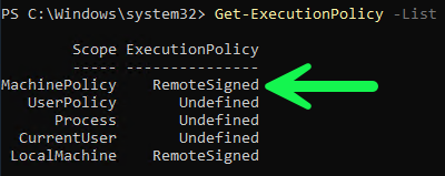

You can check the PowerShell execution policy with the following command in PowerShell:
Get-ExecutionPolicy -List
The scopes are listed in order of precedence. In the example below, since there is a MachinePolicy set, it overrides the policy of the LocalMachine policy.

Change the PowerShell execution policy to RemoteSigned and retry the installation. If there is no policy defined above the LocalMachine scope, you can use the following command in PowerShell:
Set-ExecutionPolicy -ExecutionPolicy RemoteSigned -Scope LocalMachine
However, if there is an AllSigned execution policy set at the MachinePolicy or UserPolicy level as shown in the earlier example, then you will need to make the change via a Windows Group Policy change. The policy can be found in the Local Group Policy Editor under Computer Configuration > Administrative Templates > Windows Components > Windows PowerShell > Turn on Script Execution.

The change should then be reflected in PowerShell.
RemoteSigned
