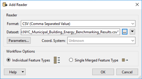

1. Open a Blank Workspace
In FME Workbench, open a blank workspace. Add a CSV (Comma Separated Value) reader to the canvas and browse to the NYC_Municipal_Building_Energy_Benchmarking_Results.csv dataset that is available in the Files section of this article.

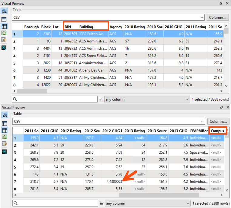

Before we begin, we should run the workspace with Feature Caching enabled and inspect the data in Visual Preview to see what attributes to modify.
Ensure Feature Caching is enabled by clicking the drop-down arrow next to the run button. After confirming Feature Caching is enabled, click Run.
View the data in Visual Preview. There are a few attribute modifications that we will be making, as well as some others that we might discover while working through the updates.
  • Move BIN and Building to the beginning
  • Remove Campus
  • Fix the number of decimal places for 2012 GHG Emissions Intensity (kgCO2e/ft2)
  • Add a DateMigrated attribute
  • Review the data types and update as needed (FME 2023.0 and newer)

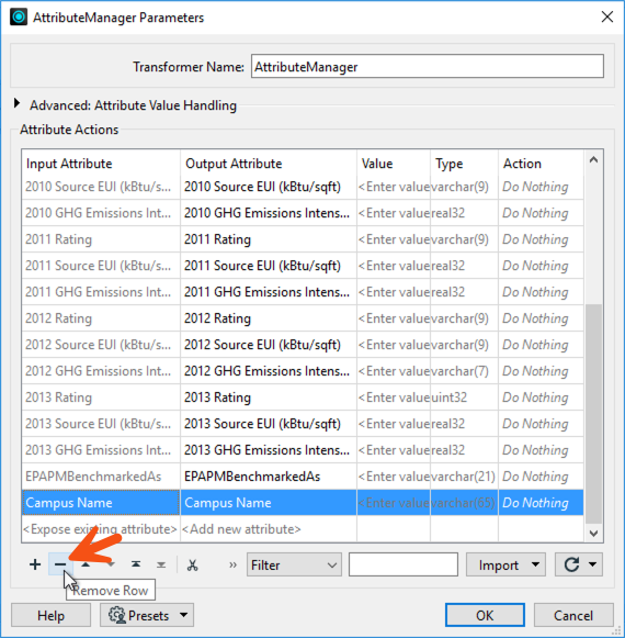

3. Add an AttributeManager - Remove Attribute

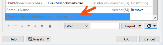

Add an AttributeManager transformer to the canvas and connect it to the CSV reader feature type. In the parameters, the first change we will make is to remove the Campus attribute, as it is not needed. Scroll down to the bottom of the AttributeManager, click on Campus to select it, then click on the negative (-) button at the bottom to remove the attribute.
After removing an attribute, the Action column will update from Do Nothing to Remove.
To bring back an attribute, click on Remove and select Do Nothing.

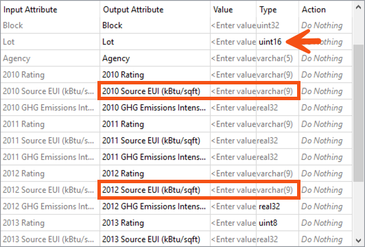

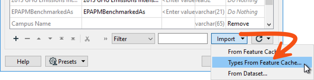

The Type field in the AttributeManager is auto-populated with the data types from the original dataset, which can be seen in the reader. If the data type is unassigned from the original data, FME will assume a character string with a maximum length of 200.
FME can review the data in the Feature Cache and select a data type that best fits the data. To do this, click the Import button and select Types From Feature Cache.
In the Import Types from Feature Cache dialog, click Select All, then click Import. There are additional Attribute Type Handling parameters, please see the documentation for more information.
The (data) Types that were updated are now shown in black. This can also be looked at as a form of data validation in that we can see that the Source EUI Types are still set to varchar, which indicates that there is something in the data that isn’t numeric. Let’s look at the data in Visual Preview to see if we can determine why. Click OK to save our changes so far and close the AttributeManager.

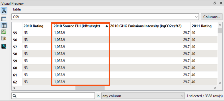

6. Inspect Source EUI
Inspect the CSV reader feature type cache again to view the data in Visual Preview. Reviewing the data, a comma separates the thousands' place in the data, causing it to be classified as varchar. We need to remove the comma as we want the data to be real32.

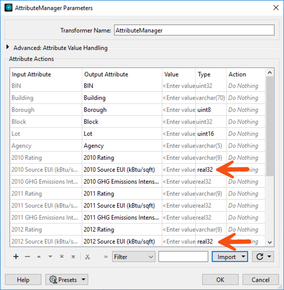

8. Re-Import Types
Run the workspace to the StringReplacer to update the Feature Caches, then open the AttributeManager. With the commas removed from the two attributes, we can re-import the (data) Types to see if the data is now real32.
Click on the Import button and select Types from Feature Caches. The 2010 Source EUI and 2012 Source EUI should now be real32.
Note: If you replaced the strings in the AttributeManager instead of the StringReplacer, the Type field for 2010 Source EUI (kBtu/sqft) and 2012 Source EUI (kBtu/sqft) will need to be manually updated to real32. This is because the AttributeManager cannot read its own feature caches, it can only read the previous feature cache.

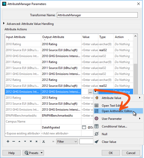

10. Round Attribute Values

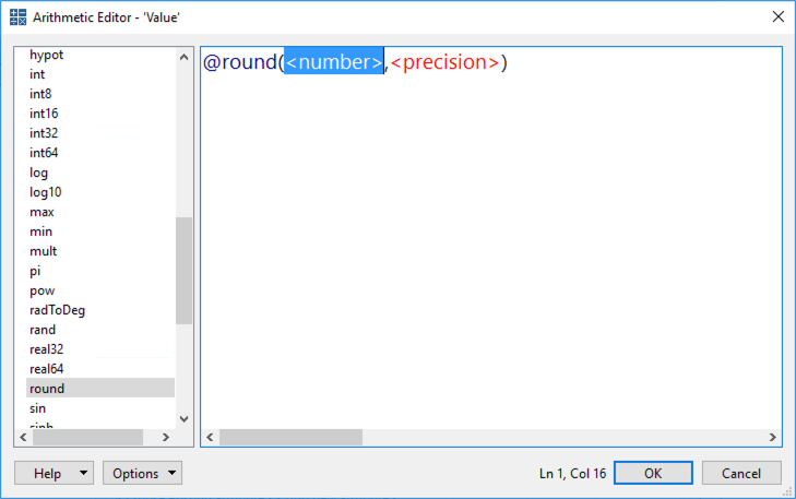

When we first inspected the data, we noted that the 2011 GHG Emissions wasn’t rounded to 1 decimal point, which can be fixed in the AttributeManager. Click in the Value box next to 2011 GHG Emissions to show the drop-down arrow. Click on the drop-down arrow, then select Arithmetic Editor.
In the Arithmetic Editor, on the side, expand Math Functions, then double-click on round to add it to the editor.
The @round() function requires a <number> which in this case will be the value of 2012 GHG Emissions, and <precision> which is the number of decimal places, which we will set to 1.
To add the 2012 GHG Emissions attribute value, on the side, expand FME Feature Attributes and double-click on 2012 GHG Emissions. As long as <number> was highlighted, the @Value(2012 GHG Emissions…) attribute value will be added to the correct spot. Now highlight all of <precision> and type in 1. Click OK to close the Arithmetic Editor.
@round(@Value(2012 GHG Emissions Intensity (kgCO2e/ft2)),1)

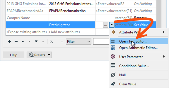

The final step is to create a new attribute to contain the date that this information was added to the output dataset (database, excel spreadsheet, etc.). At the bottom of the AttributeManager, click in the <Add new attribute> box and type in DateMigrated.
We will use the date that the workspace is run as the value. In the Value box for the newly created DateMigrated attribute, either click on the ellipsis or click on the drop-down and select Text Editor to open the Text Editor dialog.
On the side, expand Date/Time Functions and double-click on DateTimeFormat to add it. If we only did DateTimeNow, the formatting would be in Local Unzoned and would not be very readable. Add DateTimeNow to the <datetime> parameter of the DateTimeFormat function. Next, for <format> enter in the following:
%Y%m%d%H%M
The output date will be 202306081604 (Year, Month, Day, Hour, Minute). If you would like seconds, add %S at the end. Click OK to close the Text Editor.
@DateTimeFormat(@DateTimeNow(),%Y%m%d%H%M)
Set the DateMigrated Type to datetime, and then click OK to close the AttributeManager.
