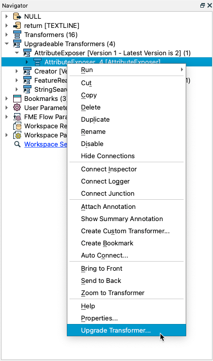

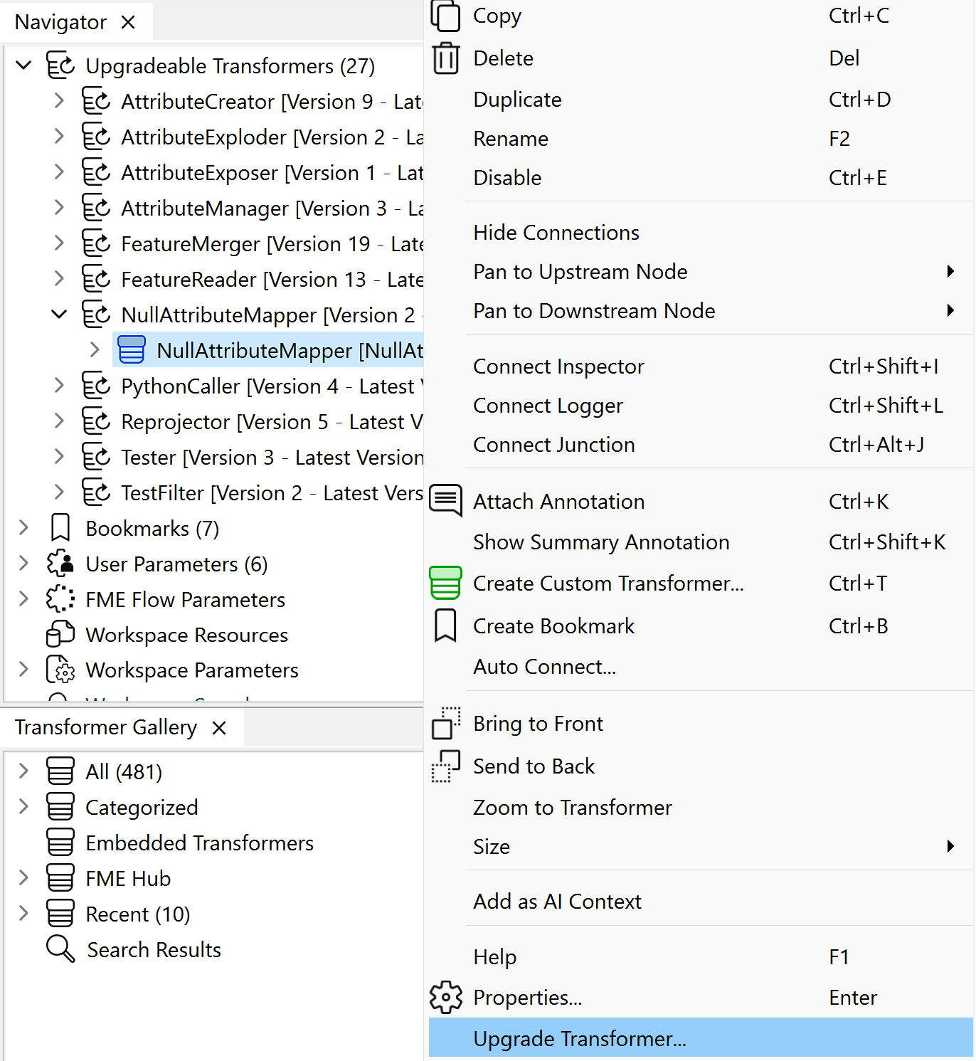

Whenever you upgrade to a newer version of FME, you can open a workspace and look for a section of the Navigator window labeled Upgradable Transformers.

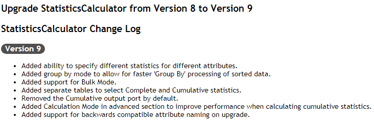

These are optional upgrades that you can apply to a transformer. You should check the changelog for the transformer (available when you carry out the upgrade or right-clicking the transformer upgrade icon and selecting 'Show Changes') to see if there are any changes that might affect the results of the transformer.
In general, if the changelog includes the phrase:
Added support for Bulk Mode
...then you should get a decent improvement in performance.
There are many other updates to a transformer, and you should check these to ensure they won't interfere with your expected results.
What's even better is that the performance benefit might even extend beyond a particular transformer, to the rest of the workspace. That's because a transformer that doesn't support Bulk Mode can cause the rest of the workspace to revert to an older, less efficient method of processing.
So upgrading one transformer to support bulk mode can cause all subsequent transformers to start operating in bulk mode too!
