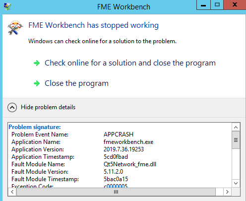

You may come across the following error when starting up FME Workbench or FME Data Inspector or running a workspace. This error may occur after installing a new version/build of FME on your machine. If you encounter this error when running a workspace, please refer to this article to narrow down the issue.
The faulting module may mention Qt, which is the library FME graphical user interface (GUI) is based on but this may not be the faulting module. See below for a screenshot of an example dialog on Windows.

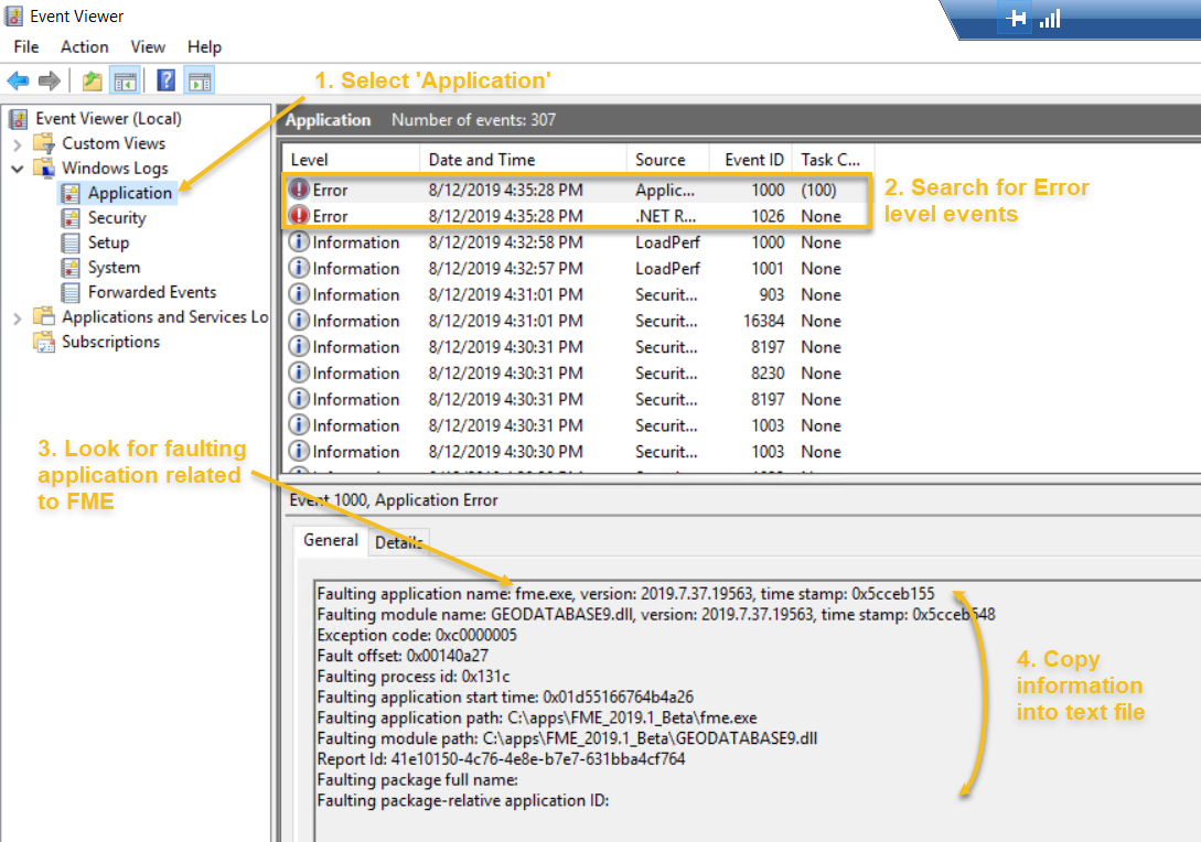

1. Windows Event Viewer
Launch the Windows Event Viewer. Go to the Start menu (Windows key or select Windows icon on the bottom left of the screen), type “Event Viewer” into the search box, and click the result. This should open the Event Viewer application.
Select Application under Windows Logs on the event viewer dialog on the left and search for Error level events relating to fme.exe, fmeworkbench.exe, or fmedatainspector.exe. You can also narrow the number of events to look through by looking at the date and time of events.
Once you have found the event log relating to the FME crash, please select the General tab and copy the information into a text file and save.

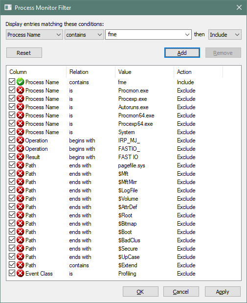

Extract and open Process Monitor. You'll notice events scrolling by; press CTRL+E to stop the capture, and CTRL+X to clear the screen. Next, press CTRL+L to open the Filter window and if possible click the Reset button. Then add the following four filters:
1. Process Name 2. contains 3. fme then 4. Include
The final result should look like this:
Click OK. Next, open Workbench and open the workspace that is failing. Start Process Monitor capturing (CTRL+E) and start the workspace.
