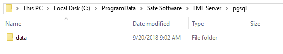

You can confirm that this is the issue by navigating to <filesystemshare>\Safe Software\FME Server\pgsql and checking the Date Modified for the data folder or any of the contents within that folder. If any of those dates are earlier than the new installation date then elements of that folder were left behind during the uninstall process and were not rewritten during the new install causing the mismatch in database schema.

  3. Review the pgsql subfolder and if the data folder is still present, delete it. pgsql.png
