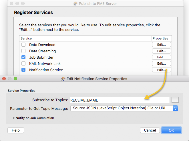

In order to be able to run this workspace using the notification service, we first need to publish it up to FME Server. When publishing the workspace, we have to set the topic to which it will be subscribed and specify which reader will receive the JSON file.
Go to File > Publish to FME Server. Connect to your server, and under the Register Services window check the Notification Service.
Publish the Workspace, registering it to the Notification Service

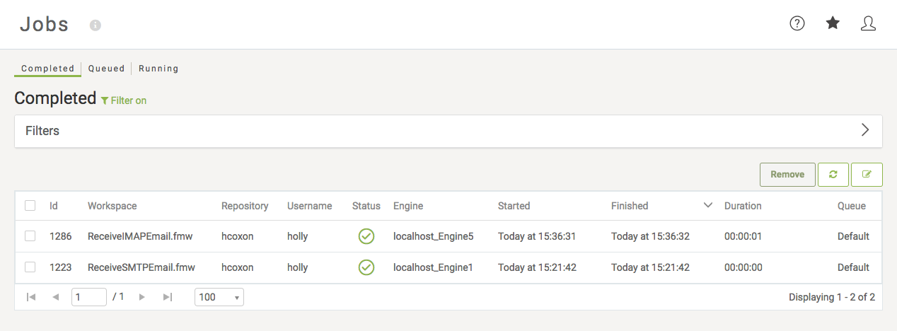

To test if you have successfully set up the Subscription via registration to the Notification Service, simply send an email to the account you configured in the previous section of this tutorial series. As a reminder for SMTP this will by myusername@myserver.mydomain and for IMAP this is your own external mail account. This should cause the workspace to run, to confirm this you review Job History under Jobs > Completed.
Jobs triggered by the Notification Service list in the Completed Jobs page
Click on the Workspace Name to view the log. Review the log to find the list of attributes stored by the logger, including email subject, content, from and to address.

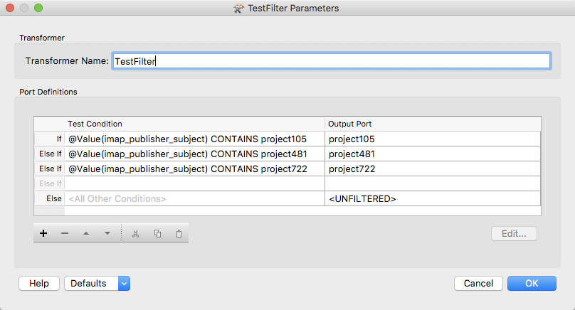

If you need to take different actions based on the subject of the email - perhaps you are accepting files for different projects - you can filter and route emails to different sub-workspaces. This technique works well if you've set up regex-based subject filtering in the previous section.
If you would like to know more about this option, check out the other sample workspace provided in this tutorial which demonstrates how to use a TestFilter to route emails with three potential different project names in the subject line (FilterBySubject.fmwt).
Use the ‘Contains’ operation to test the email subject based on publisher filter

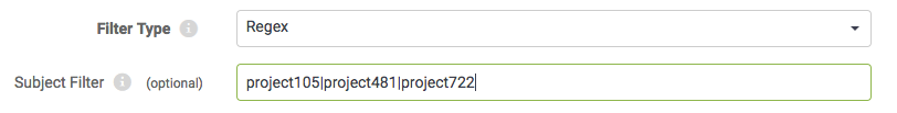

To set this up correctly, you will also have to return to your IMAP email publication in FME Server and set the Filter Type to Regex and then set the Subject Filter to:
project105|project481|project772
IMAP publication set filter type to regex

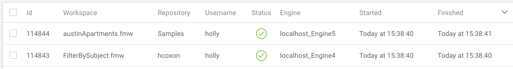

  5. Return to the FME Server Web UI and go to the Completed Job History page to check both the FilterbySubject.fmw and the austinApartments.fmw workspace was run.
Email watch topic triggers FilterbySubject.fmw

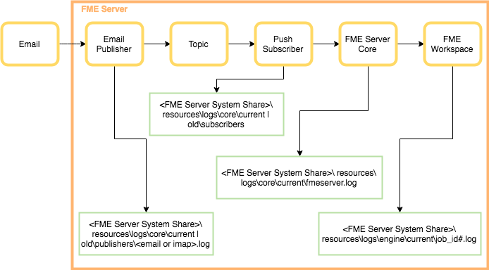

If your newly configured notification set up is not working as expected you can use FME Server's log files to help narrow down the problem. The diagram below shows how an email flows through each FME Server component and which log files are updated at each point. Check these messages and timestamps in these files to confirm that the email is reaching each component.
