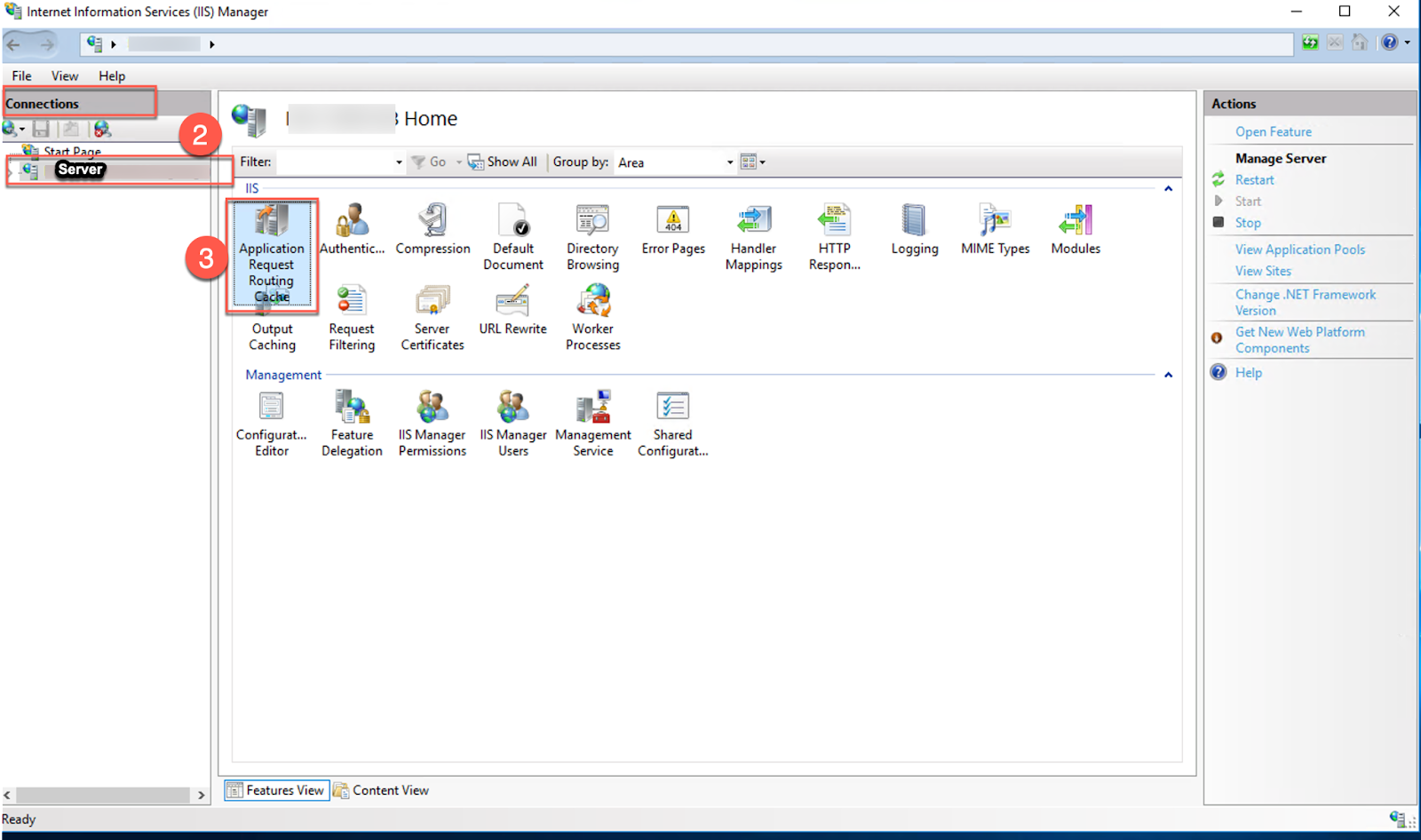

  1. In IIS Manager, connect to the IIS server [in this case, localhost].
  2. Highlight the server in the "Connections" pane.

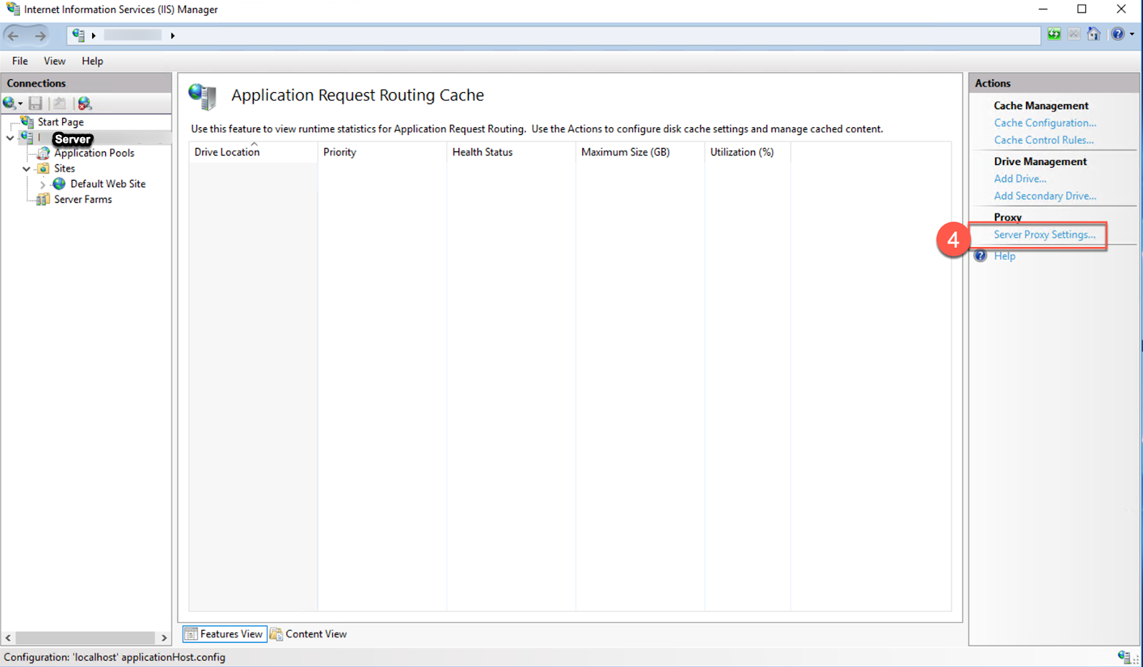

  3. Double-click "Application Request Routing Cache".

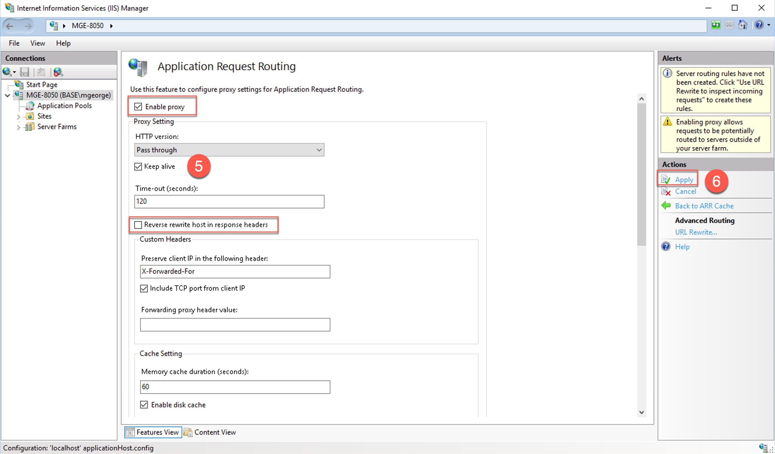

  4. Click "Server Proxy Settings" under the "Proxy" heading in the "Actions" panel.
  5. Tick the "Enable proxy" checkbox, untick the option “Reverse rewrite host in response headers” [it would be ticked by default] and leave the default values in place.
  6. Click Apply.
  7. Optionally change the "Time-out (seconds)" to an appropriate value (see note below).

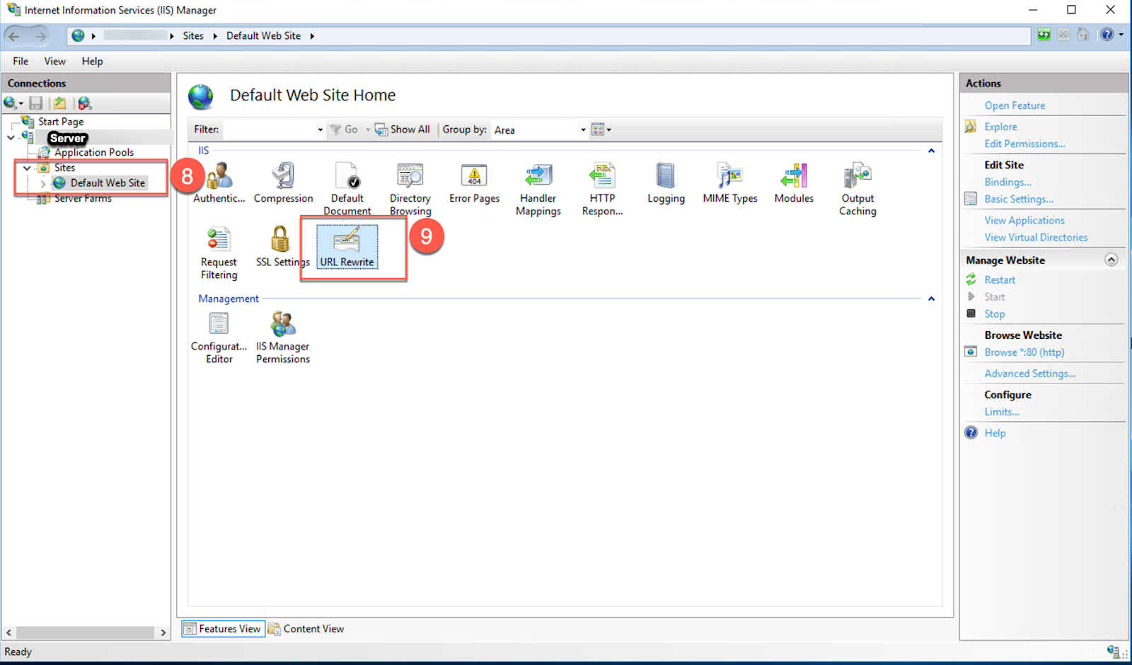

  8. In the "Connections" pane, under "Sites", highlight the "Default Web Site." (The Default Web Site may be disabled for security reasons. In this case, you will need to configure a new website on port 8080).
  9. Double-click the "URL Rewrite" feature.

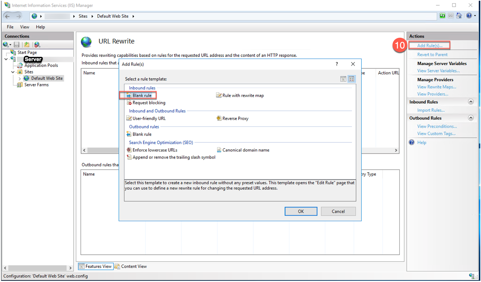

  10. Click "Add Rule(s)..." in the "Actions" pane.
  11. Select Inbound Blank Rule then click OK

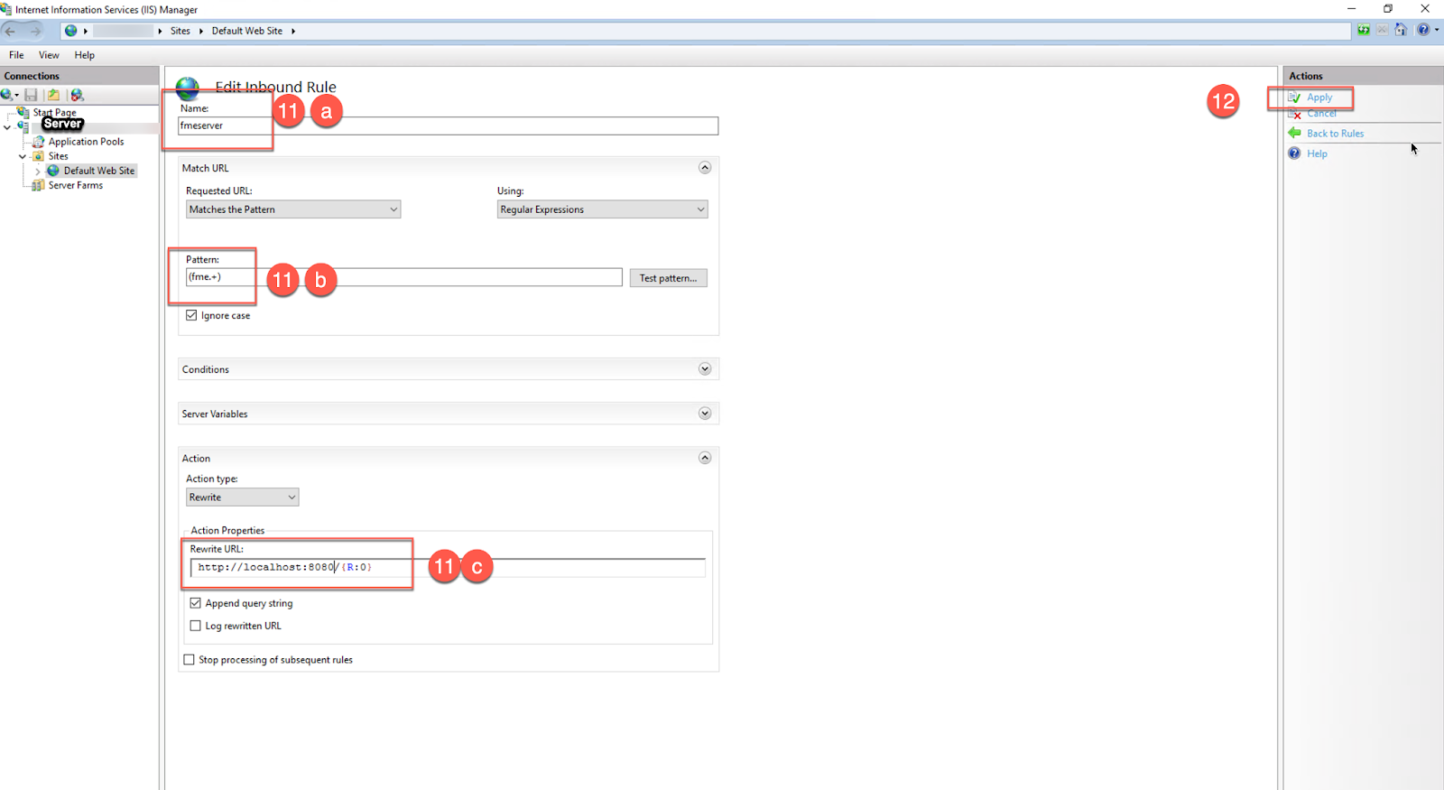

In the the Edit Inbound Rule dialog, fill out the following fields:
a. Name: fmeserver
b. Match URL > Pattern: (fme.+)
c. Action>Action Properties> Rewrite URL: http://<host>:<port>/{R:0} (e.g. http://localhost:8080/{R:0})
  1. Apply the rule changes.

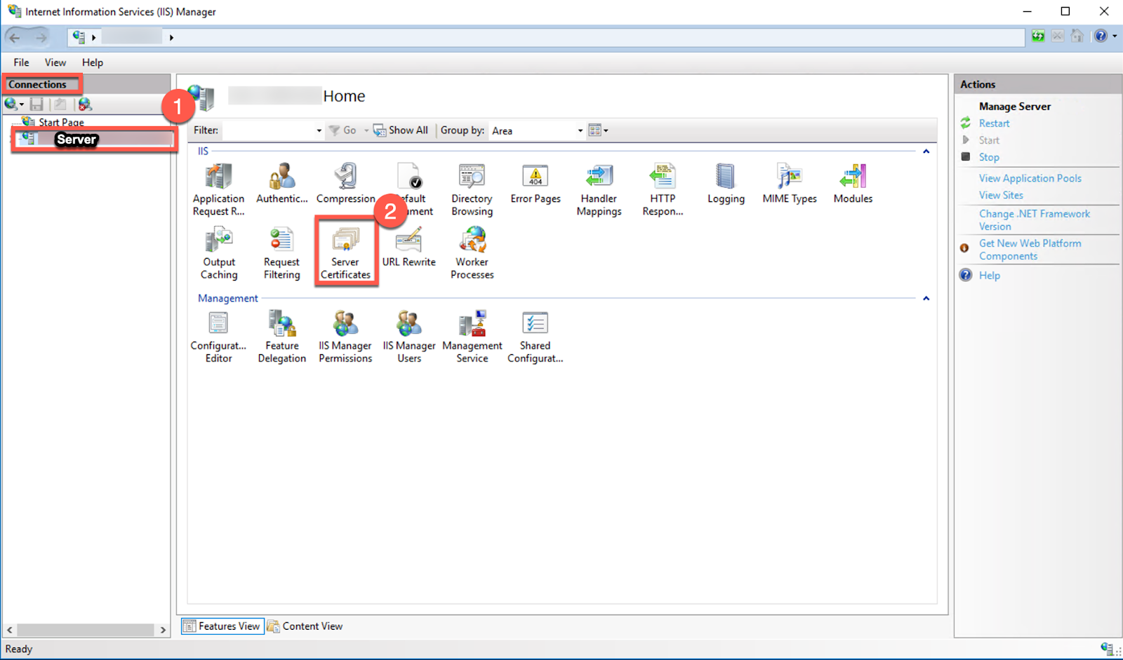

  1. Open IIS Manager and click on the server listed under the “Connections” pane.
  2. Under the server homepage, double-click the “Server Certificates” feature.
  3. Under Actions select ‘Create Self-Signed Certificate…’
  4. Fill in the required fields; specify a cert name and leave the Certificate store as “Personal”.
  5. Select OK.

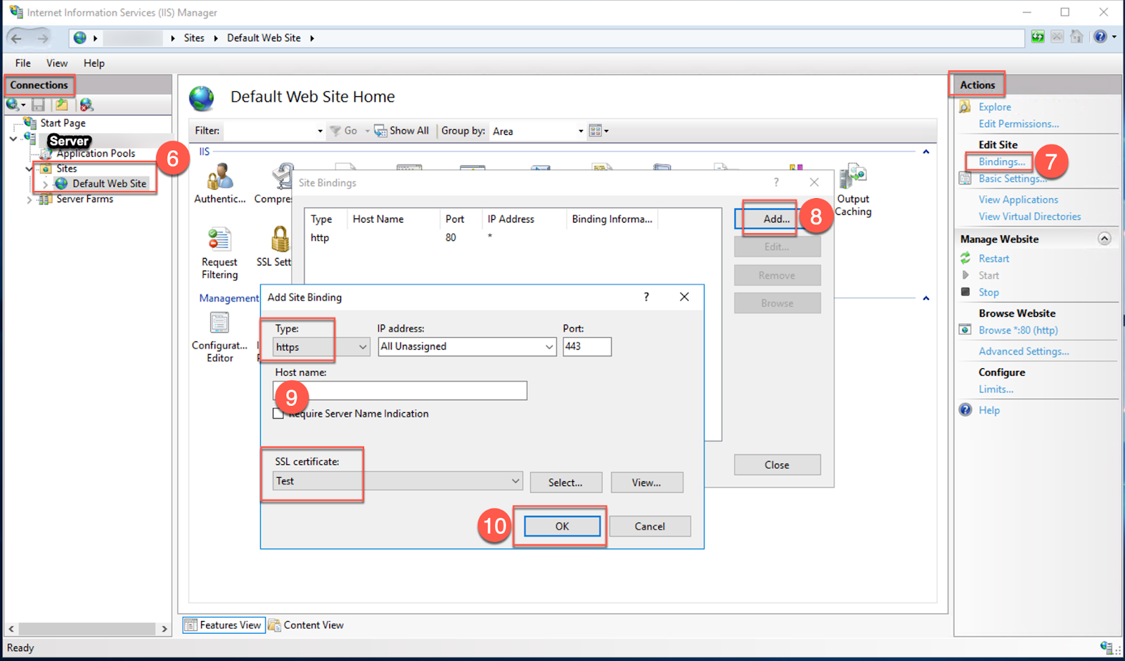

  6. Under the “Connections” pane, select ‘Default Web Site’ under Sites.
  7. Under Actions click on ‘Bindings…’
  8. Click ‘Add…’
  9. Change the Type to https. This will reveal a new parameter where you can select the certificate you created in the previous steps.
  10. Click “OK” .

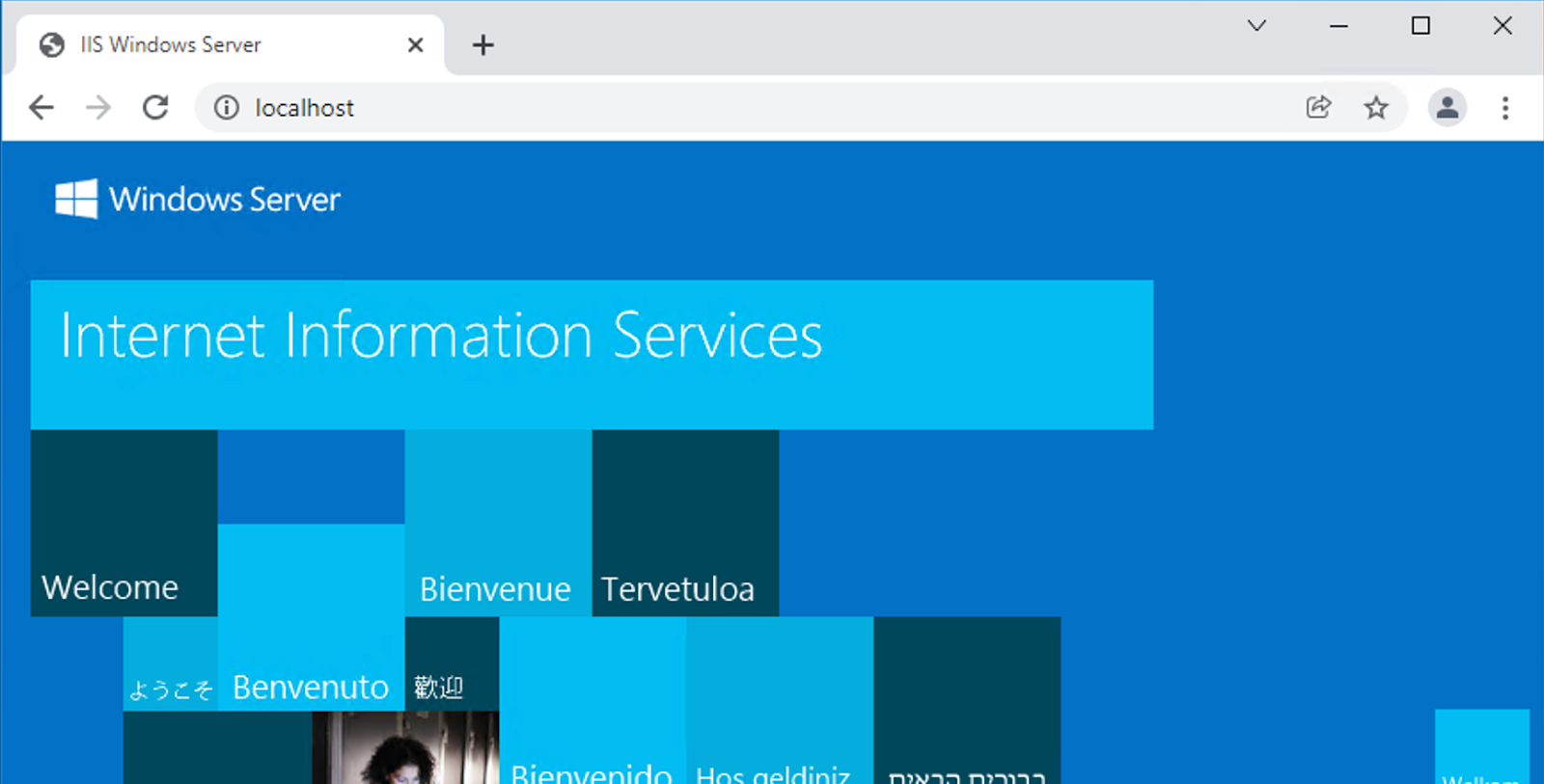

  1. Check the IIS web server
    Go to http://localhost [use https instead of http if SSL is configured] on the server itself. On a new installation, an IIS splash screen will be displayed if the web server is configured correctly.

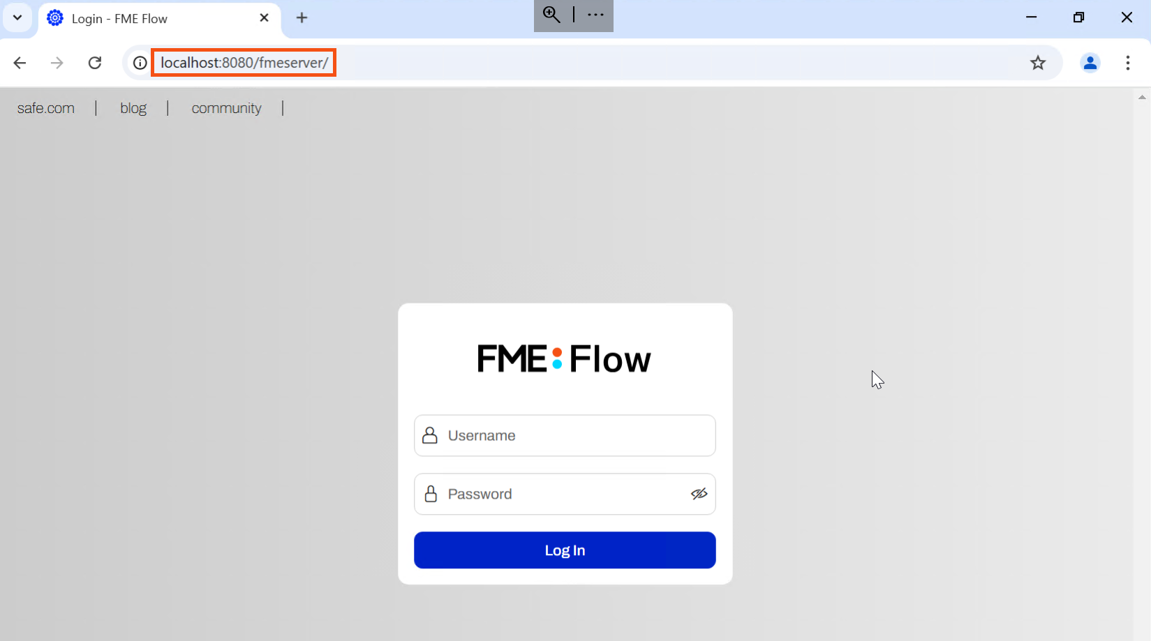

Go to http://<host>:<FME-Web-App-Server-port> or http://localhost:<FME-Web-App-Server-port> [use https instead of http if SSL is configured] on the server itself. In this tutorial, port 8080 was used. This should redirect to /fmeserver (i.e. the FME Flow Web Interface) if IIS has been correctly configured as the reverse proxy for FME Flow.

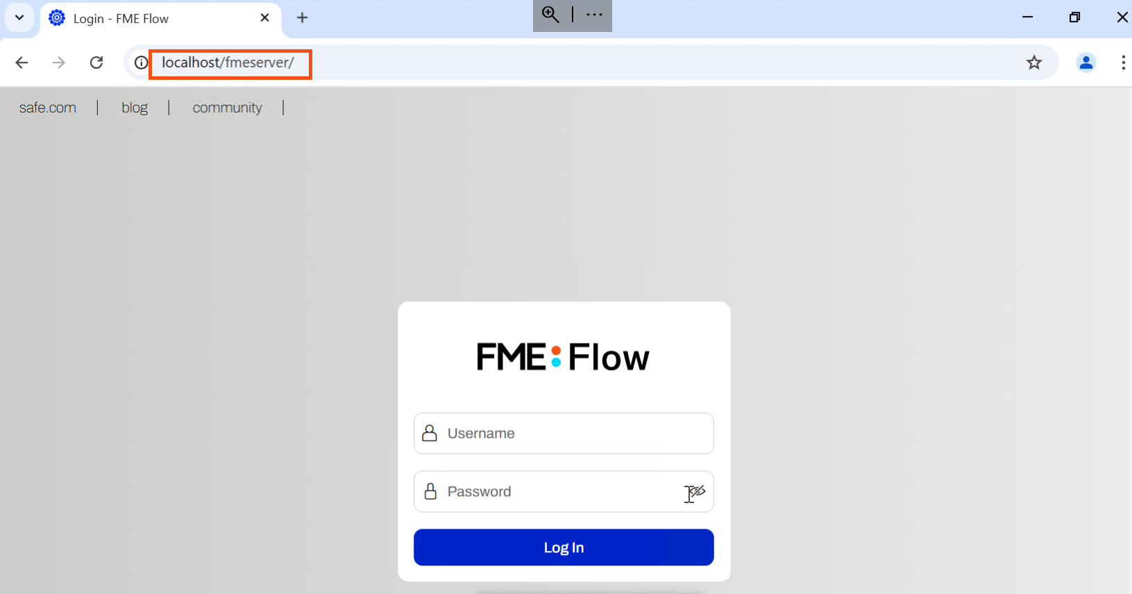

If FME Flow is working, you can now check whether the forwarding is happening correctly. Go to http://localhost/fmeserver [use https instead of http if SSL is configured] on the server itself (or any servlet starting with "fme") and you should see the same FME Flow web interface as shown above.

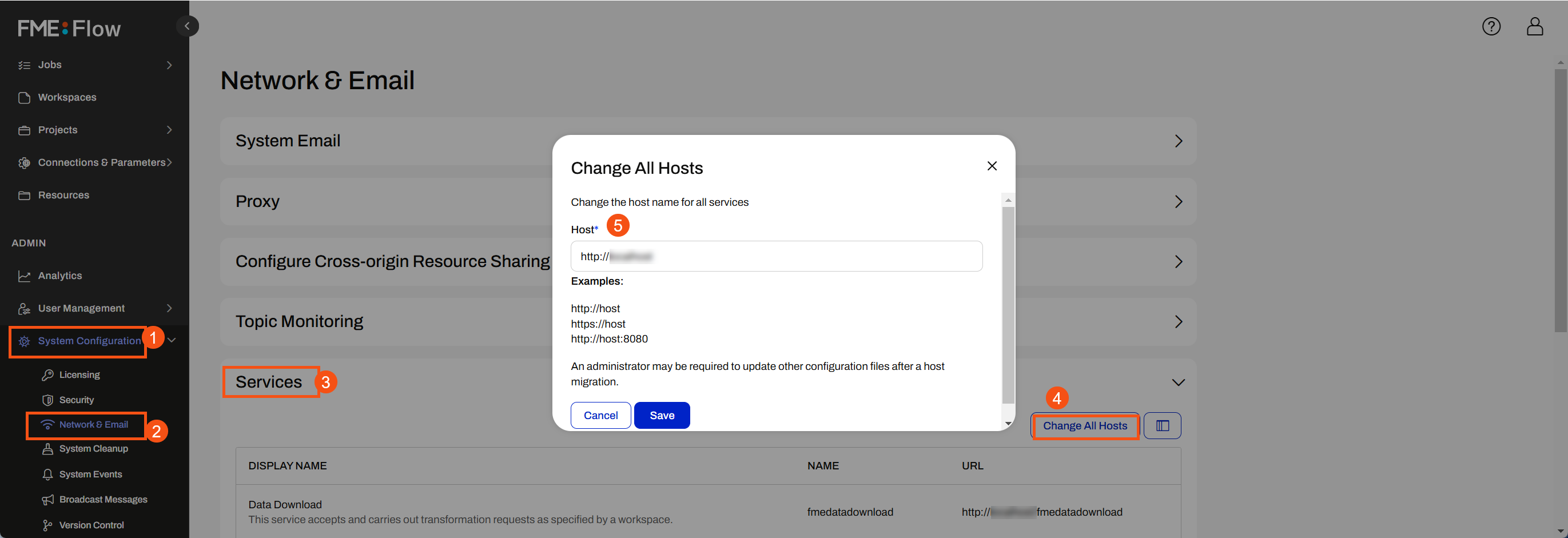

FME Flow's Web User Interface uses various service URLs when submitting requests to each service. These service URLs must be updated to use the hostname of the reverse proxy:
  1. Log in to FME Flow under an admin account.
  2. Locate Services under Admin > System Configuration > Network & Email.
  3. Expand the “Services” section.
  4. Click the “Change All Hosts” button.
  5. Update the hostname for all Service URLs to use the hostname of the reverse proxy.

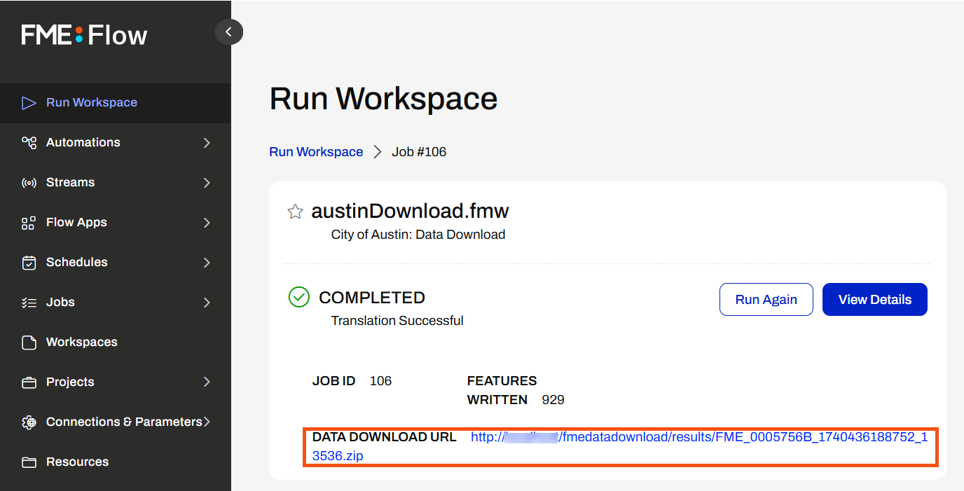

  • Similarly, confirm that FME Flow can run the workspace with Service: Data Streaming
  • Confirm that FME Flow can run the workspace with Service: Data Download
  1. On the Run Workspace page, specify:
a. Repository: Samples
b. Workspace: austinDownload.fmw
c. Service: Data Download
  1. Click Run and upon job completion, click the “Data Download URL” to download the result. Ensure that the URL uses the reverse proxy hostname.

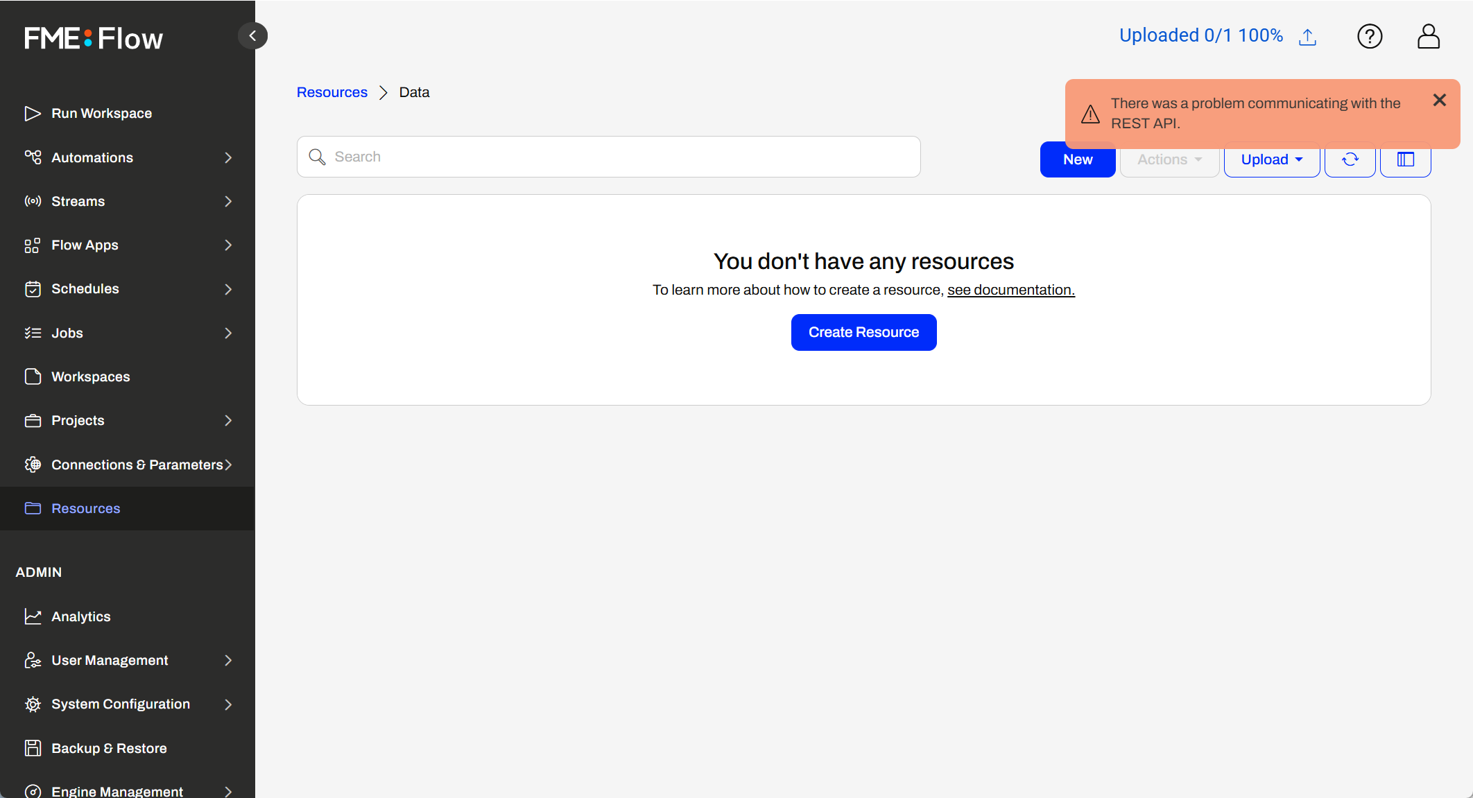

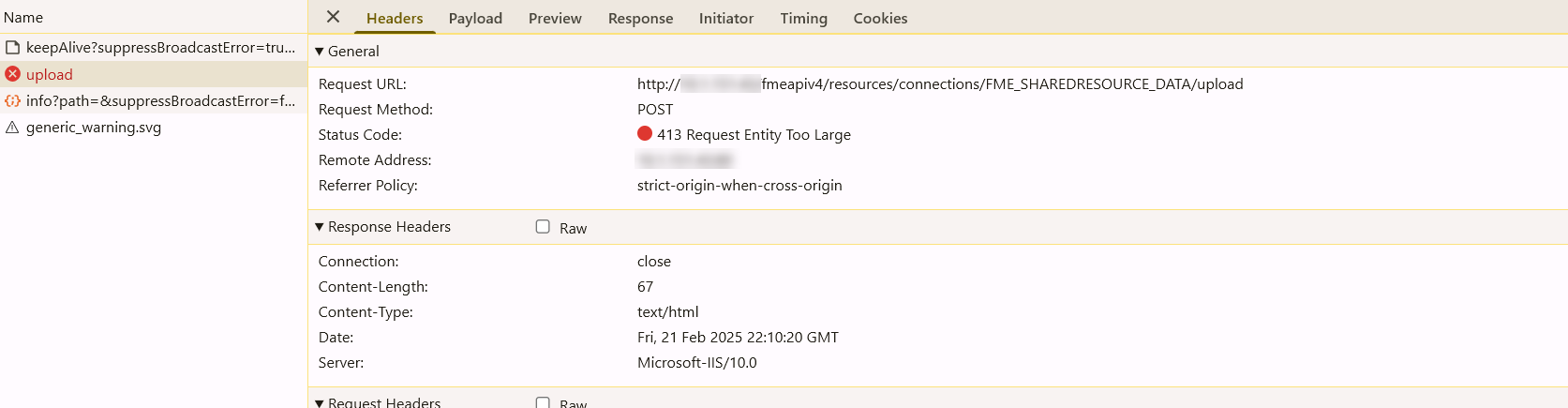

By default, IIS sets the maximum allowed upload size to 30MB. If users of your FME Flow installation have trouble uploading large files, they may see the following symptoms:
  • A "There was a problem communicating with the REST API" error when uploading large files.
  • A "413 Request Entity Too Large" HTTP error in the developer console.

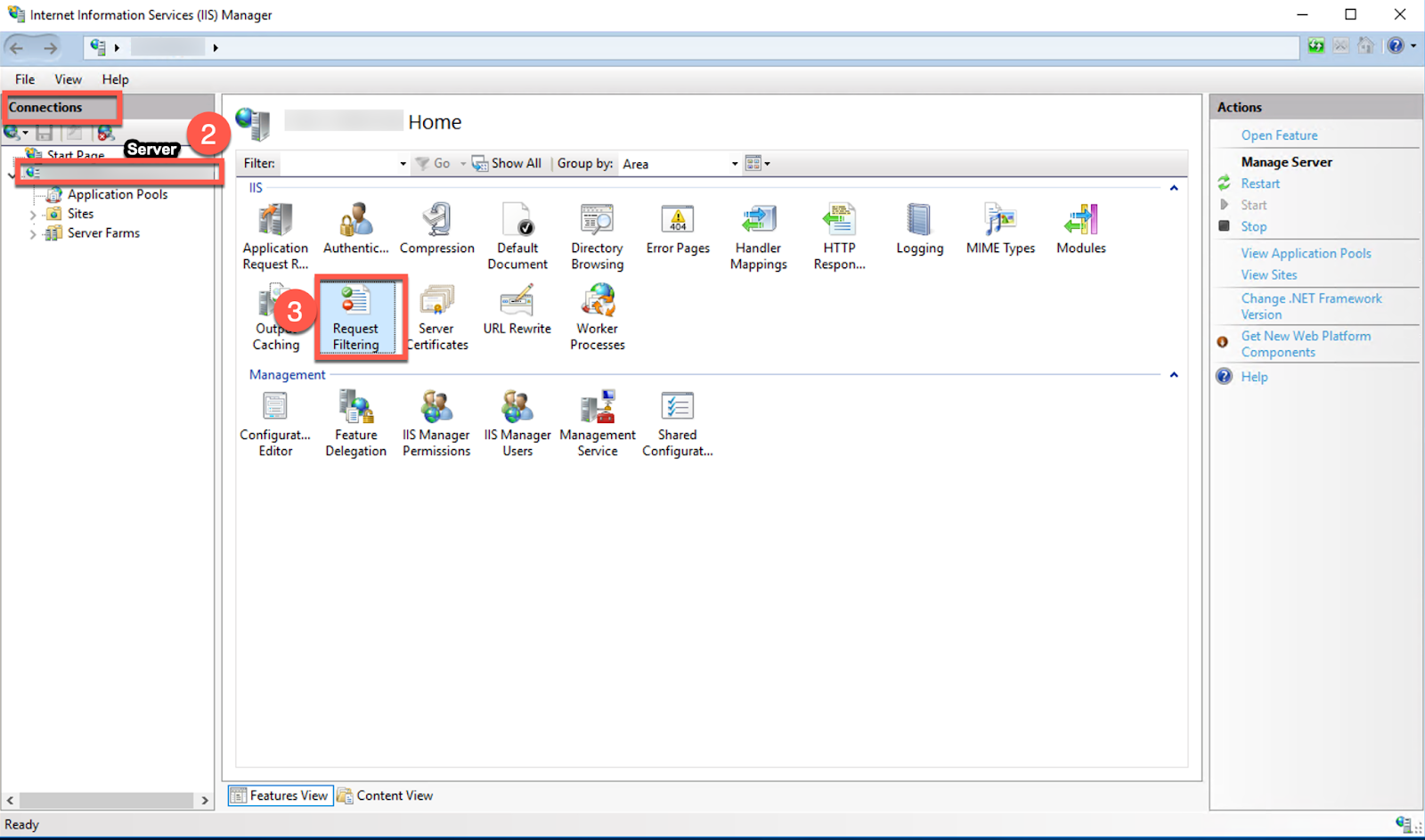

The maximum request size limit can be changed by modifying the setting in IIS Manager. This is done as follows:
  1. Connect to the server.
  3. Double-click ”Request filtering”.
  1. In the "Actions" pane, click "Edit Feature Settings..."
  2. Modify the "Maximum allowed content length" field to the desired maximum size in bytes.
